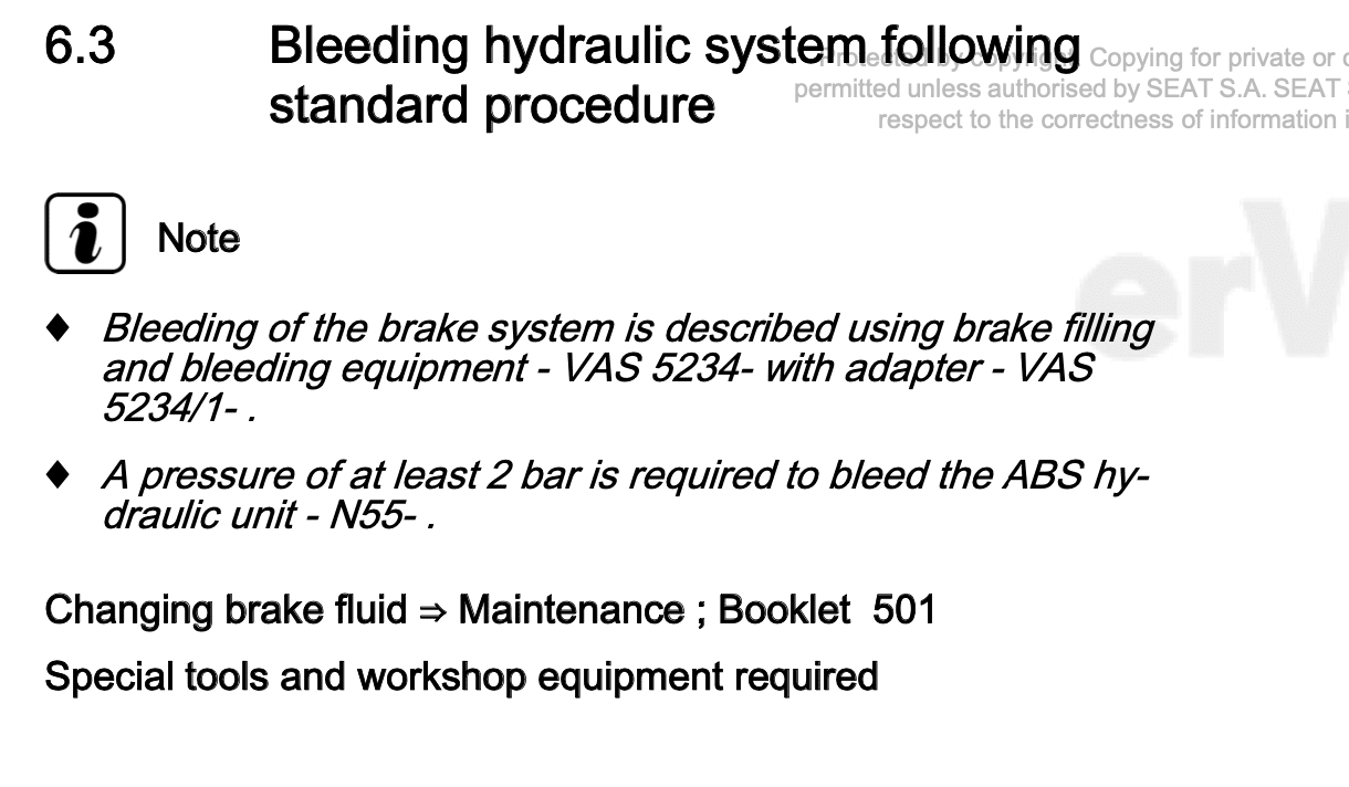

Haha I know, the device looks pretty serious and it works well. For newer cars, the procedure usually involves pressure bleeding it instead of the oldskool pump with your foot method (although it can still be effective!)
See below according to the workspace manual

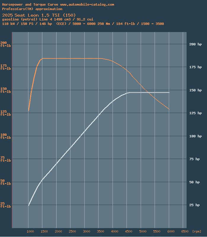

Just to add - If I am reading the graph correctly, your engine should be outputting its max 150hp between 4500-6000rpm.. so by staying under 3500rpm you're not using the engine's full potential.
