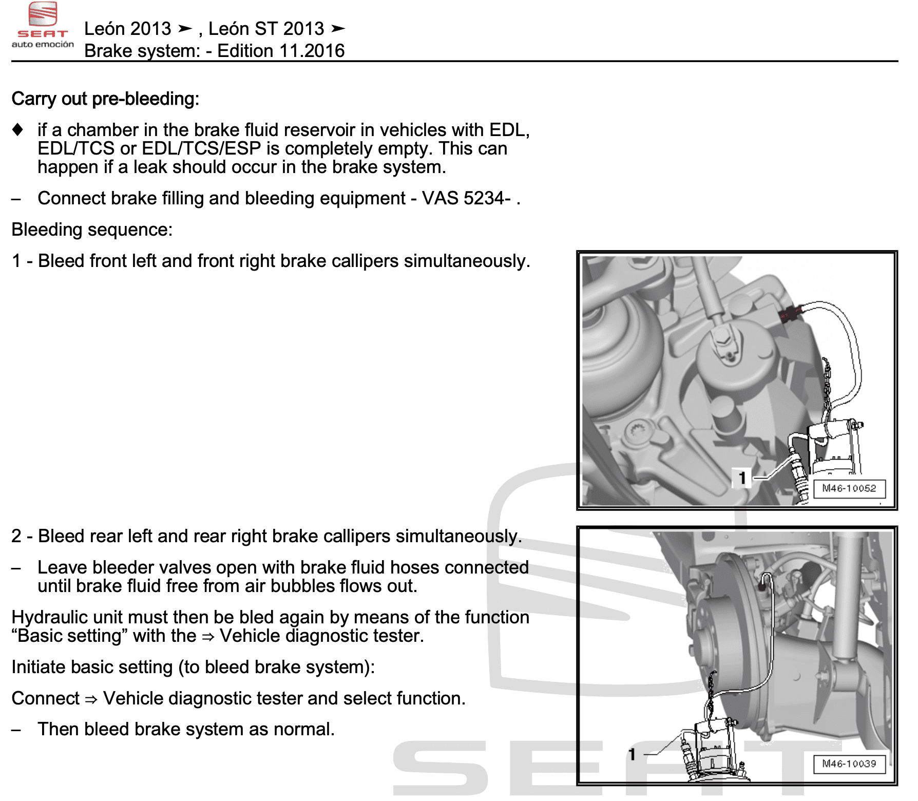

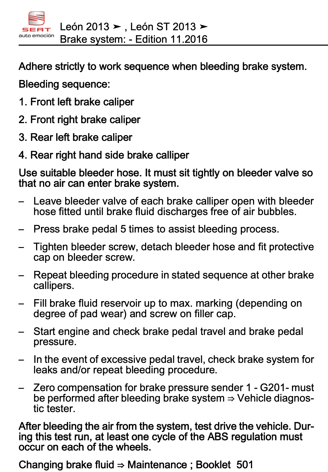

This is the sequence btw, so not the rear first (!)
Bleeding sequence:
1. Front left brake caliper
2. Front right brake caliper
3. Rear left brake caliper
4. Rear right hand side brake calliper

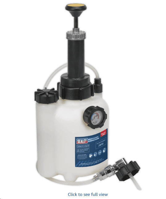

I've seen the basics of how: but was hoping it was similar to oil, ie undo a sump plug thing, drain / refill.. but more complicated involving a pressure tank.
Is this tank just used to force it through to substitute old for new, rather than to set the renewed fluid to some sort of optimal pressure once it's in?

I have done the brake fluid on my MK3 for the first time not too long ago, but I bought a pressure bleeder and I have built up quite some experience over the years. Without the pressure bleeder, I would not have done it. For me this is the correct way of doing brake fluid changes

I changed brake fluid a few weeks ago. I'd "practiced" 😉 on my wife's old Volvo V40 (new front calipers and pads all round) and also her Kia Sorento. Once you get your head round it, it's not too bad. I got a power bleeder to help pressurise the system it makes it a one man job (rather than the old school method of having someone pressing the brake pedal).
