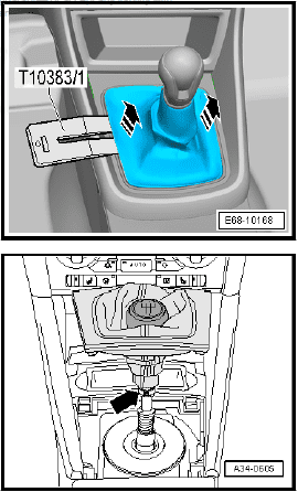

Well this is strange. Firstly, I know for certain that the rubber section under the gear knob (which hides the mech- all manual cars have this) hasn't been touched. IE the dealer hasn't lifted this section whatsoever. Which I -think- you have to do, to look at/ adjust the gear linkeage.
How do I know? Well I do carpentry in a workshop, & I remember being miffed I'd got a good sprinkling of fine wood dust on this rubber area. On my new car I said to myself. It was still there when I picked car up: no way it would still be, if this rubber was lifted up, or even faffed with.
Anyway. As the gear 1/R & 2/R "crosstalk" thing I experienced I seem to recall (this idea just suddenly occured to me after I picked car up from being 'fixed' yesterday) was --possibly-- on both occasions whilst my car was on a slight forward incline.. I decided to test this. So I found a deserted side road with a slight forward incline.
