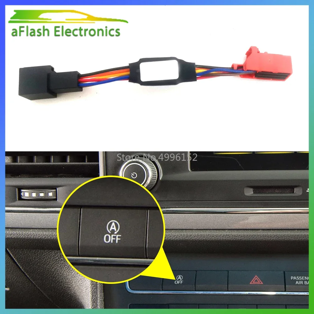

But personally I went for the stop start memory module which is easy to fit and remembers the last setting you used.
