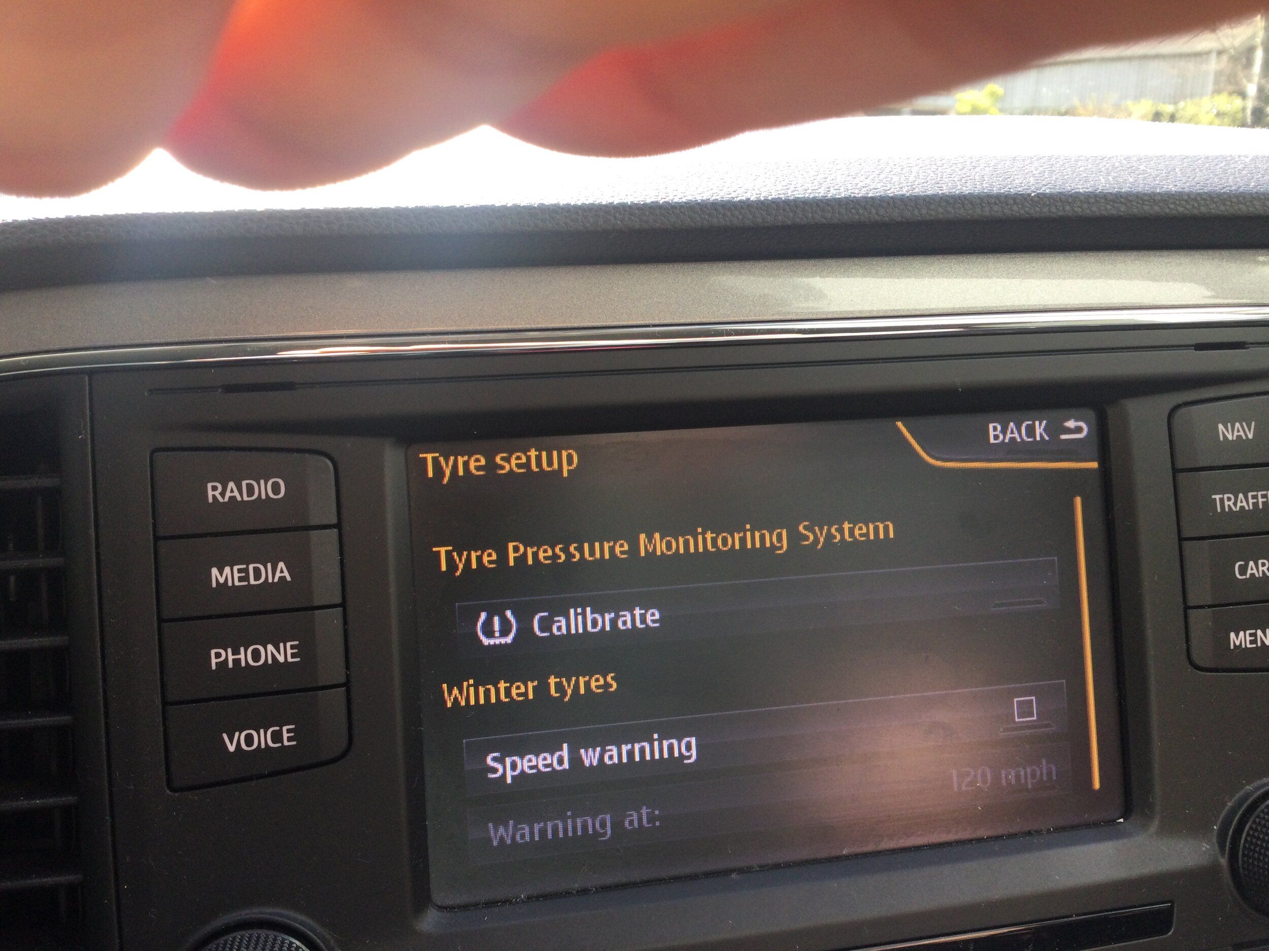

Hi again serdar..
Do you mean this screen? This is all I can find- never seen this section of the screen thing before. Im a bit nervous to press 'Calibrate' in case my whole car explodes..
No your car won't explode all it does is reset the tyre pressures in the cars memory so no more warning messages
Hi again serdar..
Yes, it's where you initialize the system to start taking notes of your current wheel rotation speed and later comparing it to actual data.
Even if you don't get any warning messages, you may want to check the tyre pressures from time to time, and correct them if you see any inflation/deflation (for example, as small as 1 or 2 psi of difference, which would not trigger the warning message). Whenever you do that, don't forget to hit that button and reinitialise the system.
