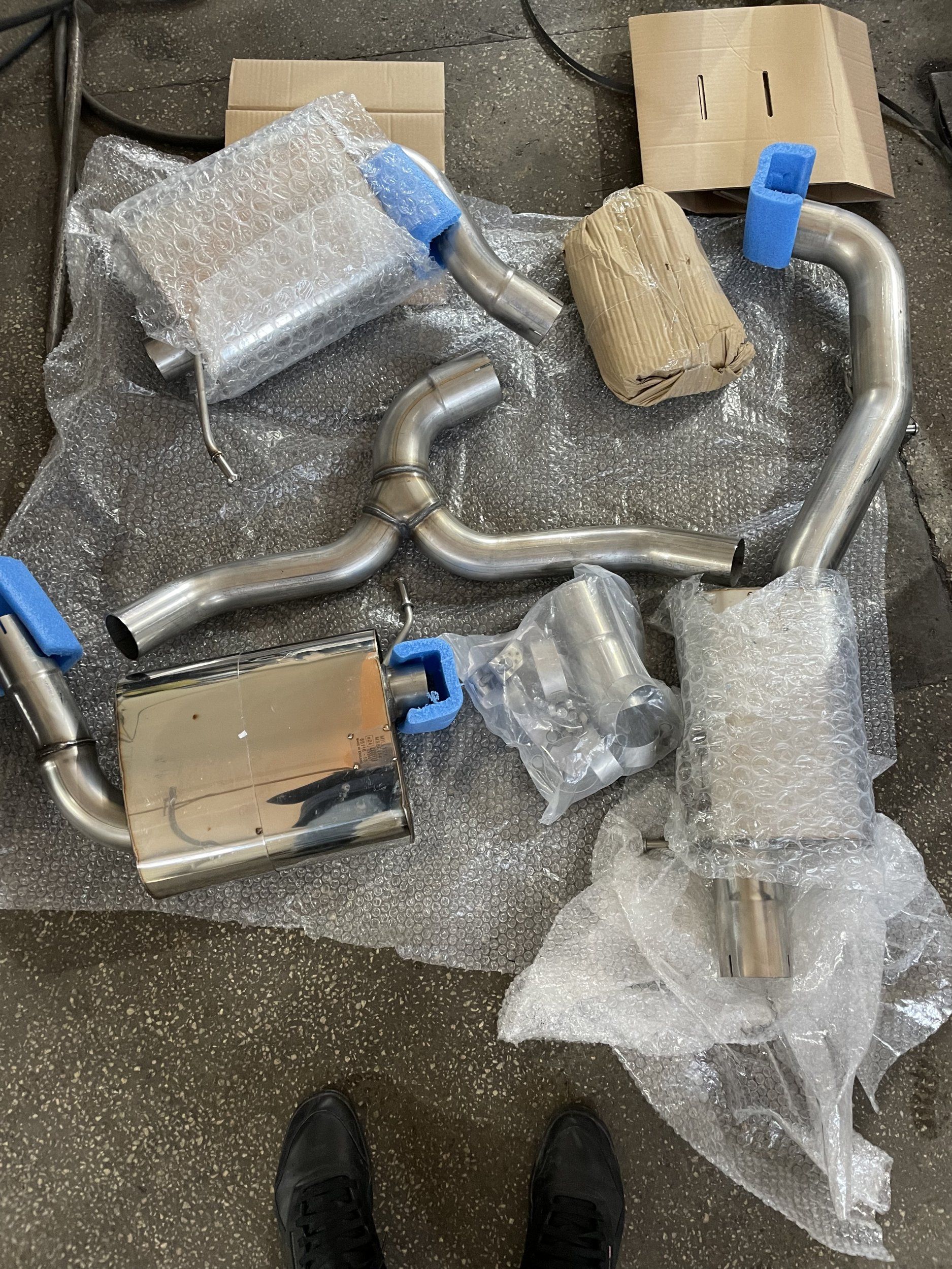

I found the exhaust at a German (keep in mind I live in Romania) online Shop called TurboPerformance. I ordered it in October and it took quite a while to arrive (January). Btw I totally recommend this shop, they did a very good job of keeping me in the loop while the order was delayed. The order arrived with FedEx and I had no trouble whatsoever. I took them to a local shop (about the end of January) to get it changed. At this point my excitement levels were through the roof, I could not wait another minute. Here's a pic of the parts.

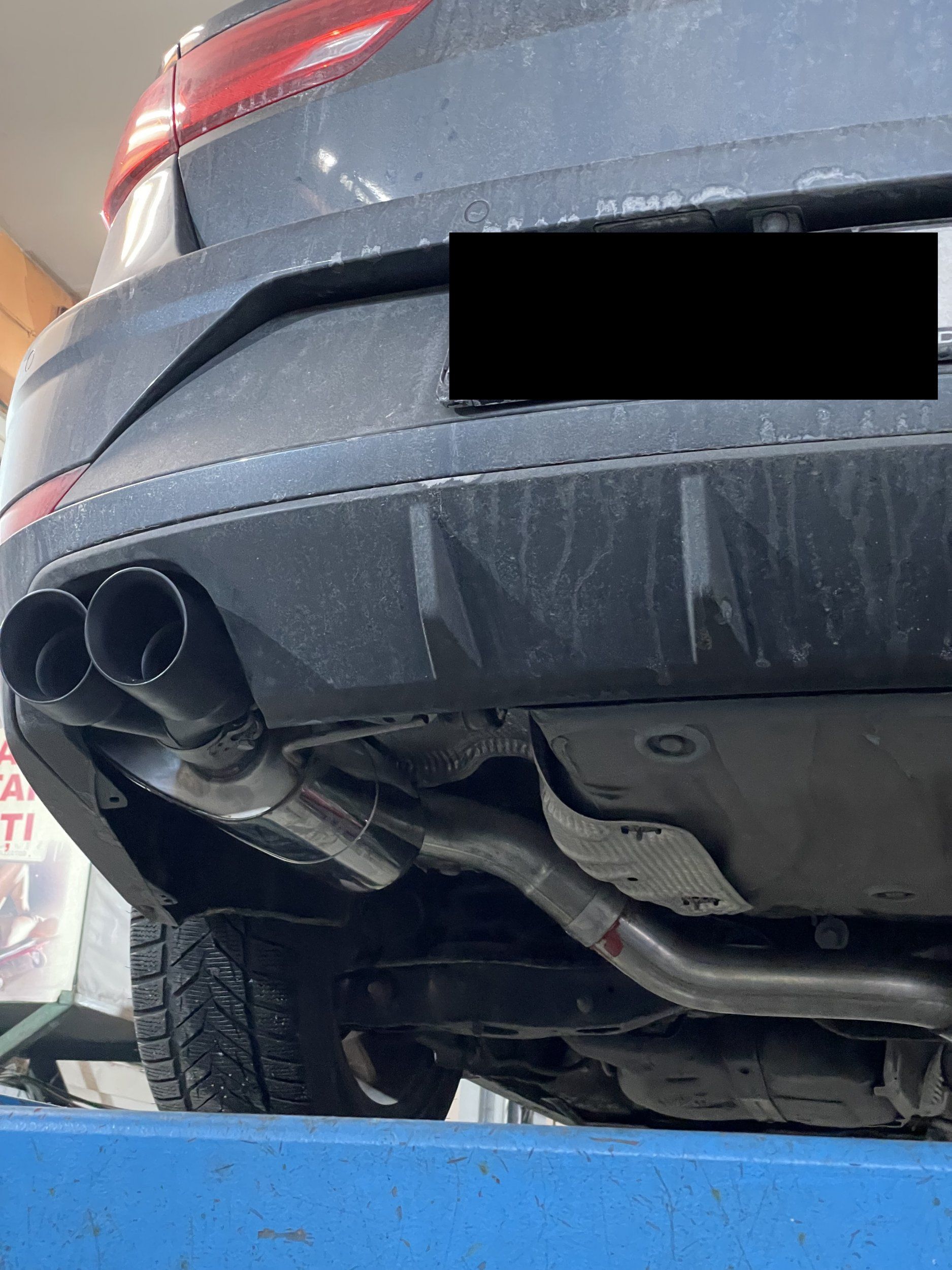

The job took about 2 hours. The guys seem to know what they were doing. It was almost a simple remove and replace apart from a couple of blockers. The old exhaust coupling had to be cut to be removed and one of the pipes from Milltek was a bit bent at the connection point (like 2mm).

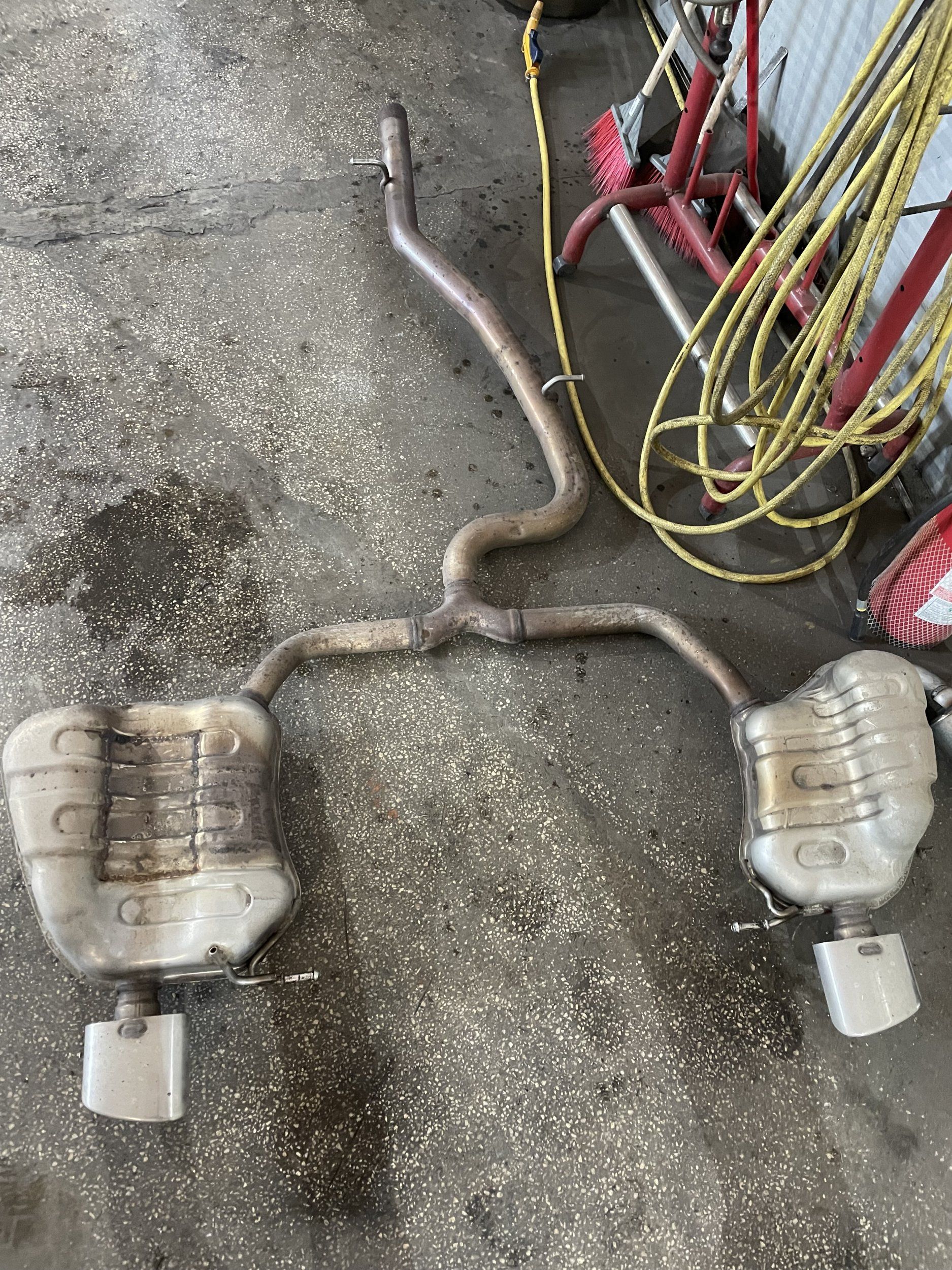

They took out the factory exhaust and... Surprise! It seemed to be cut into. I guess the previous owner wanted more sound and did this. But failed in his pursuit. Take a look and let me know what you think. So goodbye stock, welcome Milltek. (btw I still have the stock on, in the garage somewhere). And some finished shots of the exhaust.
