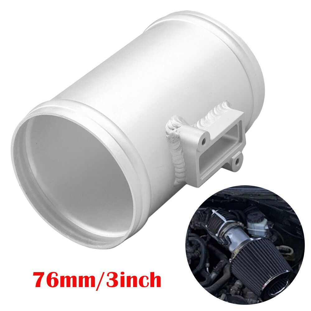

I've found a APR 5" open filter setup which is for a Polo GTI. On the website it says the polo gti has the EA888 Gen3.b engine (Same as the FR 190, does yours have the MAF sensor on top of the air intake pipe?). I have also found a 7" APR intake system and the seller has said it will fit the engine from the FR190 (MAF sensor on the air intake) but requires a MAF adapter.

Not sure I see the benefit of this pipe!
The intake will not be a restriction on the 190 - and having an open air filter in the engine bay will only suck hot air! Hot air is less dense than cold air = less power!

Agree with V8 - the 190 has the same airbox setup as the Cupra 310… so even at max remap (circa 260bhp for the 190), you’re nowhere near being restricted by the factory box.
You could do the pikey r600 mod if you wanted, but it’d make no difference
