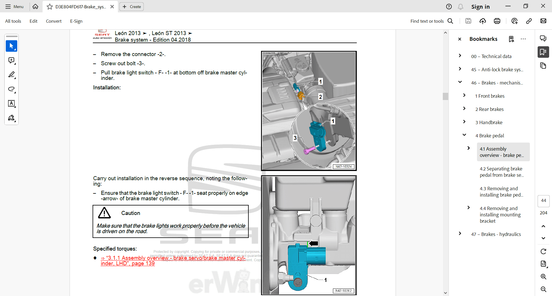

I would be tempted to have a look at the brake light switch at the pedal.
If there is a loose wire - it could be touching something to bring on the brake lights.
Modern cars also cut engine power when you go for the brake pedal.
Reactions: Seriously?
Seriously?
Apr 20, 2018
1,249
838
I've had trouble with VW group brake light switches failing internally in the past, but these were the pedal mounted switches. Does the 5F Leon have the brake light switch on the master cylinder?
You are correct - switch is attached to the master cyl
