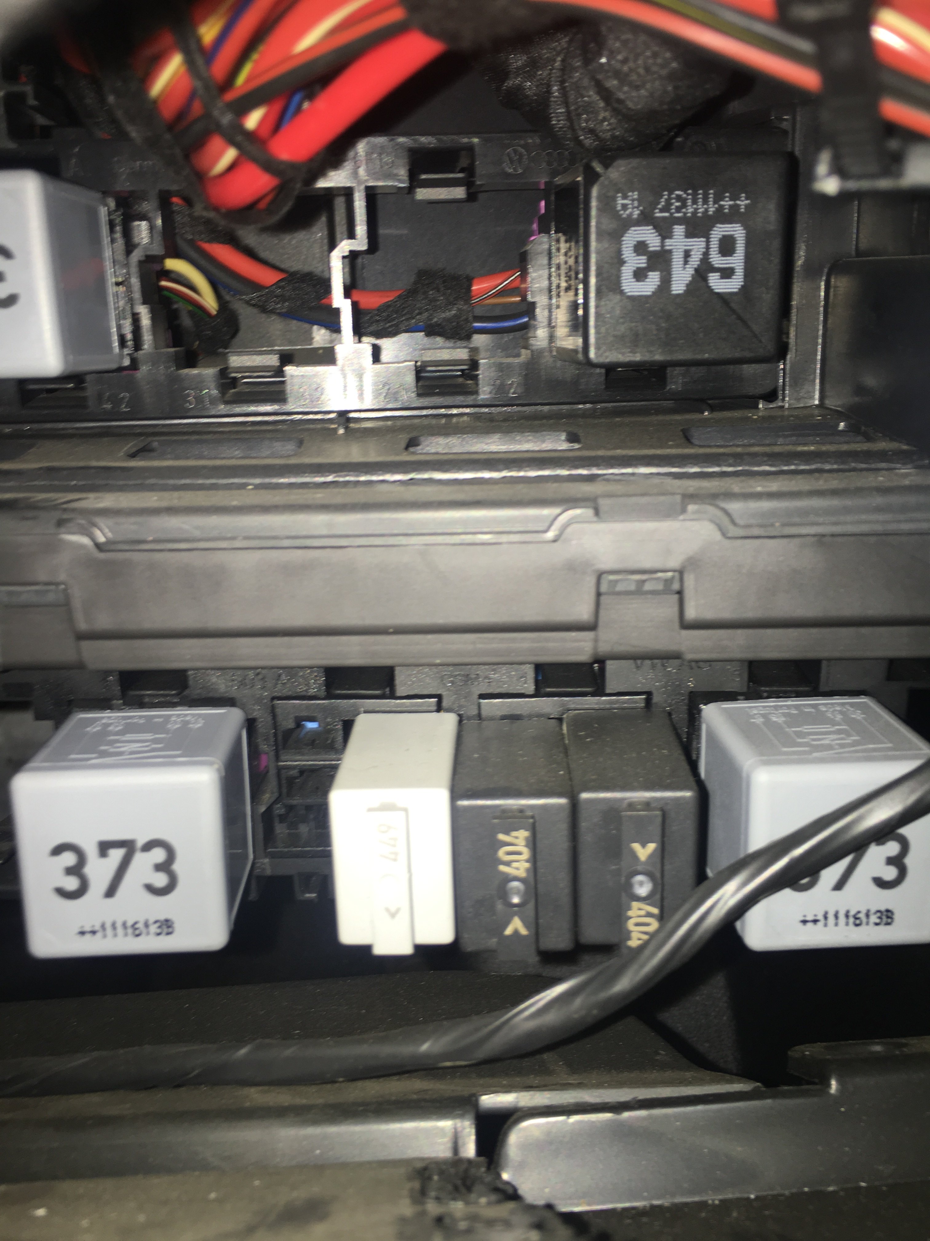

Hi all,
I know there are many posts but I can’t find anything to help me in my manual or online for this..
So basically my horn has stopped working, just out of no where. I have checked the fuse it’s not that, I opened up my relay box under steering wheel and I have no idea which is horn relay? I have attached a photo of my relays
I did try to swap around two of same number but no joy
Next job is to get bumper off and get both horns out to test power. I tried to access through fog light area but the bolts are tight/rusted I can’t get to them properly
Anyhow all help appreciated for this relay situation, I think it’s that as there is no clicking when pressing steering wheel

I've looked through the official workshop manuals but can't see anything relating to a relay for the horn :(
I know that's not much help, but there is instructions on how to get to the horn.

I know how to get to the horn, I can see it through fog light when I take out I just can’t get to it properly to get it off i will need to remove bumper to properly access both as it’s one on either side
Thing is manual gives everything on fuse but nothing on relays lol

Not sure if this help but in this article he did this
I read on line somewhere that the horn relay was a "type 646" and, as there are two of these in each fuse box I decided to pull them out and try them across a battery to see if they were working. They all clicked when powered up so I assumed they were OK. When we put them back in and tried the horn, the damn thing worked.
Read more: http://carmechanics.proboards.com/thread/5006/seat-leon-horn#ixzz5hoIIoCQl
Thanks
I don’t have a relay numbered 646 unfortunately, Something like this should be in the bloody manual lol

Well Iv found the relay for the horn is no.449
Changed it and still not working
Will attempt the bumper off and check horns this weekend but after that I’m stuck as it could then only be wiring somewhere
Not sure if it’s an electrician job or garage if all fails
