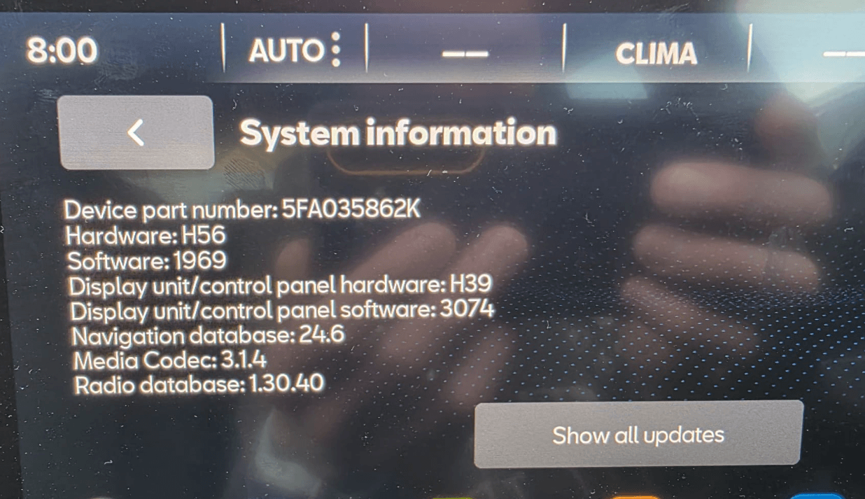

I've been trying to locate OCU version, granted I don't really understand where to start to find it but it seems my VIN code might be of use which is VSSZZZKLZNR004459
Also further details:
