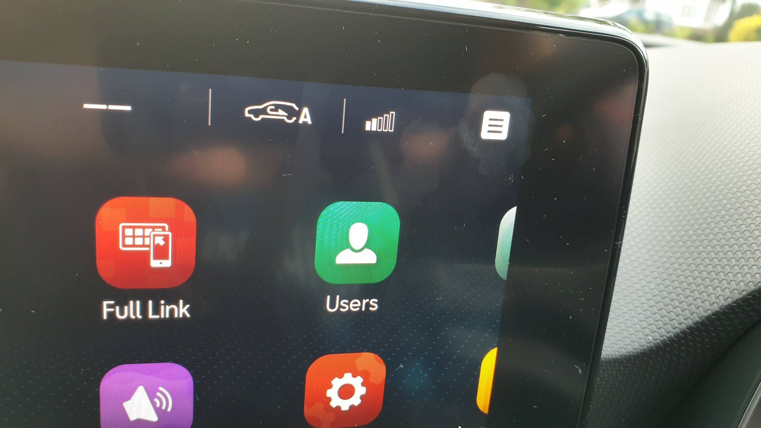

Hi All,
Update I noticed around this error. Whilst driving I started getting the clicking sound from the center speaker (like others have reported) before the SOS error shows up. I happened to notice that at that exact moment of the clicking the two symbols inbeween the mobile signal and notification symbol disappeard (see pic). They were there when I started my journey. This has happened a few times this weekend with the same pattern of events. Now this indicates a loss of connection to the outside world. I clicked on the icon to bring my profile and it was stuck in a circle saying connecting. For refference I was in a high coverage area. Soon as these symptoms started, I pulled over, did a soft reboot by holding down the power button on the infotainment display, and when it rebooted it came back with all 4 notifications present and connected back to the world and no further clicking. I had not moved an inch on the road during this experience so cannot blame cell coverage. I also use my phone as a mobile hotspot for data services and problem still persists if you use this method or the eSIM. I'm convinced there is a major bug here and the VAG group won't admit it because they need to do a recall which costs them money. It's not engine affecting so I think won't bother with it. Poor!
Would be good if others who get this issue can confirm if they see the icons suddenly disappear with a loss of connection to the world.

I thought my system was cured but today while driving electrical click-click sound is back and SOS system error visit workshop.
there are two scenarios for this
Failure Sequence 1
· Loud Electrical Click from the Centre Speaker
· "Error: Emergency Call. Please visit workshop error” on Instrument Cluster
· SOS Light goes off on roof
· Route guidance is not active message on Instrument Cluster
· Navigation is currently unavailable message on Instrument Cluster
Failure Sequence 2
· SOS call is now active message on Instrument Cluster
In both scenario loss connection to server (globe and user is gone)
I've seen both of them already, it's really annoying they don't know what to do with it. It is plenty discussion on VW forum about it also so it affecting all VAG car with the same series of issues.
Contacted SEAT UK about it too, but no answer there. Most useless service ever there!!
There is some recalls for Golf but nothing mentioned on SEAT!
