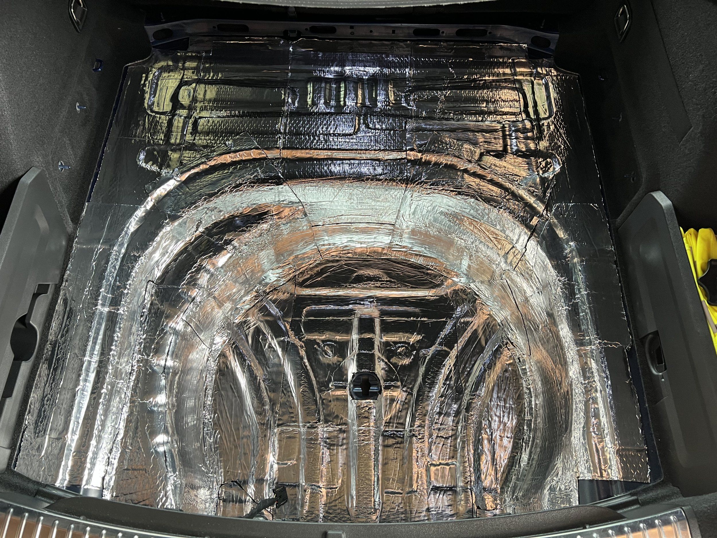

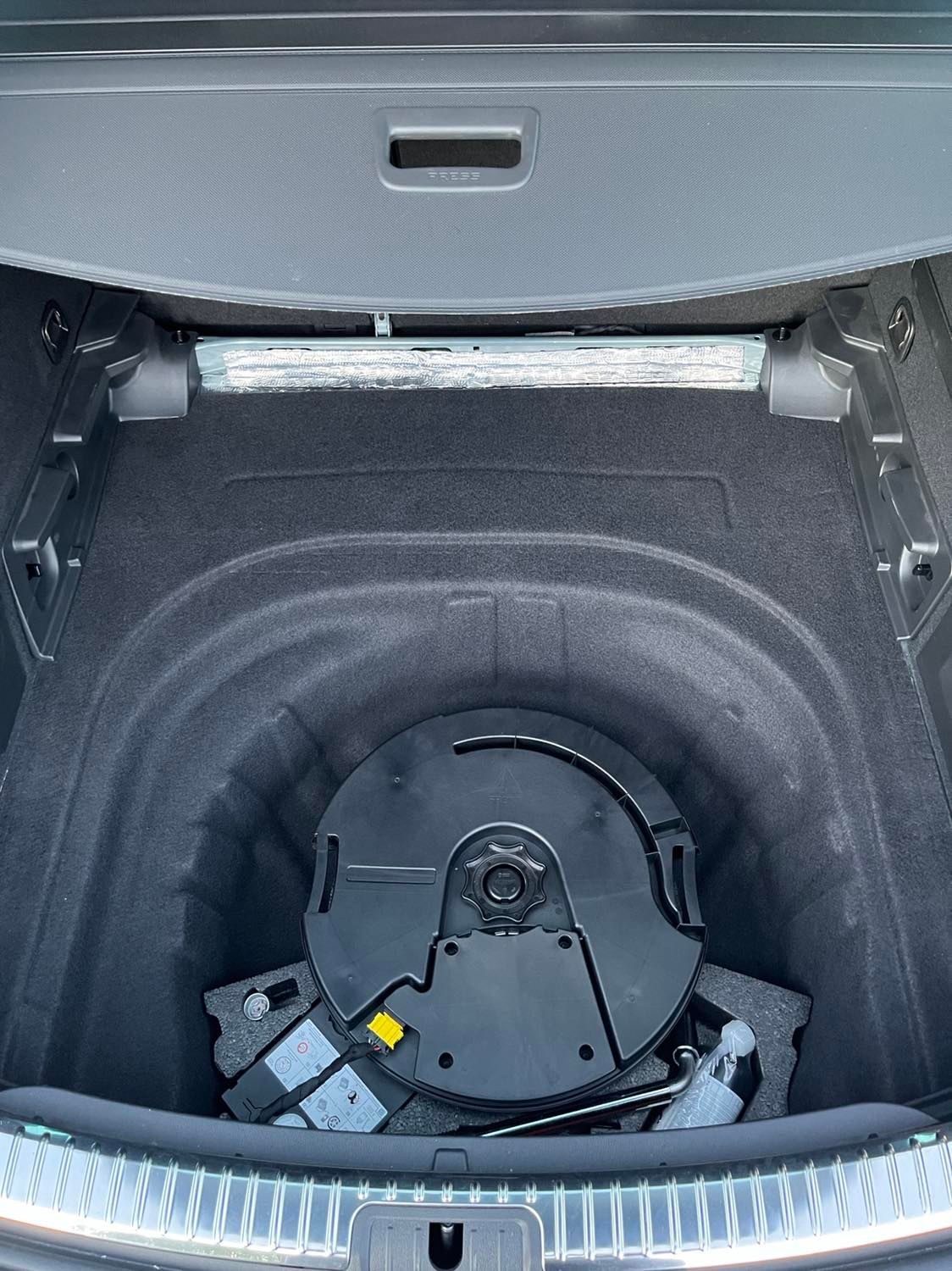

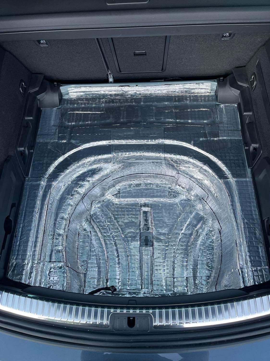

I thought I would share some pictures about sound deadening luggage and installing VW Golf floormat.

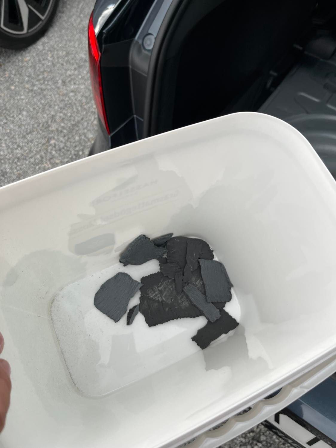

Before, sound deadening and the final result with the matt. The result: A more premium feeling and alot less sound from the road.

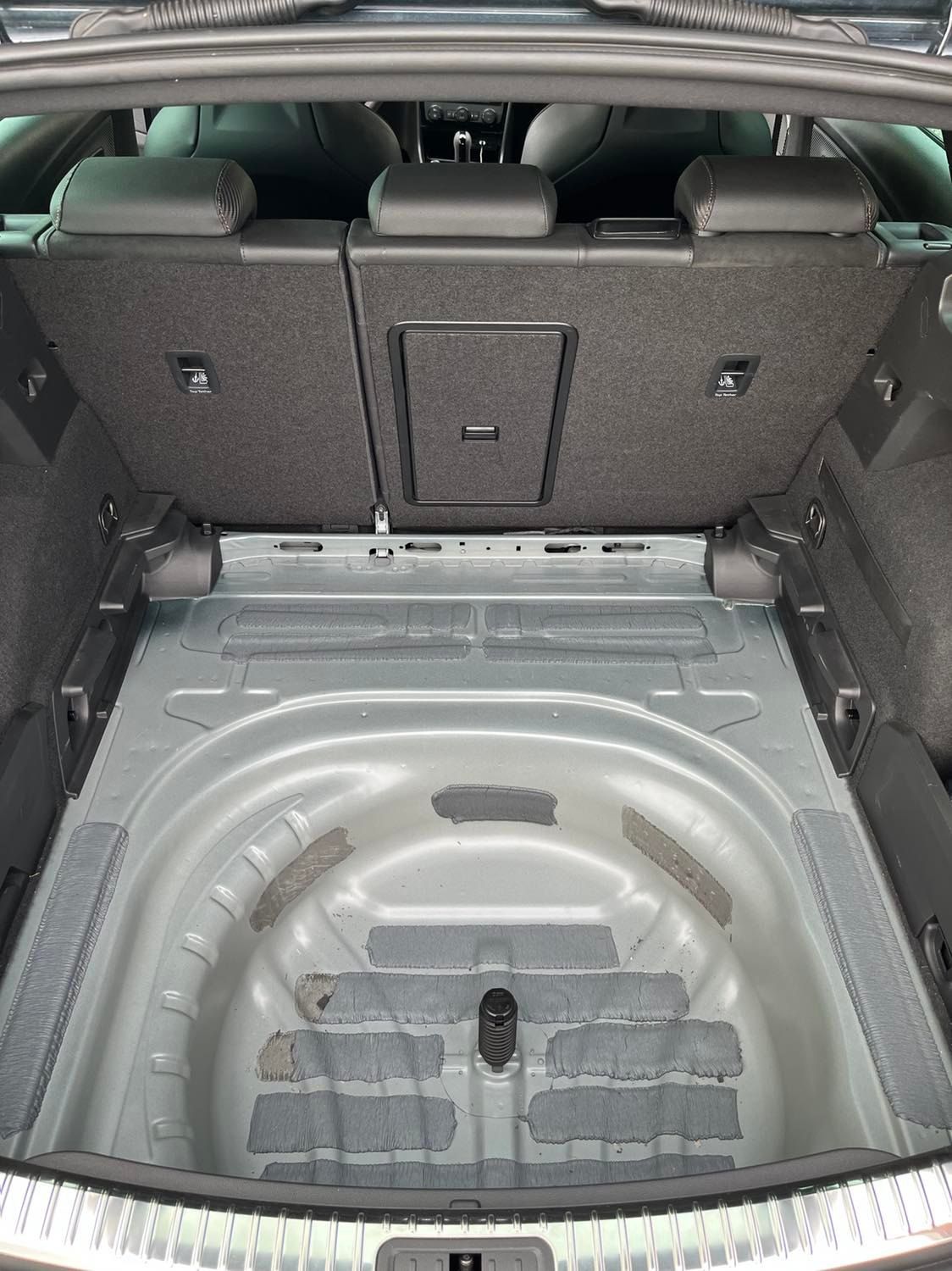

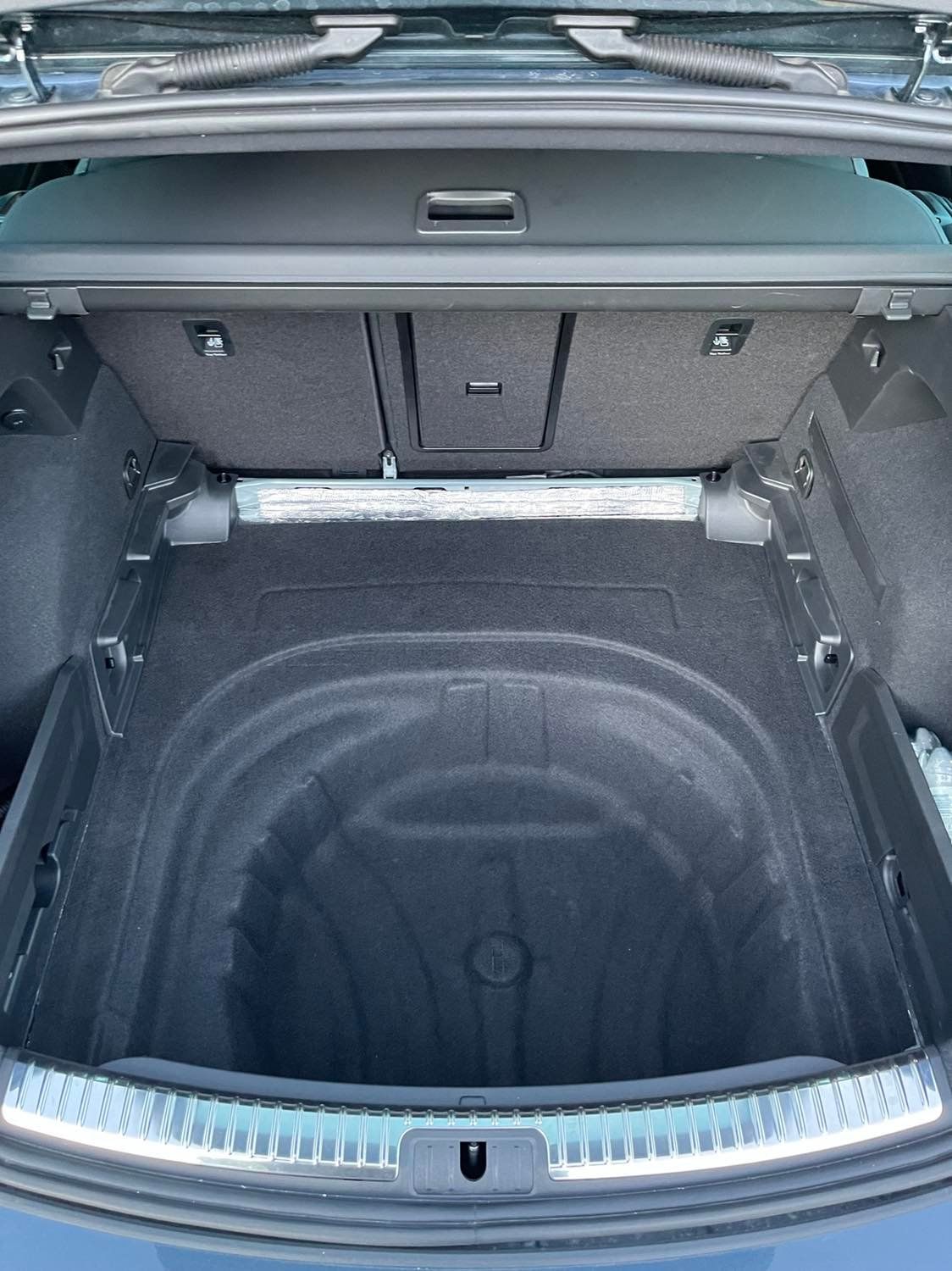

Before, almost no sound deadening.

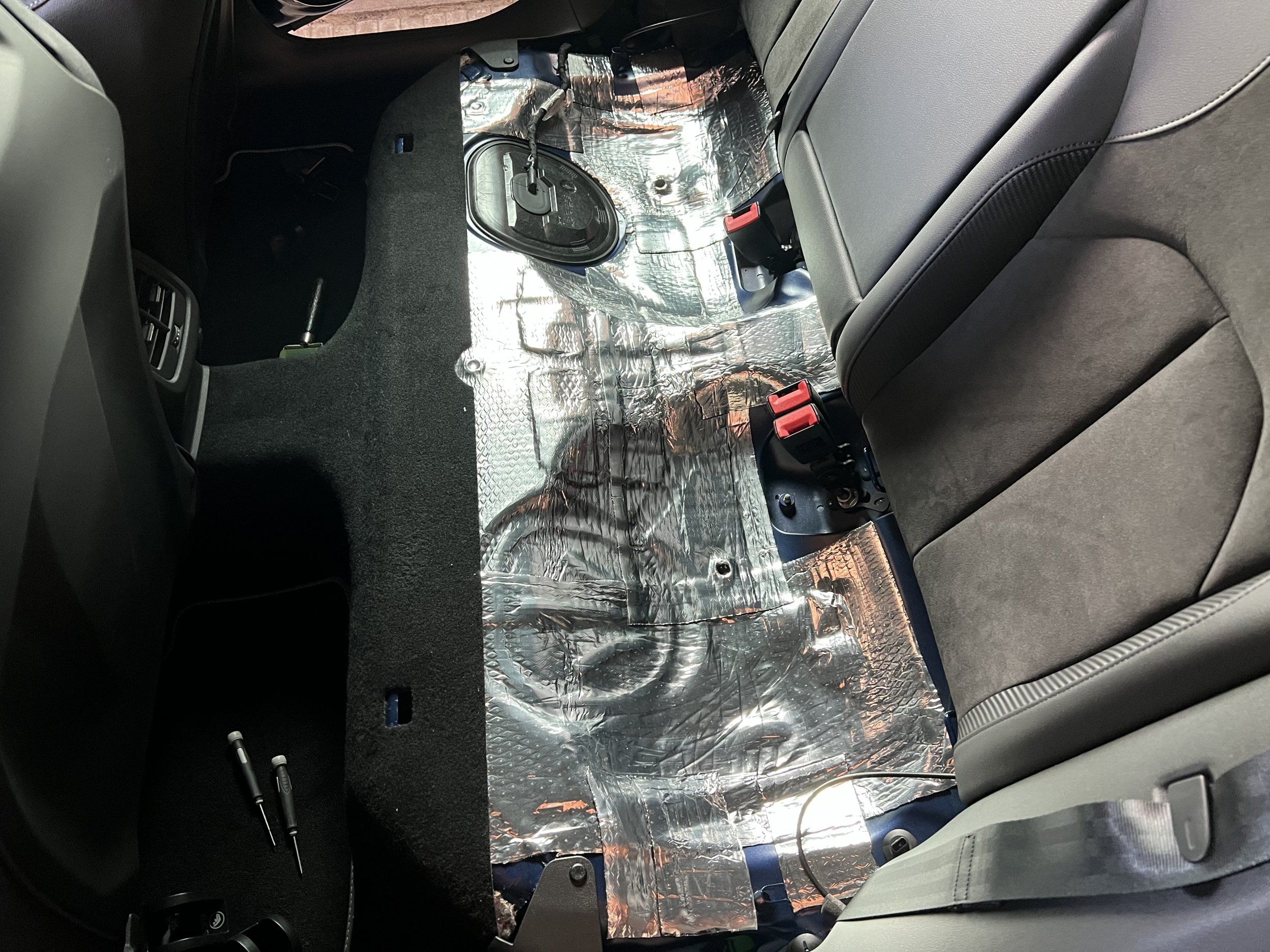

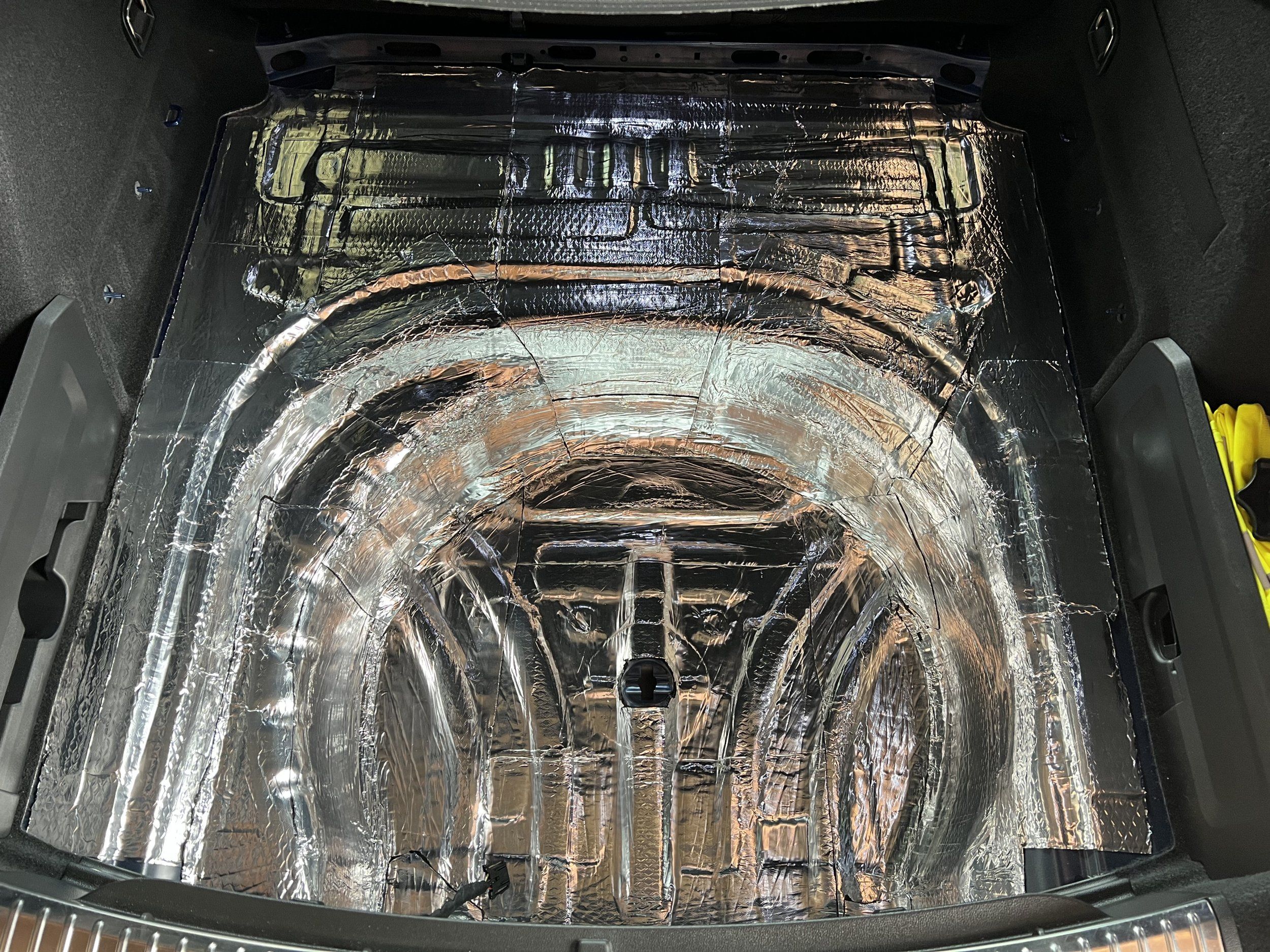

Deadening mats installed. 2mm silentcoat.
VW Golf SC floormat installed. Artnumber: 5G9863544B CA9
Final result :)
Looks good. Does the Golf floor liner help with sound deadening, or would the stock liner suffice? Where did you get the deadening mats from?
Yes the Golf floorliner helps a bit ofc, there is nothing but bare metal stock :( The deadening mats are from a local caraudio shop.
Looks really good, mine didn't even look close to that. Respect for your tidiness
I did all mine last year and the part that reduced the noise the most was under the arch trim. I used one layer of the rubber sound deadening and a thin layer of foam.
I'd also recommend if you haven't already, doing doors. Silentcoat and then some dense acoustic foam for directly behind the speakers, adds a good amount of bass after.
Reactions: Wossy1
Nice and clean looking! I am tempted to do so on my 280 ST too, just wondering if any trims need to be removed doing the boot?
Do it! :) Just need to remove the front plastic pieces, sits with 3 plastic screws to get the matt. To do the sound deadening mats you need to remove the factory "deadening".

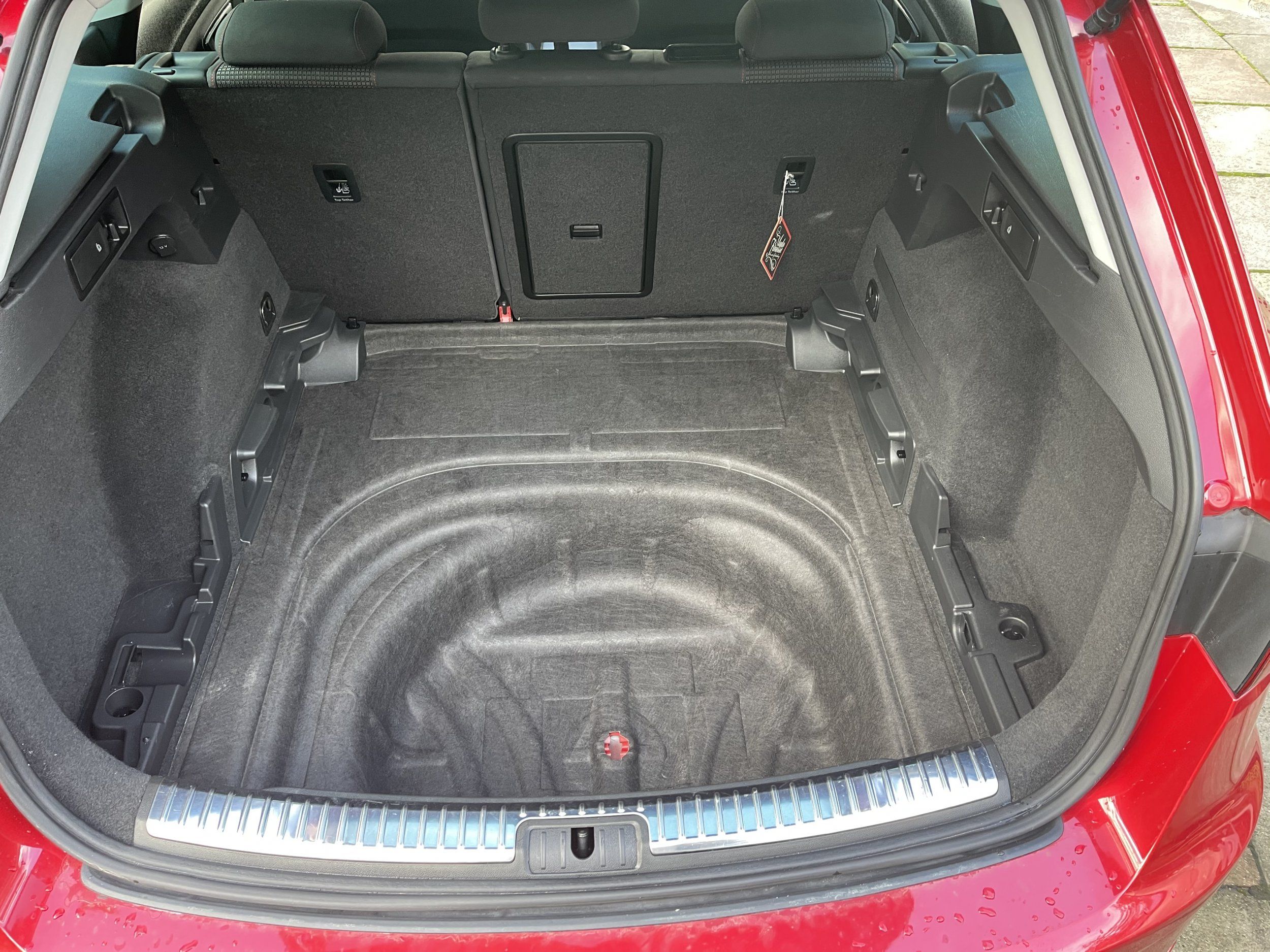

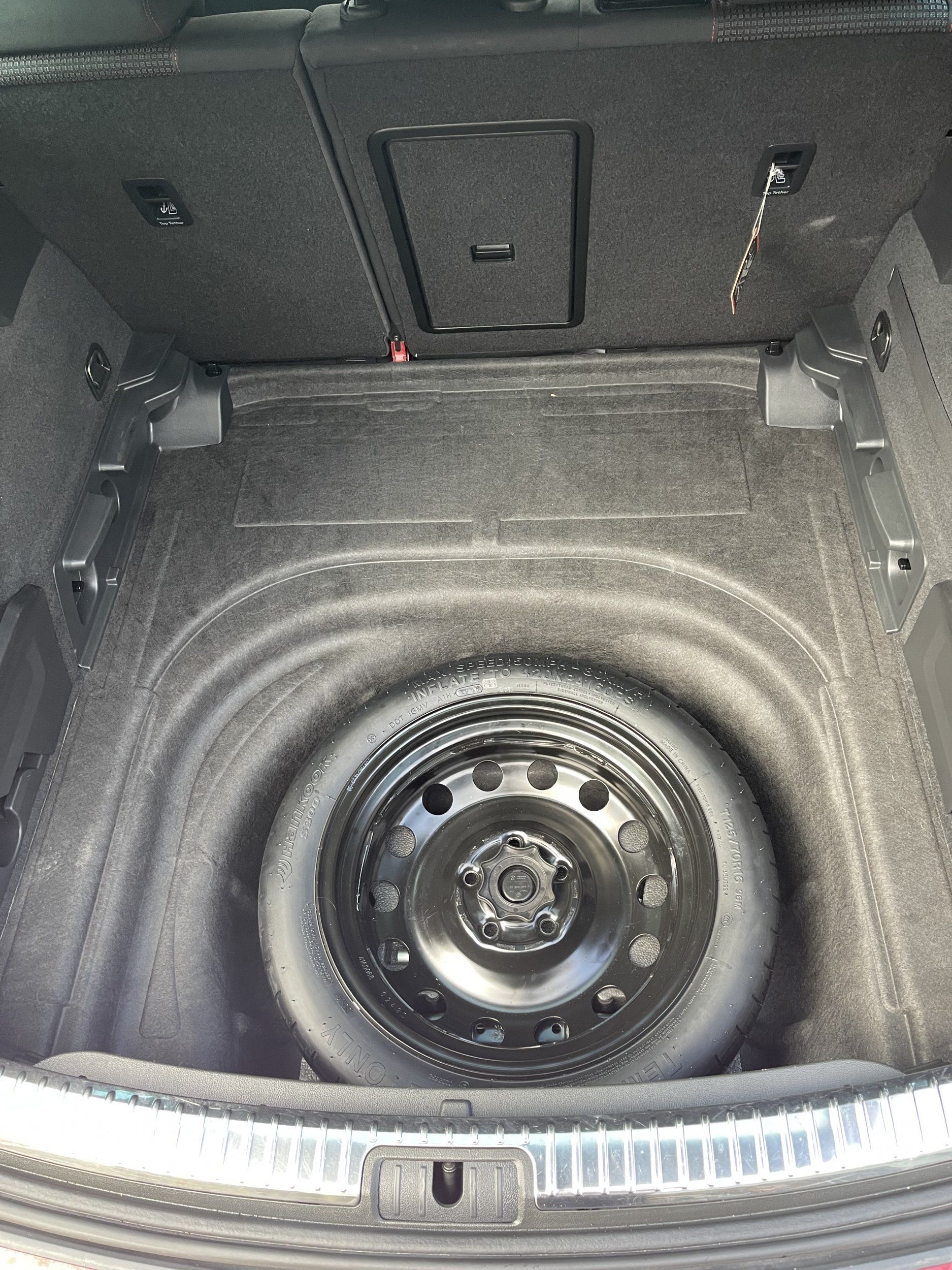

After seeing @vippens post I had to jump on the bandwagon…! I wasn’t too interested in the sound deadening qualities, I just think it completes the boot floor and makes it look more ‘finished’. I managed to bide my time and grab a genuine SEAT carpet. Not in perfect condition, but it’s a boot carpet after all…! Nice little OEM+ touch I guess. Thanks @Vippen for the idea.

It's strange that my ST FR 2016MY had the boot like that from factory.
Mine too - 2015MY.
Cost saving!
You can't always assume a new model is better than the old model i'm afraid! manufactures are always looking at ways of removing cost from cars - and hoping no-one/few people notice or even care!
Reactions: Walone
That's right. The pre-facelift ST came with carpet liner in the boot and they dropped it for the face-lift. Also dropped the trim piece over the metal cross-bar under the back seats, the direct access buttons on the touch screen and a few other things I can't remember. The face-lift is all cost cutting, nothing is better than the older car.
Do you know what the part number is for the SEAT boot carpet please?
Have tried a local breakers a few times to get a Golf one and always say don't have it.
Thanks?
Thanks?

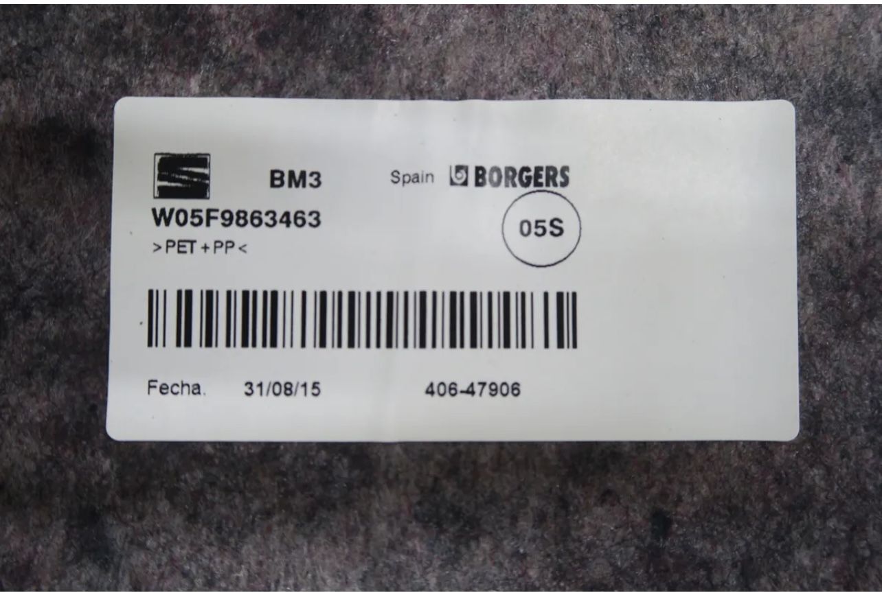

This was the barcode off the seat one I managed to get off eBay. As someone mentioned in the thread, in earlier cars this was apparently standard (which I didn’t know) so may get lucky if you ping a few emails to eBay breakers.
