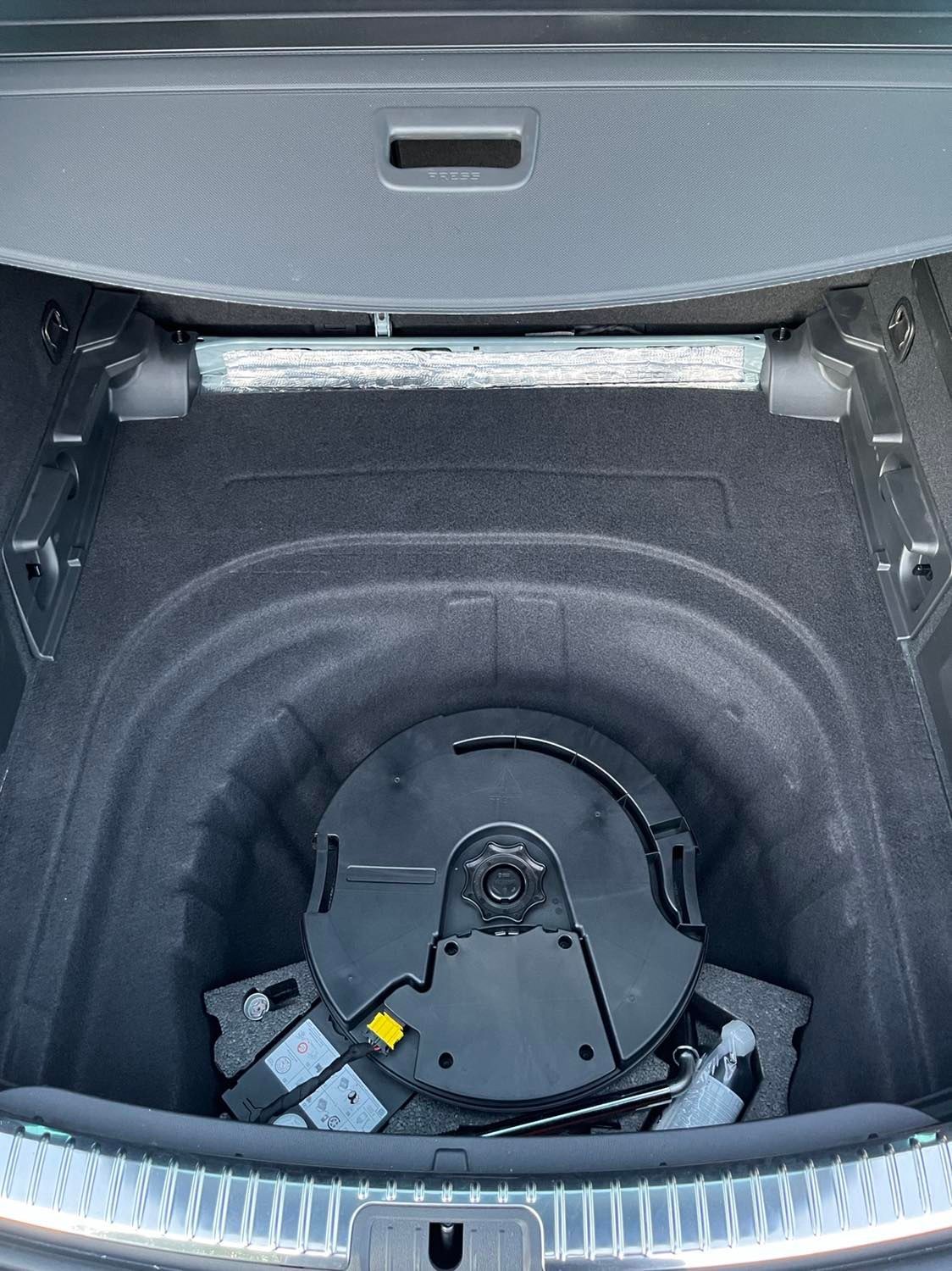

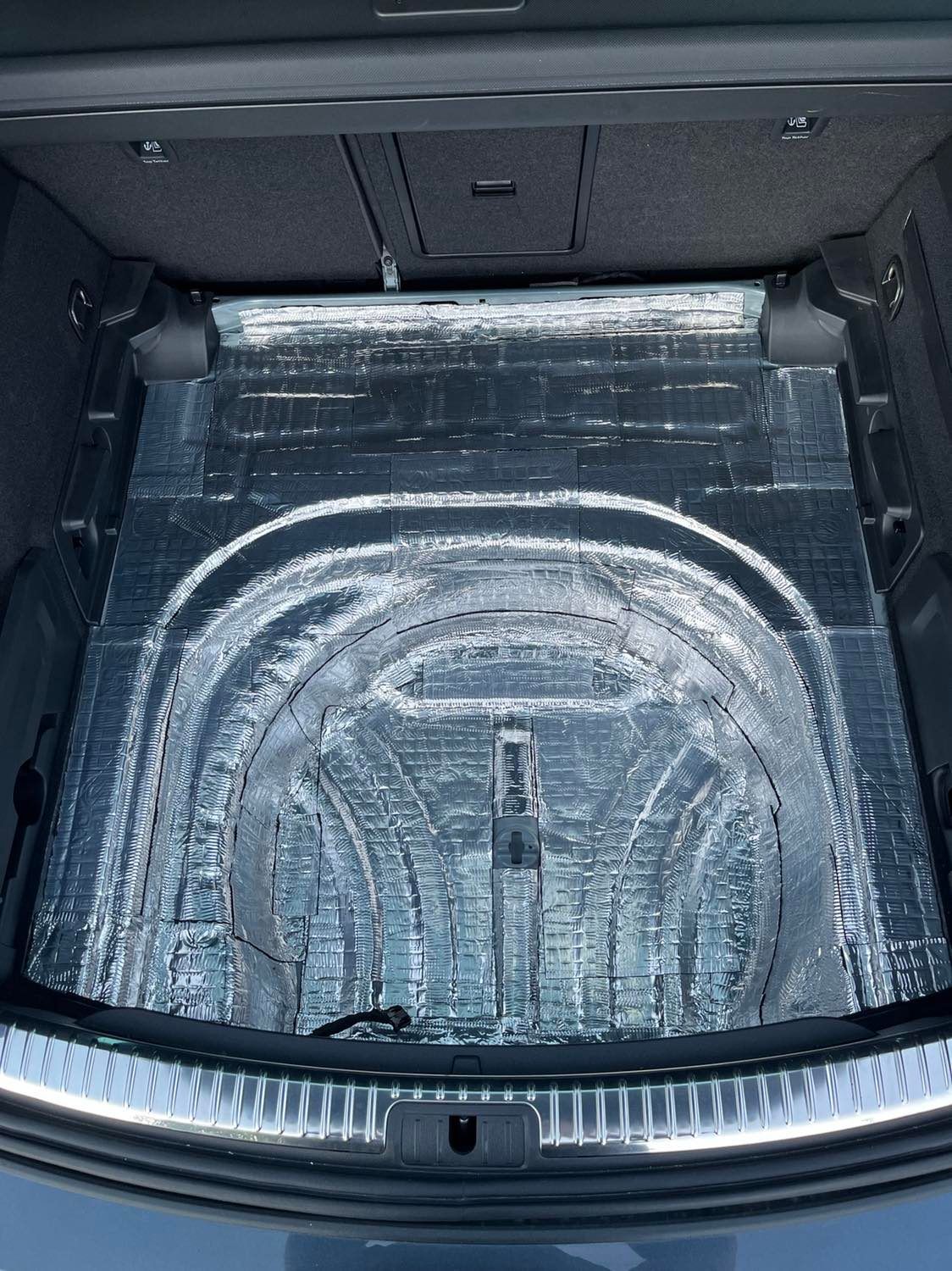

Hello!
I thought I would share some pictures about sound deadening luggage and installing VW Golf floormat.
Before, sound deadening and the final result with the matt. The result: A more premium feeling and alot less sound from the road.

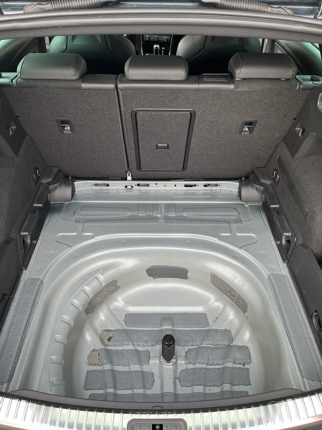

Before, almost no sound deadening.

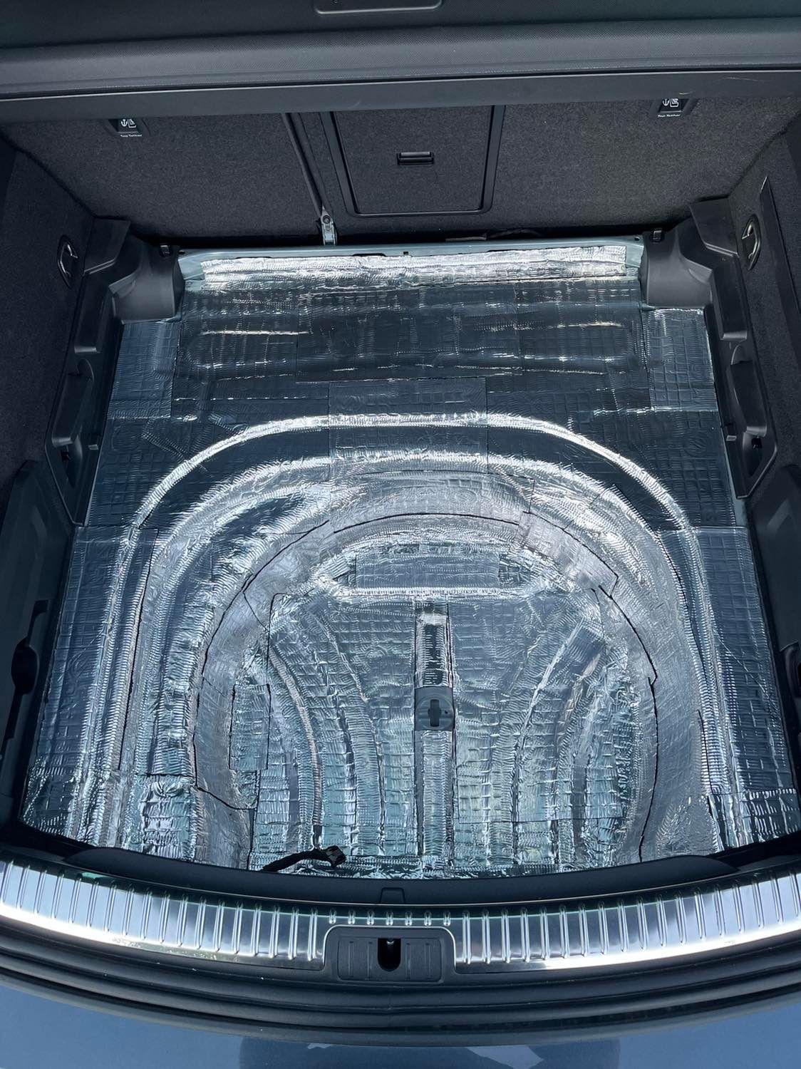

Deadening mats installed. 2mm silentcoat.

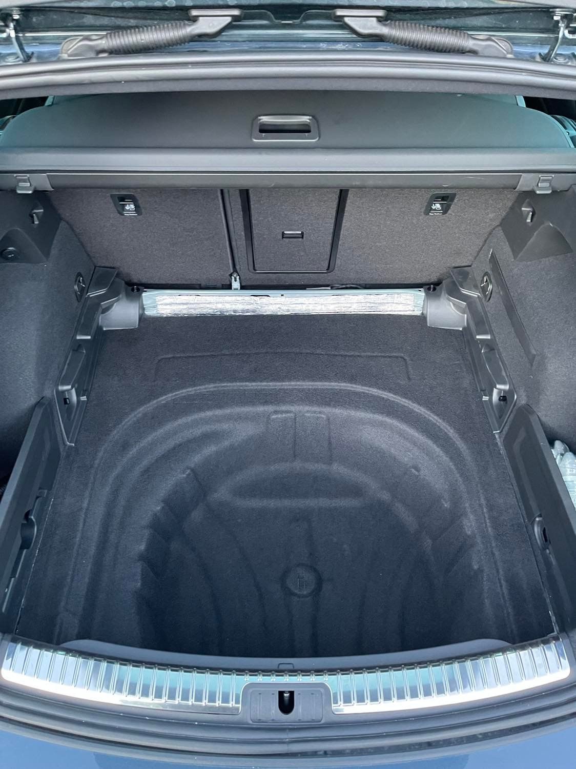

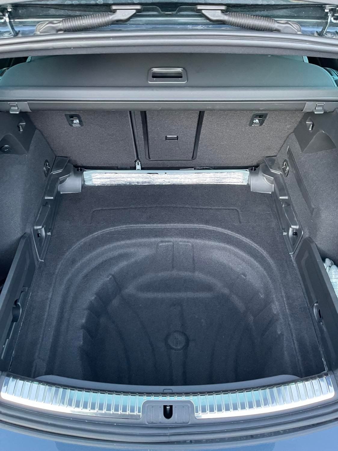

VW Golf SC floormat installed. Artnumber: 5G9863544B CA9
Final result :)

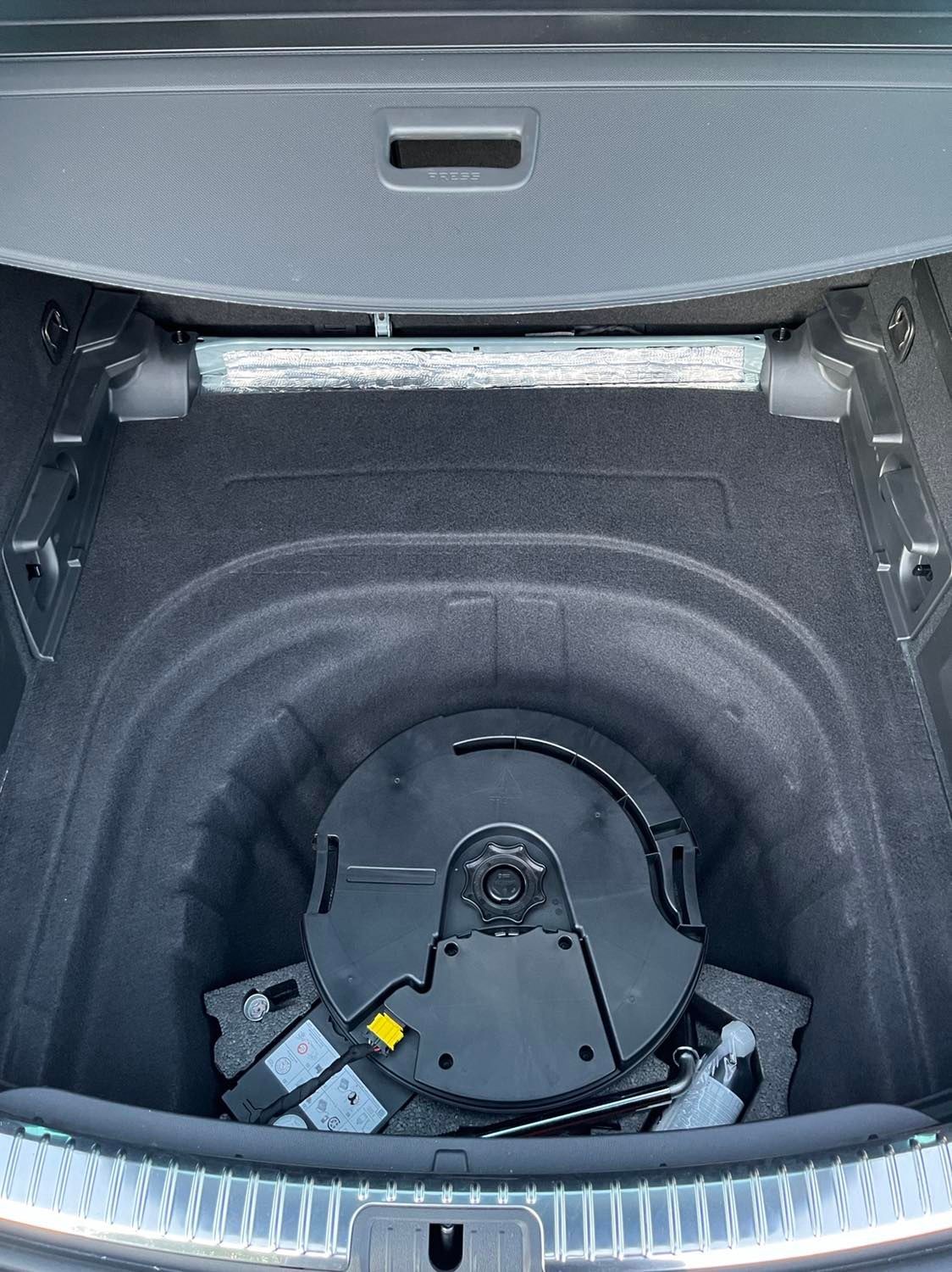

@LeylandVCDS this is the golf estate floor cover, fits tidy actually!

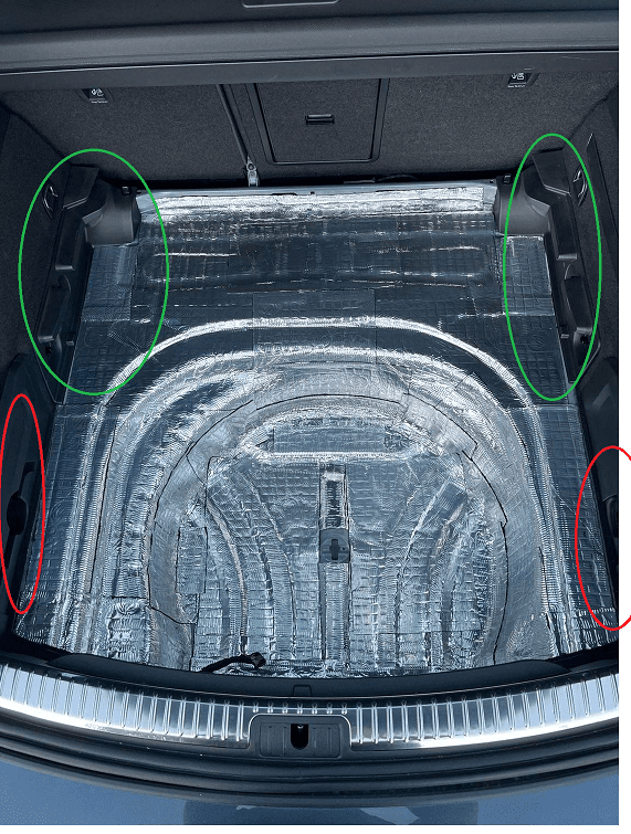

@SuperV8 Hiya mate, sorry to jump on an old post. I have ordered 5F9863463, I intend on fitting it later, do you know if any trim will need removing, I intend on removing the boot lip protector, to start, do you know if the panels on the left and right hand side have to come off too? any pre install info would help a bunch!
No idea, it wasn't me who added this trim.
No worries mate, I've managed to get the bits circled green off just need to figure out how to get off the lower part of the side pocket walls (don't know how you'd describe it but I think you get what I mean hopefully.)
In order to lay the carpet properly, everything must be removed.
Thanks for the info Cairus, I've done what I think is 80% of it, do you know how you remove the parts in red, I've removed some of it, it is the bottom piece of the assembly I am struggling with at the moment.
@BradleyH After you remove the plastic nut, it pulls right out (with some force). It latches into the carpet bits with protruding bits (cant describe it better lol)
Totally know what you are saying mate, I have just fitted mine, with a mate and some man handling we managed to do it without removing it, one person just needs a good grip on the carpet and some force whilst the other one stuffs the rest of the carpet under neatly. The seat version part number 5F9863463 covers the bare metal in the middle near the back seats like with the original posters golf version (not throwing any shade his way I still like what he has done)
