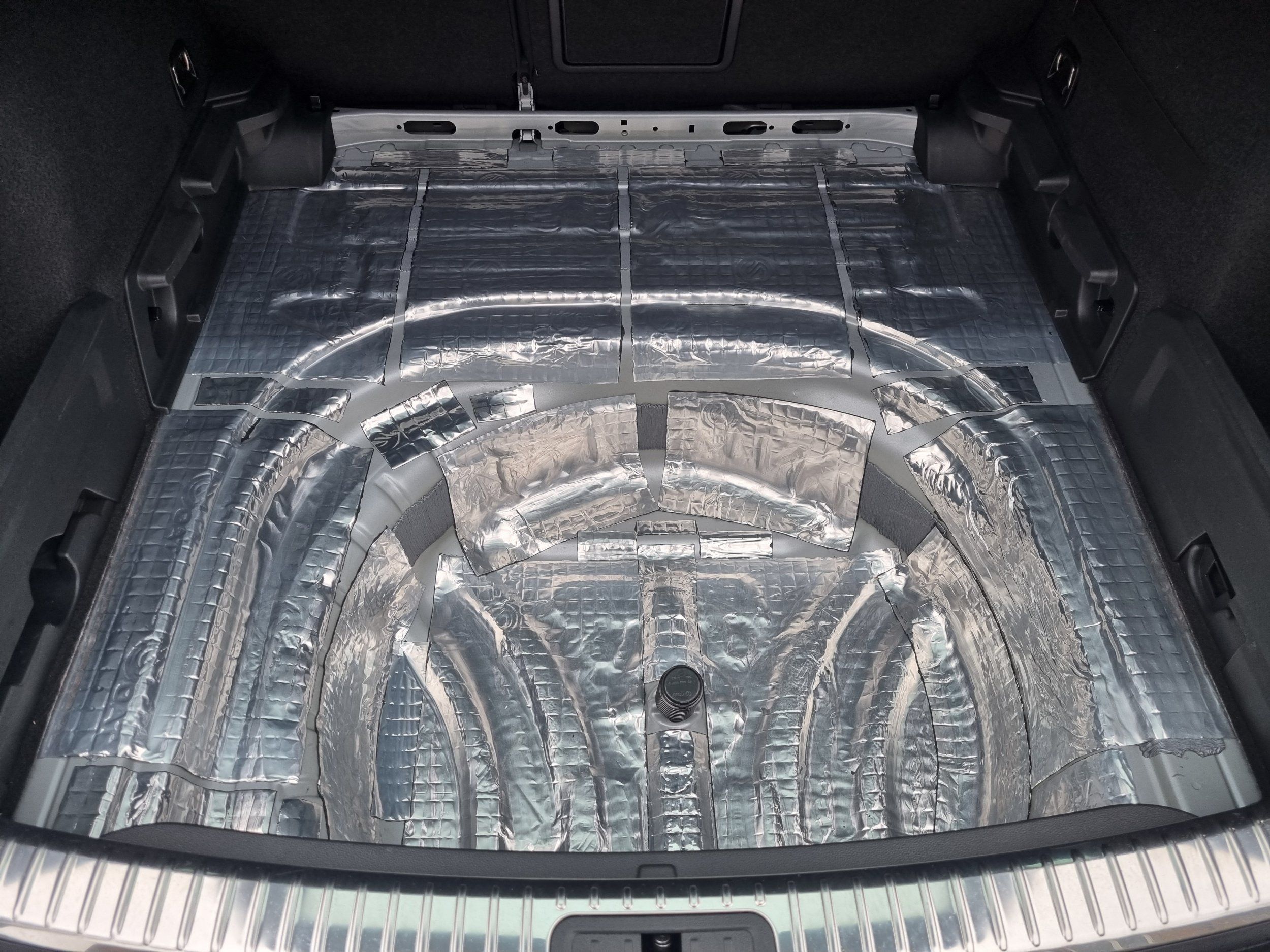

For anyone who has fitted sound deadening - did you bother to remove any trims or carpets to fit it underneath them? Or just fitted to the bare metal that is visible?
I removed the rear seats, all the plastic trim in the boot, the trim around the seat belts and all carpets I could access. Just be mindful of where to apply the deadening as it could be where the trim clips into the body
apologies for what might be a daft question , but the first picture of the boot , without any floor mats , did it come out like that from the factory ?
Only the boot or did you also do the back-seat and wheel arches?
For the rear of the car I only did what you can see in the photo.
I also put some acoustic foam on the back of the front door cards. I bought it from a UK based company called Dodo ?, they were cheaper than Silentcoat and their products seem to be virtually identical.
