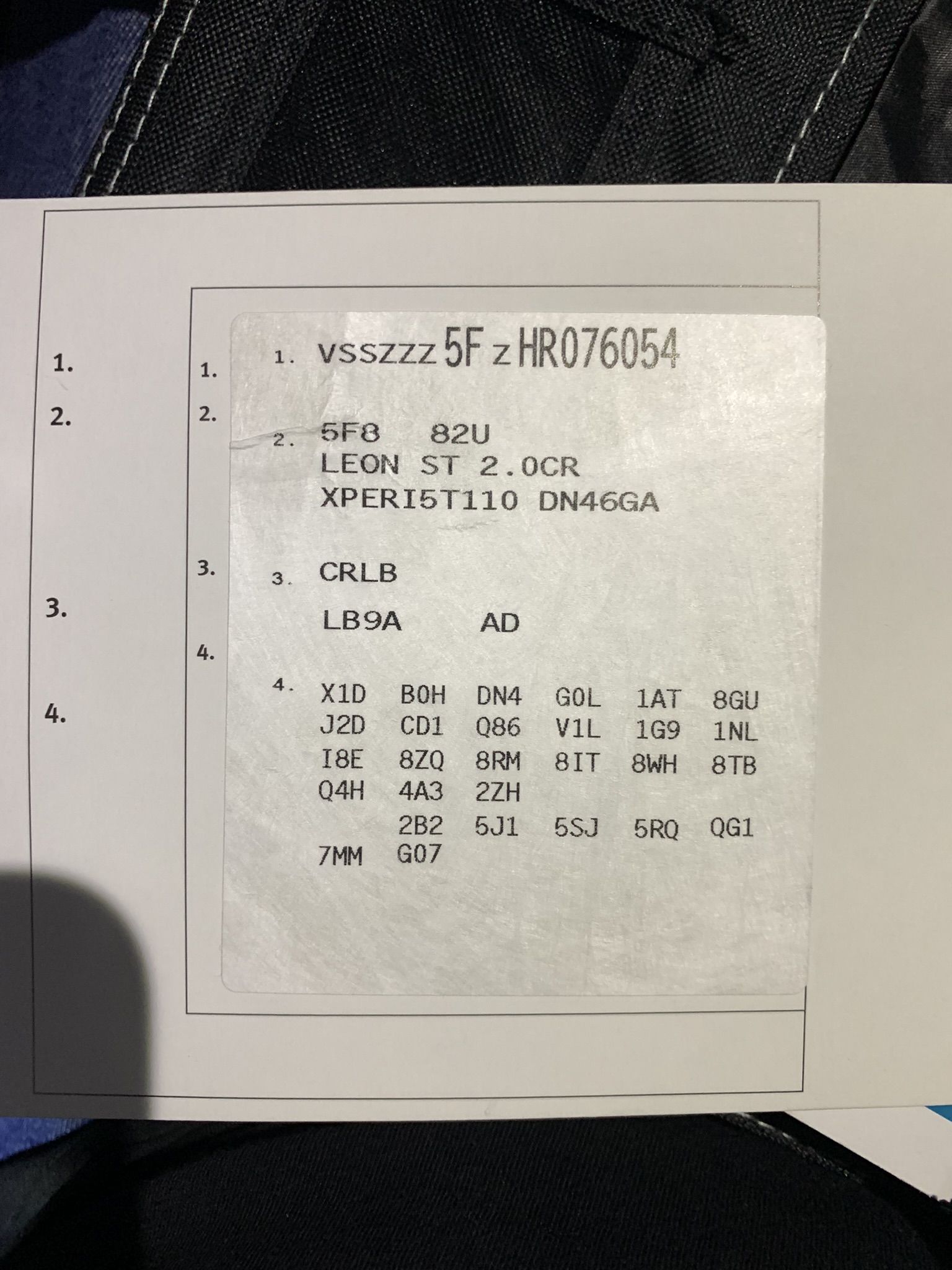

I am a happy owner of a 2017 Seat Leon X-pericence 2.0 TDI 110KW/150PS. I have some vibrations when braking and I do not think that the discs or pads has been changed on this car. So - it´s time to do that now. I checked my build spec to find the PR code to find out wich size rotors and pads I should order. Strange thing is that PR code for brakes is non existing on this car.
Does any one know how to find out without removing the wheels and measure? I´d like to do the job myself but a bit of a back problem is stopping me from removing the wheels and measuring the discs at the moment...

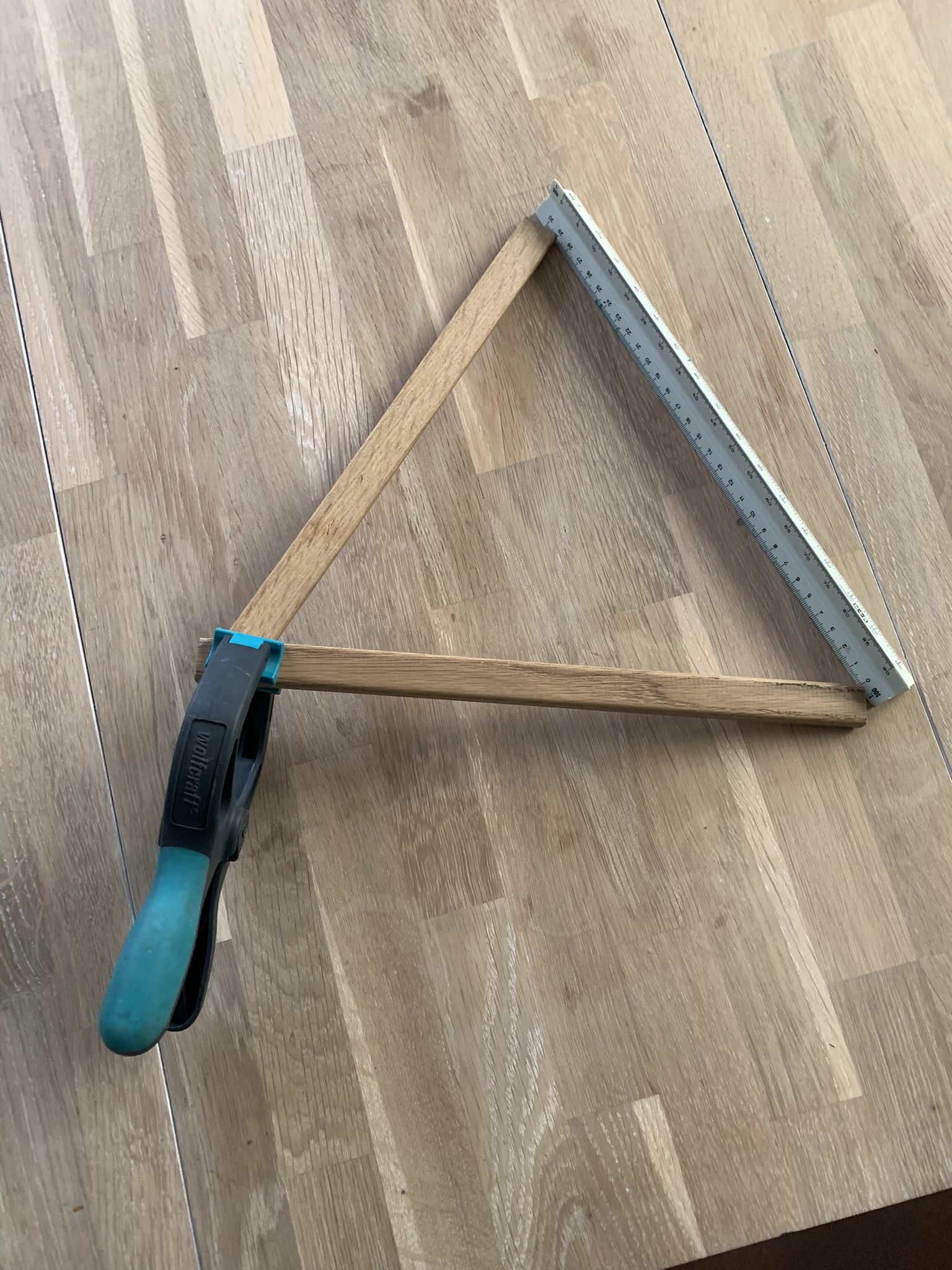

Ok. I made a simple contraption to measure the disc without taking the wheel off. Works if you have alloys on. Seems like the rear discs are 272mm and the fronts are 288mm.
