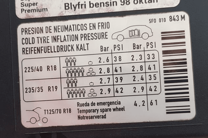

The label on my 280 quotes 2.6 bar (F) and 2.3 bar (R) for 225/40 R18 tyres with the car lightly loaded.
With the car heavily loaded, the equivalent figures are 2.8 bar front and rear.
All these figures are 0.1 bar lower than the recommended pressures for 235/35 R19 tyres.
Reactions: RUM4MO

Thank you very much for that!
Well, that 2019 SEAT Leon Cupra has just come back from its first service, work done "oil and filter change and tyres set to correct level", it still has its 18" winter tyres on and was returned with the TPMS alerting for low pressure and all 4 tyres set at 31PSI, which should make it very comfortable on the road and drop its MPG a bit, so I was called in to sort that out. Normally it would have its 19" summer wheels and tyres on, but this year, not yet!

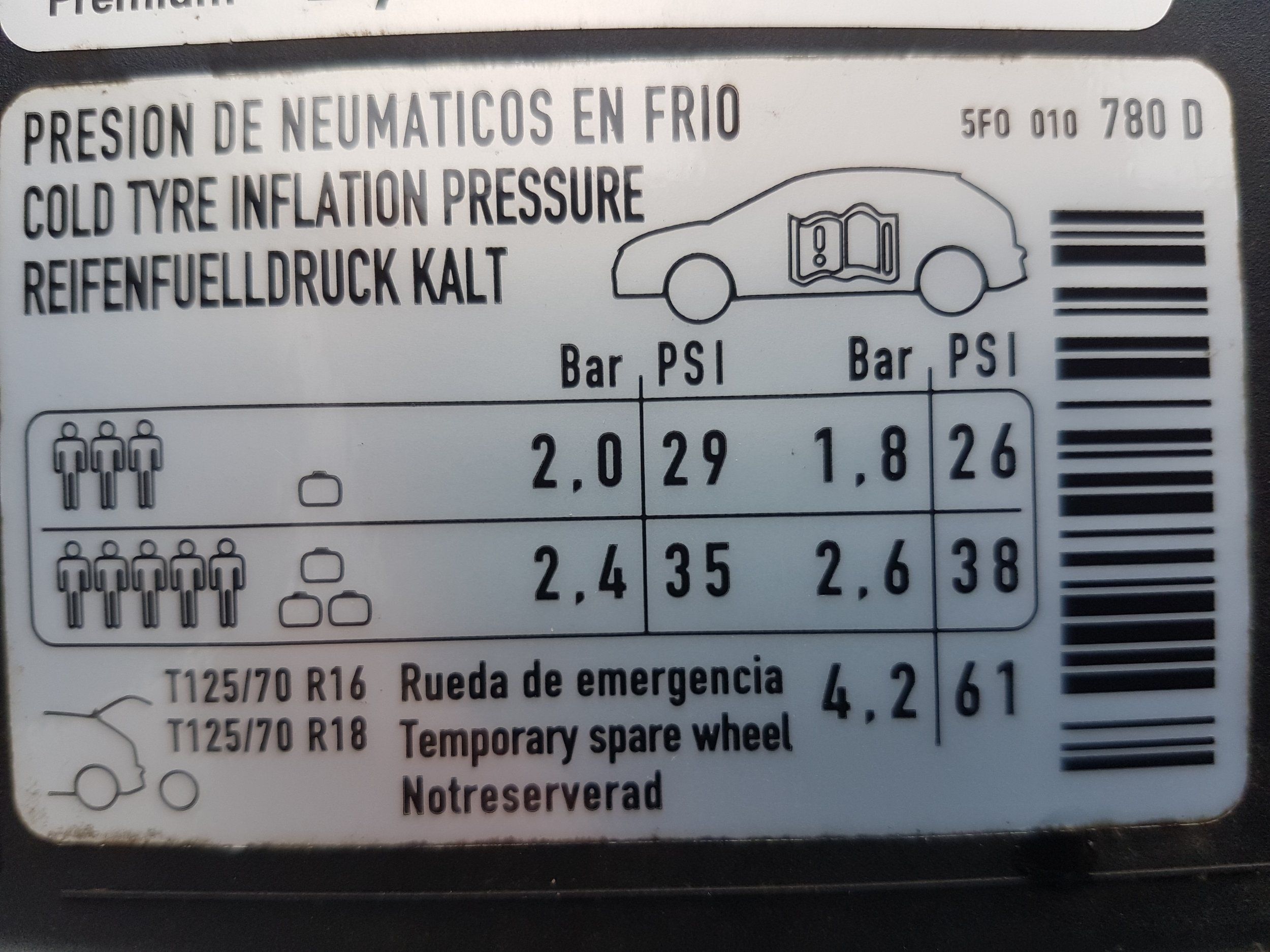

This is the tyre pressure sticker on my 1.4 FR fitted with 18" wheels. Hope this helps.
Reactions: Damo H

Thanks for the pics of the tyre pressures guys, so either we are all wrong or SEAT dealership is - and I think I know who is correct.
Edit:- BTW I do trust this pressure gauge and it agrees with what the gauge on the tyre pump indicates - though I always go by the tyre pressure gauge when setting pressures and not the shaken to bit gauge on the pump.
