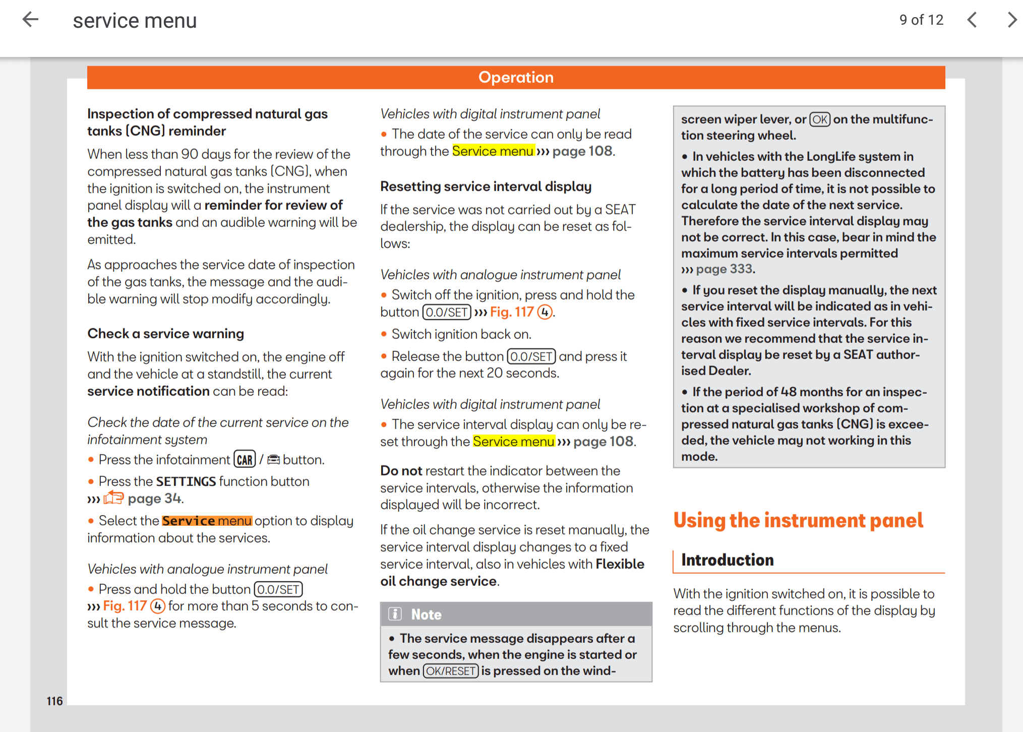

As far as what the car is seeing you can find a menu under service which gives you a count down to the two aspects of service:
-Oil change
-Routine service period
Generally they leave the factory set at long service, two years, the bottom one but oil change is reckoned by the car by monitoring use and viscosity.
The first one surprises people when it flags up a service. Wrong engine oil can bring around a service message quicker.
Service plans taken out with a 12 month service get set up as 12 month, so they get shifted off the factory set 24 month routine service.
Service data:
