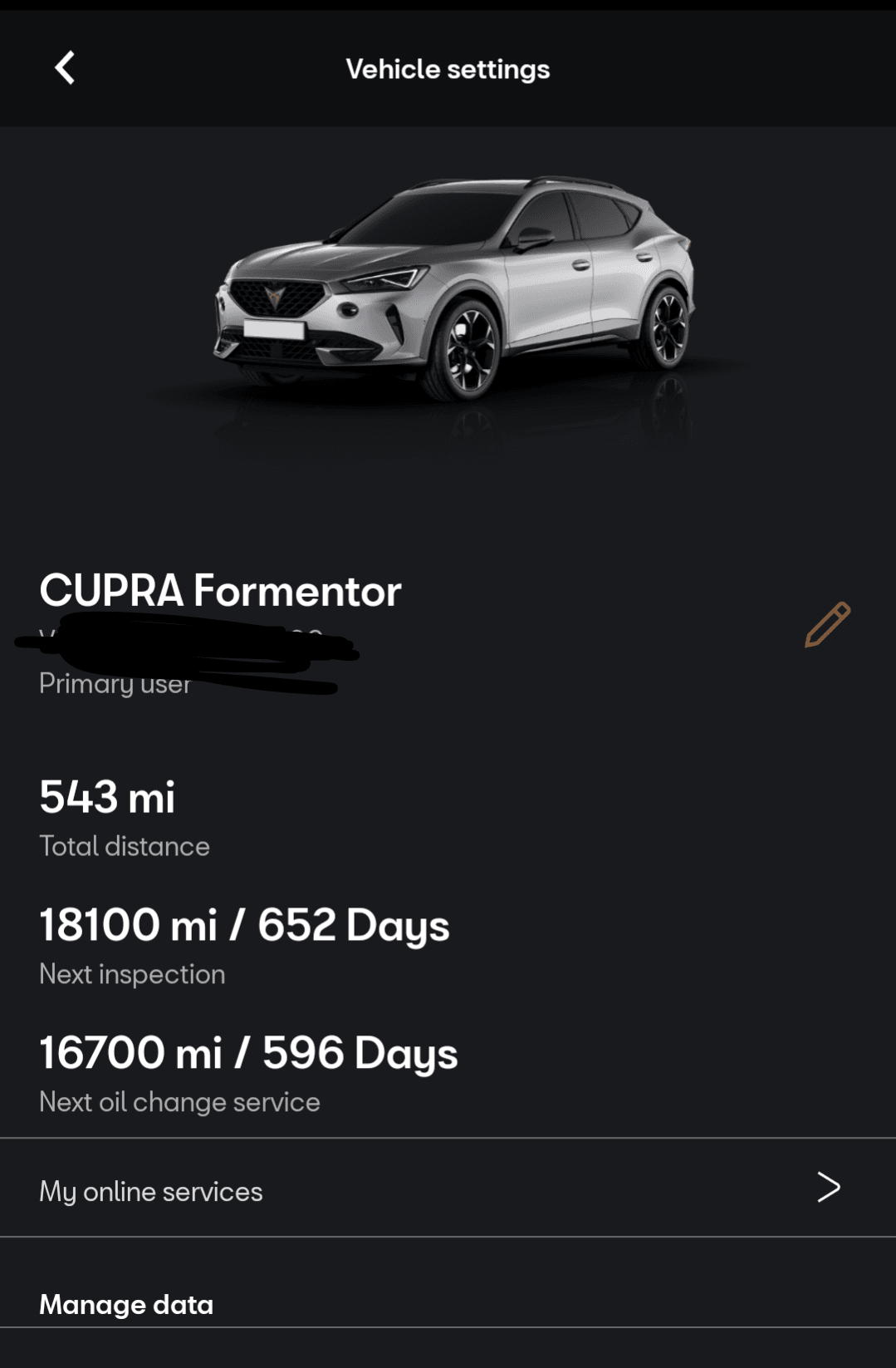

Hmmm picked my car up at the end of March and was planning on having the car serviced every year (will be paying as I go along to avoid the monthly outgoings).
However, my Cupra app shows that I don’t need a service or at least an oil change for 2 years?!

Maybe also check in the car, as the app doesn't have the best reputation of being reliable for anything!

Variable service schedule. I specifically asked for mine to be set to this when I picked it up, so that in the 3 years I have the car on lease, I only need to get it serviced once. Worked a treat with my Ateca.

There should be a PR code on your car’s data sticker to indicate whether the service regime was set to flexible (variable) or fixed (time and distance) in the factory when the car was built. Below is the list of possible servicing PR codes.
PR codes used will depend on the county / market a vehicle is sold in. For the UK, codes should be either QI4 or QI7 for the fixed / time and distance servicing regime or QI6 for the flexible / variable servicing regime.
  • QI1 Service interval display every 5,000 kilometres or every year (fixed)
  • QI2 Service interval display every 7,500 kilometres or every year (fixed)
  • QI3 Service interval display every 10,000 kilometres or every year (fixed)
  • QI4 Service interval display every 15,000 kilometres or every year (fixed)
  • QI6 Service interval display every 30,000 km or every 2 years (flexible)
  • QI7 Service interval display every 10 000 miles or every year (fixed)
I seem to remember that historically, the flexible / variable service regime was introduced primarily for operators of large vehicle fleets to help them ‘manage’ the maintenance costs of their fleet of vehicles. IMHO, the service regime that is best for you / your car depends on how you use your car. If you’re leasing your car, there may also be specific requirements regarding servicing in the lease agreement.
VW have the following guidelines on their website, which would also be appropriate for Seat, bearing in mind VW and Seat use the same engines;
Fixed Service - Recommended if:
  • You drive fewer than 9,300 miles per year
  • You mainly drive in the city, or if you make frequent short journeys
  • You often carry out high engine loading activities, such as steep hill climbs, towing, and driving often with multiple passengers
  • You often drive using a high engine rpm with heavy acceleration and braking
Flexible Service - Recommended if you:
  • You regularly drive more than 25 miles per day
  • You regularly drive long-distance
  • You drive at a constant speed with minimum vehicle and engine loading, such as hill climbs, towing, and driving with passengers
Thanks for that, very informative. Looking at my Cupra connect app it states service required in 18,600 miles or 710 days so I'm going to assume its QI6.
As we usually fall into the less than 9000 miles a year, VW would suggest the fixed regime. Presumably for an oil change? Would the car recognise this if required and request an oil change on the app?
If you’re not intending to keep the car longer than three years then I’d leave it as it is and save some money. If you plan to keep it/own it then with your mileage I’d move to Fixed yearly personally.
