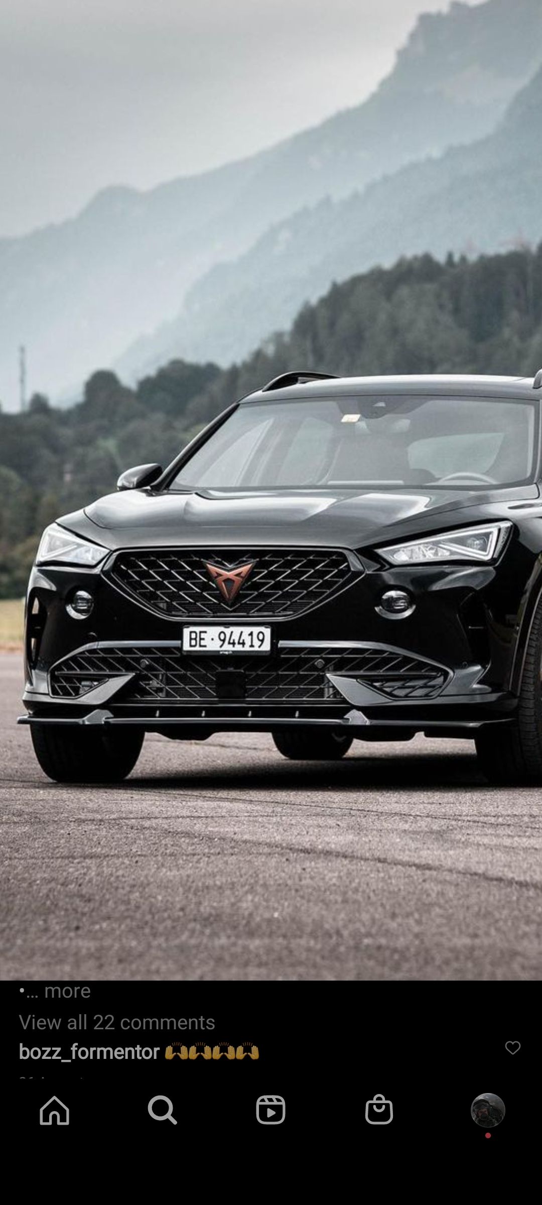

I was looking at this today, the European ones have a different playe holder on the front. I put my private reg on mine the other week and the front plate holder is held on with like plastic legs, which look like they fit through the bumper so if you were to remove it would leave two holes in the bumper.
But look at the pic from a guy I follow on insta, their plates are smaller than ours.

Thanks for this but that European plate is very small and would be illegal in UK. Yes I’ve investigated the fixings and understand what you are describing. I think I’ll stick with standard size! Your help is appreciated thanks ?

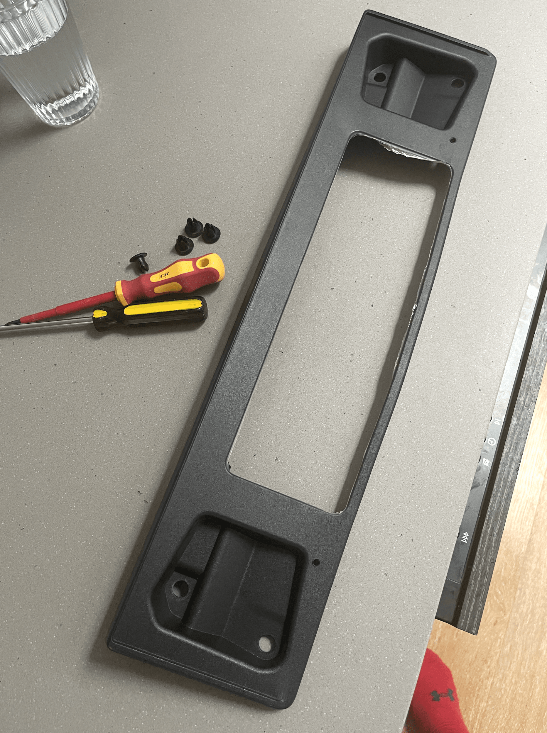

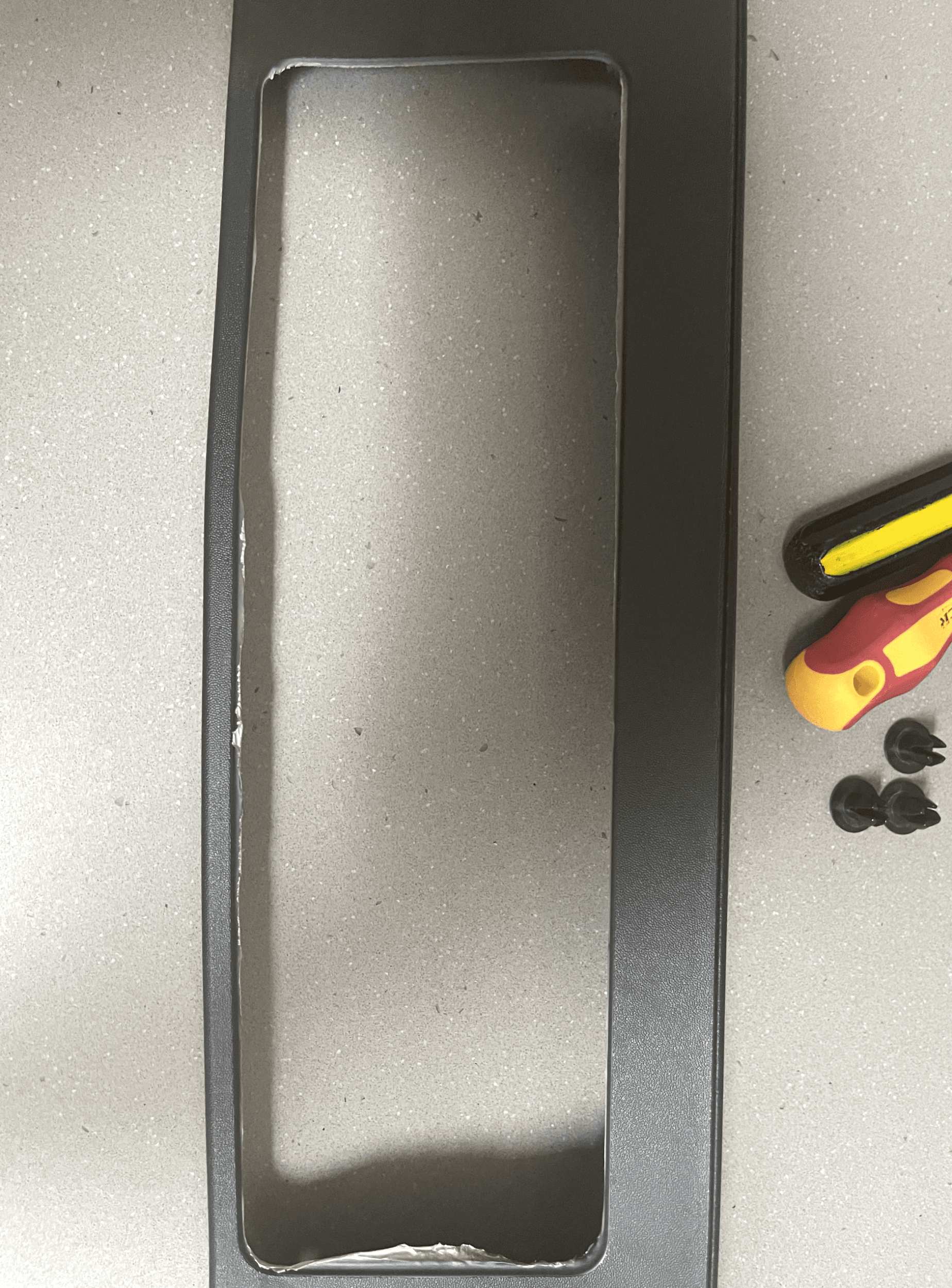

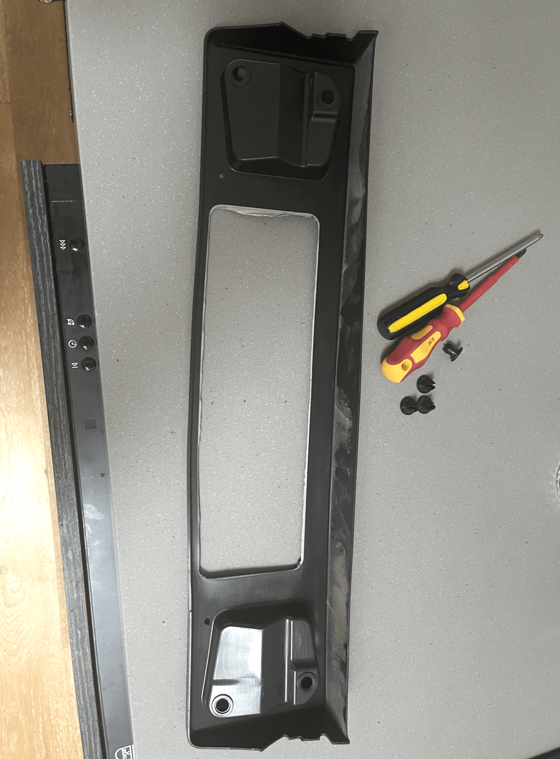

Old thread, but you can peel off the large part of the front plate holder leaving a minified version firmly attached to the car. See pics of the outer after it has been peeled off. Just remove the 4 plugs by pushing a phillips head screwdriver through the middle before pulling the plug. Then grab the outer edge, and pull it away / forward from the front bumper. It will peel away leaving the middle on the car. At some point you might want a grommet for the holes, but I havent bothered yet.

Hi, do you have any pictures of your car with this front plinth removed? I'm looking to do something similar.
It’s not removing it. It’s effectively reducing the perimeter so that it’s hidden behind the number plate.
