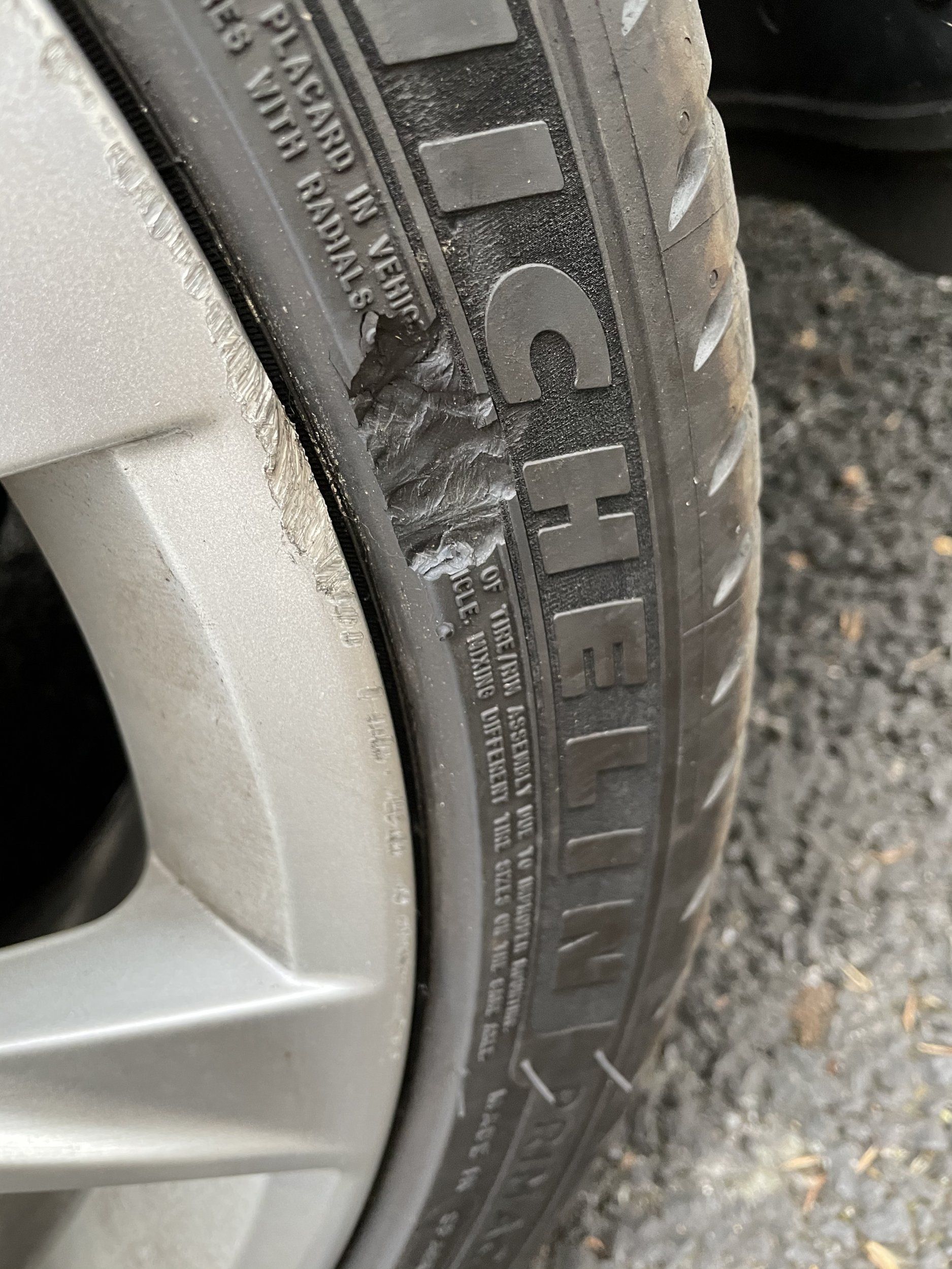

Hello,
This is my first post/question.
I recently purchased a Seat Leon FR and scuffed my alloys and tyres on the same day! Upset would be an understatement!
I just wanted to some advice around whether I change my brand new tyres due to some of the tyre peeling of the side?
Image attached.
Moe

No, that's fine. That's some of the laughingly entitled "rim protection strip" that doesn't! If you get a subsequent bulge, indicating damage to the carcass then yes.
Reactions: LeonFR21

I had similar damage on one of the tyres on my previous car. I asked a local tyre fitting place if it was safe / OK to use. They could’ve easily told me I needed a new tyre and charged me for the privilege, but they were honest and said it was fine.
Reactions: Mr Pig and LeonFR21
Thank you for sharing mate. Much appreciated.

The rule of thumb here is: no wire or cord should be visible or possibly exposed to water intrusion. Anyway, scuffing won't do much harm. Hitting a curb dead on at speed would increase chances of deeper tyre damage.
Reactions: LeonFR21
Thank you. That gives me reassurance. I was driving at probably 5mph and scraped the kerb. The crunching sound of metal and concrete is just painful!
