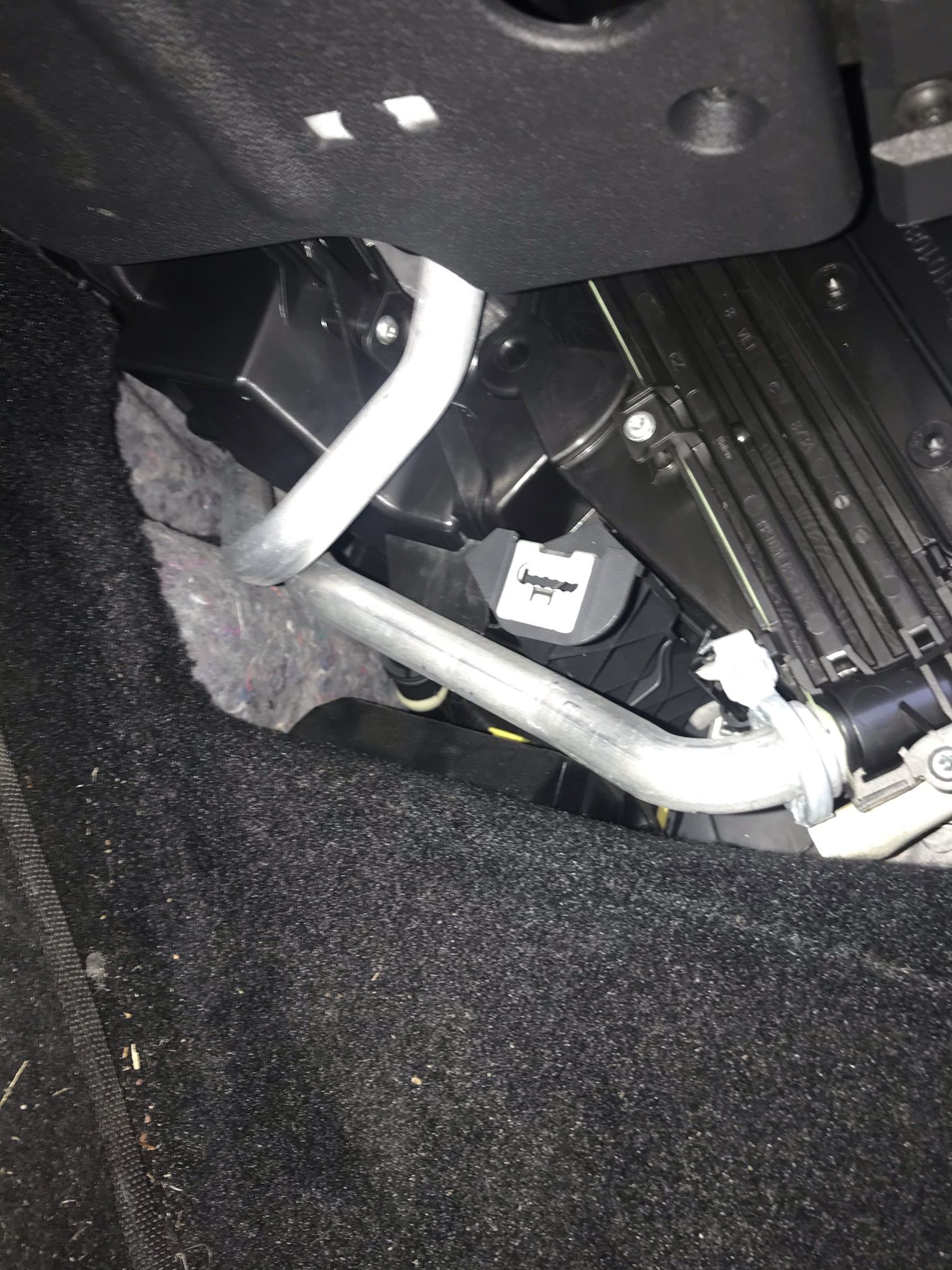

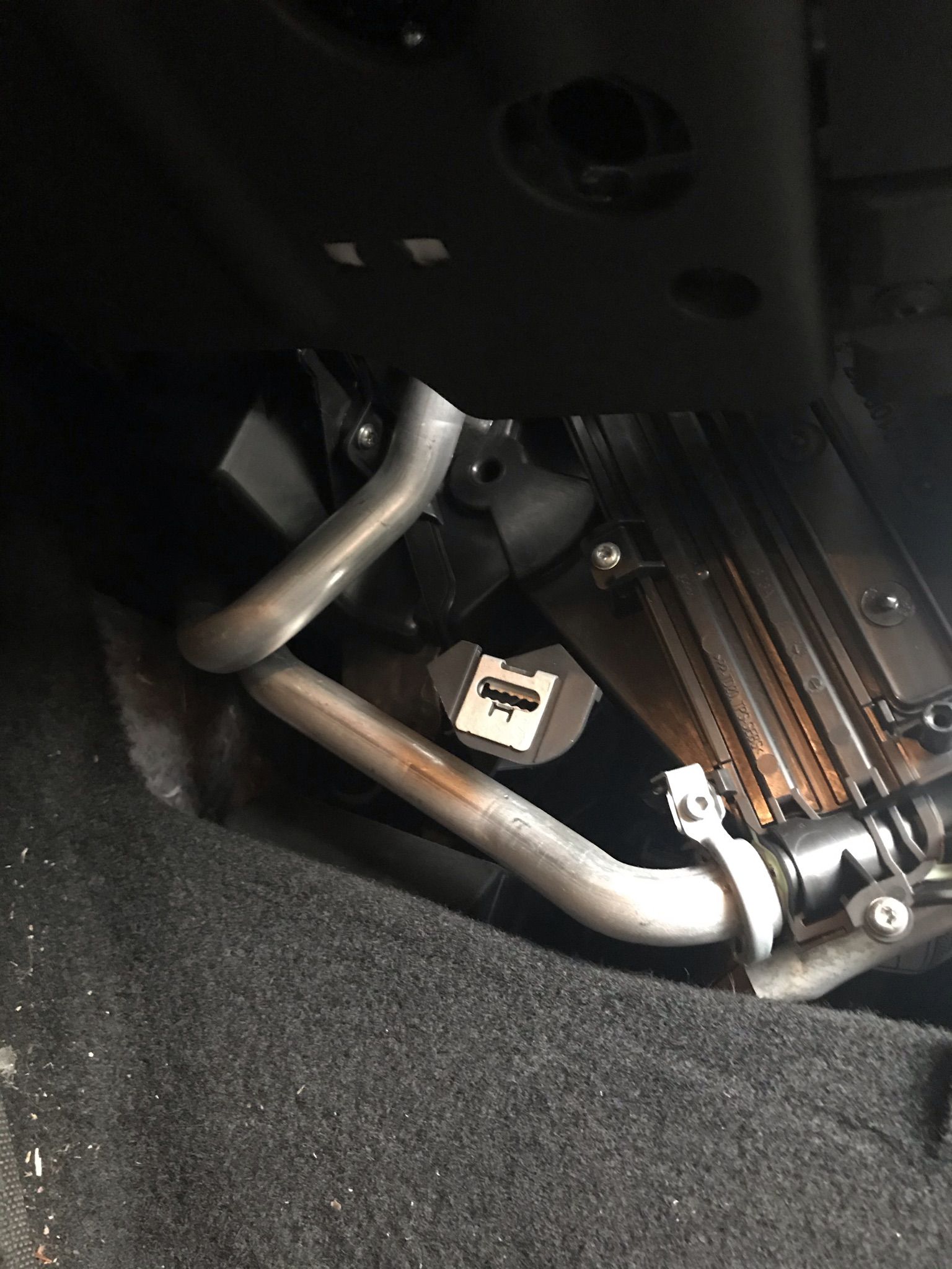

New to the forum but with some issues with my 1.6tdi, started with blowing the coolant out and now no heating grrr.. I’ve had a go at flushing it and no joy there, can someone confirm these pics are the heater matrix and not the air con?

Thank you that bugger is coming out this week then ! I cannot crack the pipes off in the firewall so I’m expecting a bit of fluid leak I don’t care now this thing got me going crazy!
