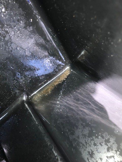

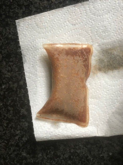

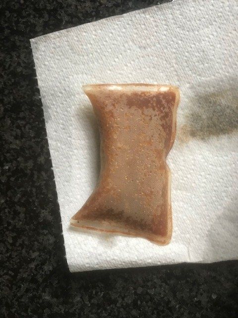

Update on my experience: No hot air, so the dealer had a look and said my bag had burst £1200 or more to fix. I took it away and removed the bag it hadn't burst!

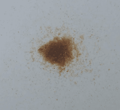

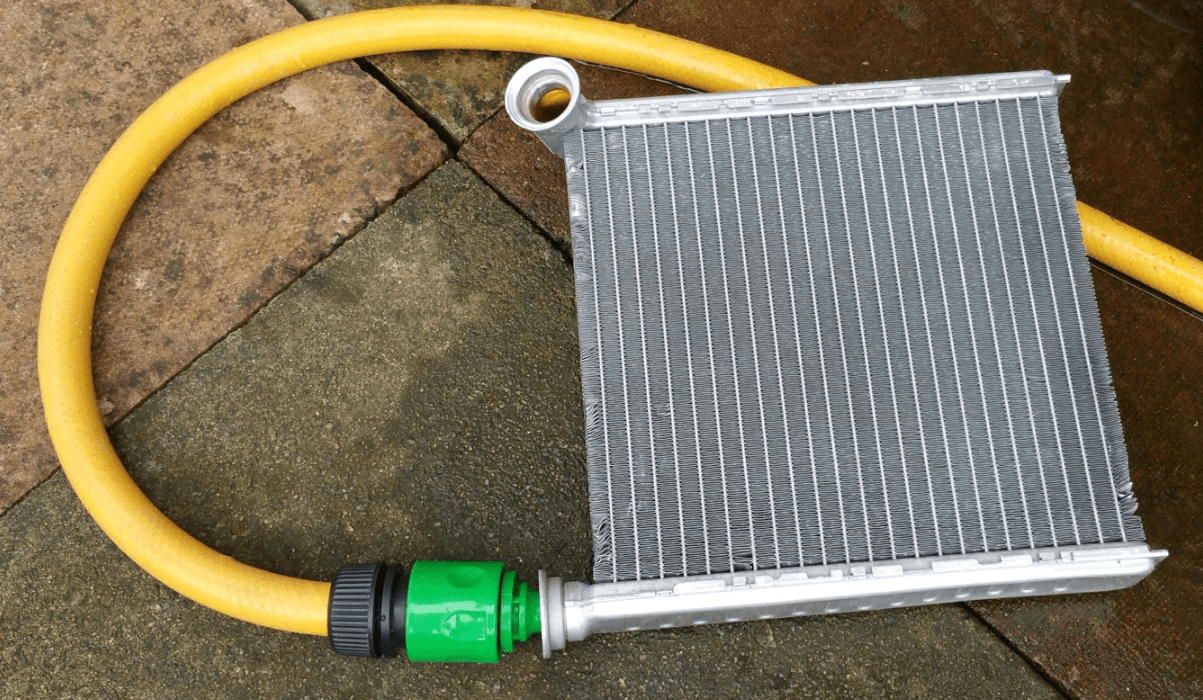

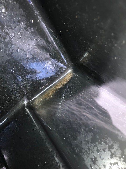

Removed the tank and cleaned the brown deposit out. Eventually I removed the heater matrix (Not that difficult to do) and reverse flushed it out in the sink. Got a load of brown gunge and grit out of it. This seems to be residue from the metal casting process.
Drained the coolant best I could and put it back and heater works fine.

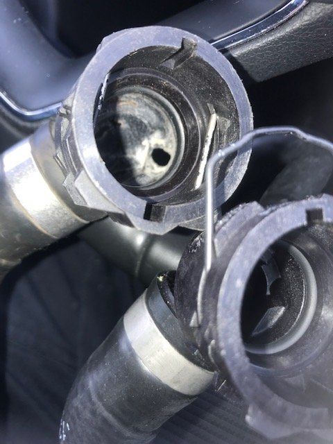

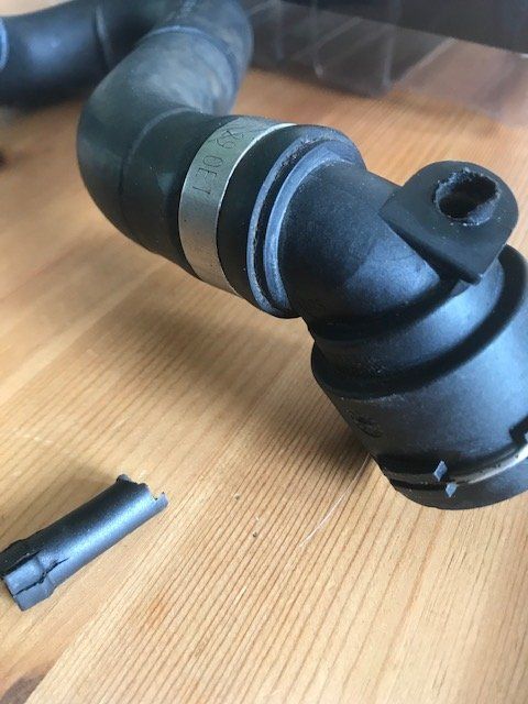

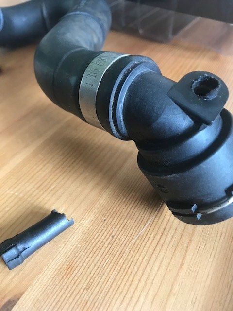

A couple of months later my low coolant warning flashed up (about 85K miles): traced to failure of an auxiliary pipe attachment which feeds off the heater at the bulkhead. On inspection the inside of the hose fitting was eroded to the point it perforated and snapped; the grit that was in the system must have
worn the material away on the bend where this small pipe branches off - it had got paper thin. Pics show contaminated silika bag (intact but dirty), some of the grit and hose (old and new). I imagine it's not done the rest of the coolant system much good.
View attachment 19492View attachment 19493View attachment 19494View attachment 19496
this is what I flushed out of my heater matrix:
and how I did it:
I struggle to believe that this silicate could erode the inside of that plastic pipe - that is just a vent after all with very little flow/force, it just wouldn't have enough abrasion potential. Maybe just a faulty piece?

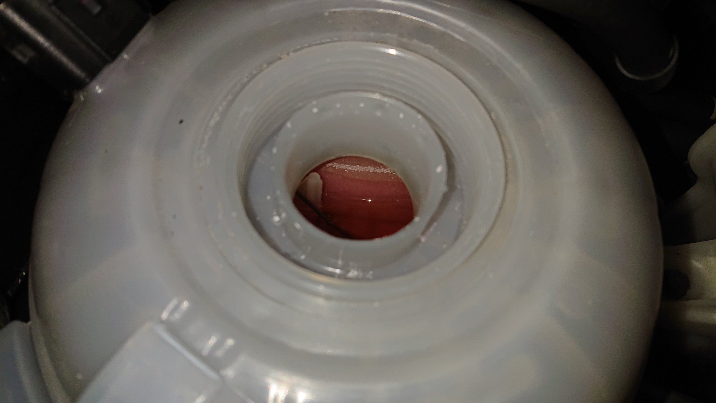

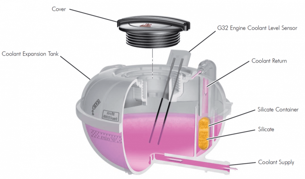

what year is your Leon? as I think there must be different 'mit silicat' tanks - mine says mit silicat' (184 - 64 reg) but there is no way I could remove it - looks more like this image and the silicate is contained in it's own small reservoir.
Whether this was a revised version - to the version which people can remove the bag with pliers I don't know? and if this version can still leak? who knows?
I seem to remember reading that there are quite a few manufacturers that use some form of "boaster" pellets in the cooling systems, but only VW Group did a quick "slip a porous bag in" way of doing it, others used a properly designed and manufactured porous container. Good to see that some VW Group cars ended up with a revised coolant tank though.
