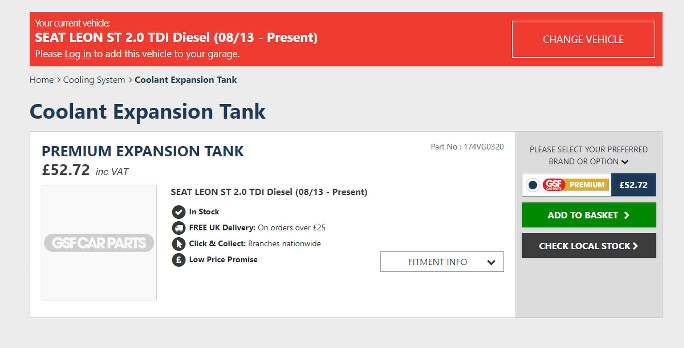

Does this look like the same as what you bought? I’ve found a few with slight differences and can’t get to my car just yet?
Hi @Joshua Oakes
I also got mine from GSF but it had this code;
Item in your orderQtyPrice
EXPANSION TANK
SKU: 174VG0320
1Excl. Tax: £19.19
Incl. Tax: £23.03
Subtotal​
£23.03​
Shipping & Handling​
£0.00​
Grand Total (Excl.Tax)
£19.19
VAT​
£3.84​
Grand Total (Incl.Tax)
£23.03
Reactions: Woody_72
So I had another look at my reservoir bottle and it only has G13 printed on it. No 'Mit Silikat' labelled anywhere.
Along with no mention in the manual for needing a silicone bag or changing the fluid at set intervals if you don't have a bag in reservoir.
So my point being if I wasn't reading these forum threads I'd presume the coolant would never need changing, Just topping up..... Unless I'm missing it.. Could someone point me in the right direction.... Thanks..
