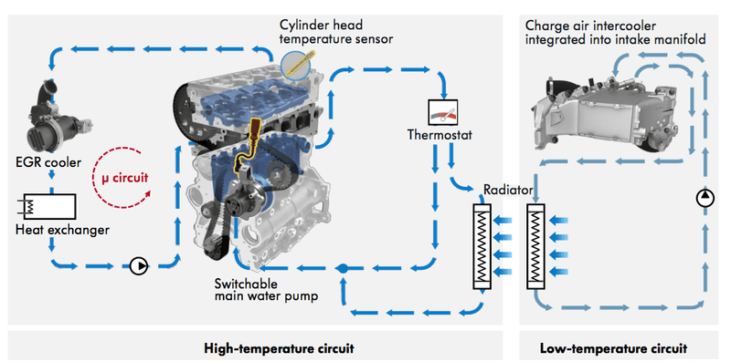

Assuming you have the EA288 engine - its actually has 3 coolant circuits, so it's hard to drain the whole thing without the right kit. The main one runs through the radiator and that contains a large amount of coolant. Some radiators may have a drain point or you just pull off the lower rad hose and drain.
Then fill up with new coolant, run car and check every day before starting and top up if needed (check everyday for a week at least). They can get air locks etc and sometimes take a while to settle.

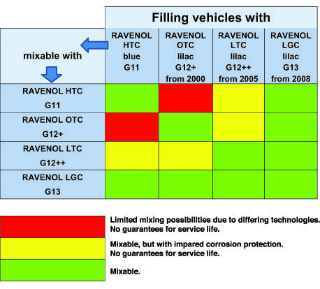

@RUM4MO thanks for thinking I might know the answer! I don't!
I have read up on it before and this web-site offers some good information and also shows what coolants can be mixed if needed.
I have no idea about the "mit silikat" being used/discontinued and thought is had been stopped on newer cars and from what you say, that is not the case!
My car has pink coolant so not sure where that fits in! I guess it should be G12++ or G13.
This makes no reference to the much newer G12EVO but this forum has some info on that:
Your guess is as good as mine. From my point of view, as long as I put in G12++ or G13 and change it every 2 or 3 years, I should be fine.
