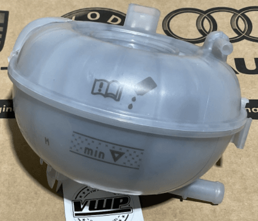

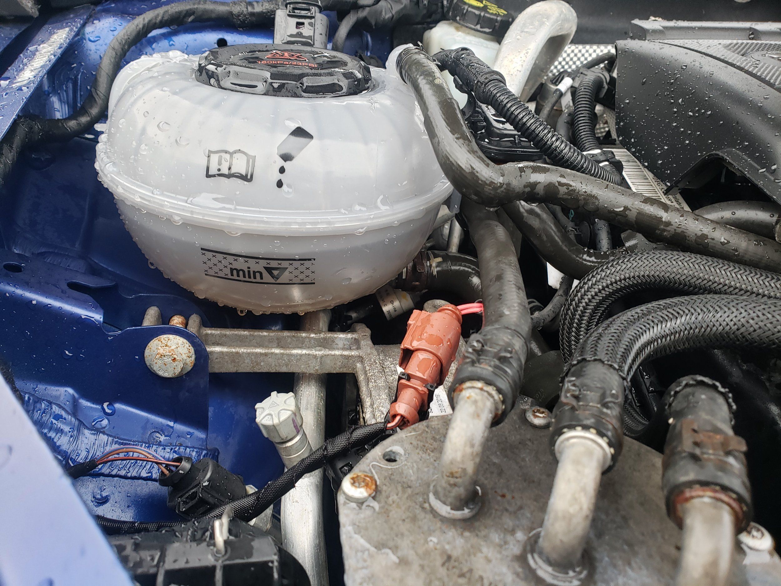

The new bottle I fitted to my Leon this last weekend (this one) does not have any coolant type label

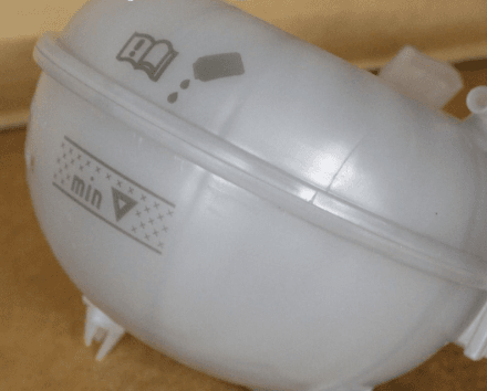

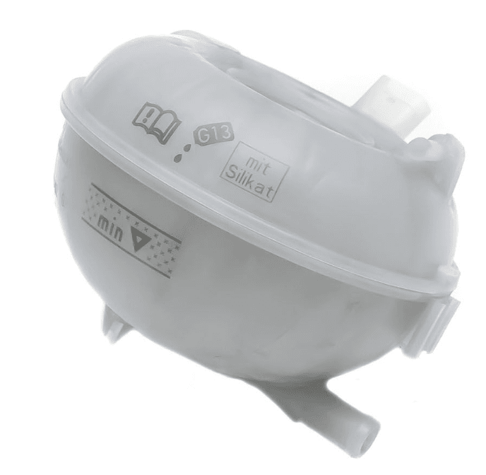

I can see a supersession from:
5Q0121407G to 5Q0121407M removing mit silikat and blacking out the G13! from July 2019 Leon's should have the latest 5Q0121407M tank - presume this is also with a switch in coolant type.
edit:
Yes same date for a change in coolant G013A8J M1 to G12E100M2. (G13 to G12evo)
5Q0121407G
5Q0121407M
