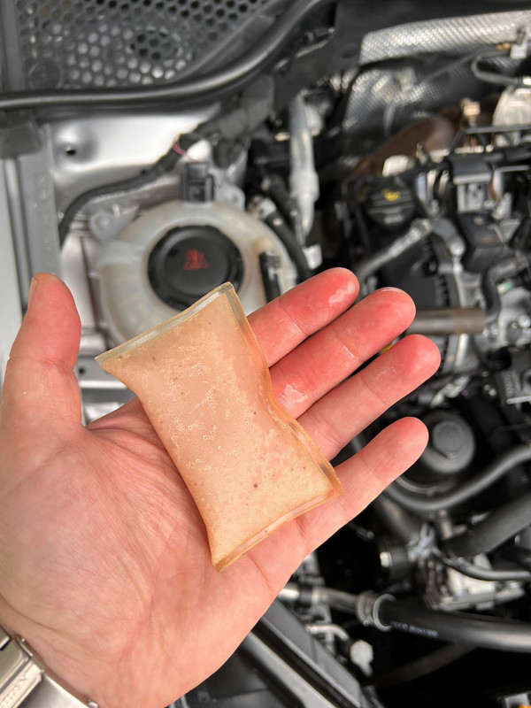

A few questions about how often the coolant should be changed if the bag is removed - answer to that is that the coolant is changed at every cambelt change anyway, so no issues at all.
Removing the bag was the first job I did on my Leon 1.6TDI

Agreed and accepted, though I was under the impression that the silica bags were only in the diesel engines, and all the VAG diesel engines were belt driven. My 1.6TDI Leon had the silica bag in, and I removed it, but my 1.2TSI Toledo is chain driven and does not have the bag

Double skinned yes, but surely that second skin isn't sealed, and the silica bag is still open to the rest of the system. The bags can't go in before they plastic weld the reservoir together, sealing it in position, surely??? I was lucky, I could get mine out with my fingers

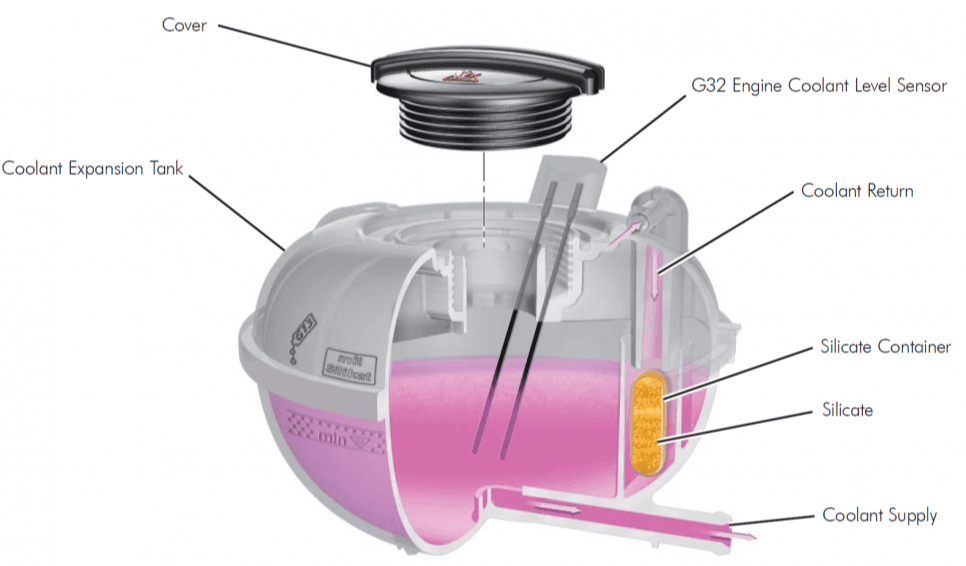

This is the 'double skinned' version I had in my 2015 184TDI - no removable 'Tea Bag'
You cannot remove this type of silicate repository without destroying the tank.
I have my doubts whether this type can actually leak? and if it did the coolant return flow would have to be strong/fast enough to carry the granules up and over the container which again I doubt as there isn't much flow through the coolant header tank return pipe.
I changed mine anyway to a tank without Mit'Silicate. 'just in case!'
