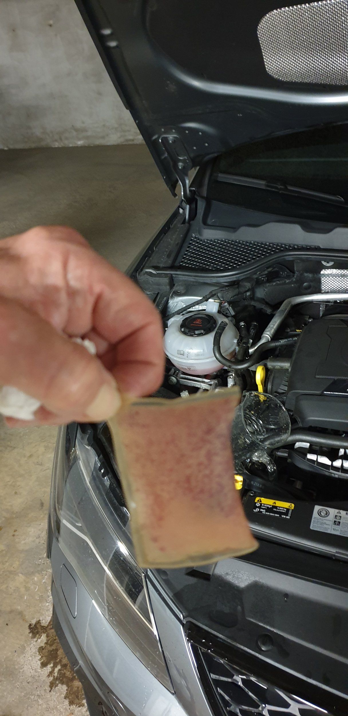

Thanks guys for the heads up on these i have removed my bag today from my 2018 184 fr and with gloves on I managed to remove it extremely easy about 5 mins. Cheers thanks

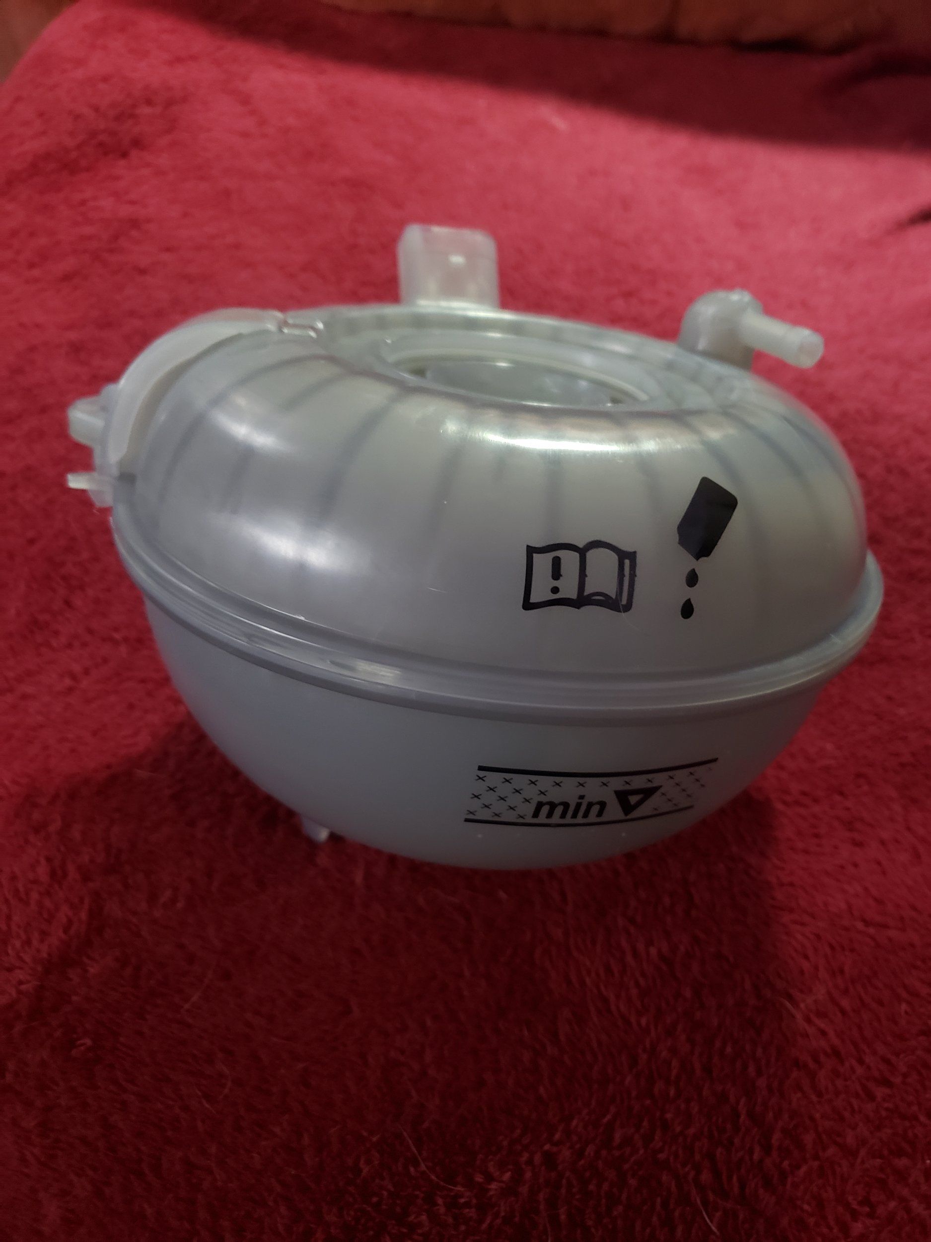

My job on the Leon tomorrow...... 2.0TDI DSG (adblue). Ebay £18.99. Got the VWAG and part number on the bottom. Just going to syphon out what's in the header tank and replace, it's getting a full coolant change next April/May time when the timing belt and water pump are done

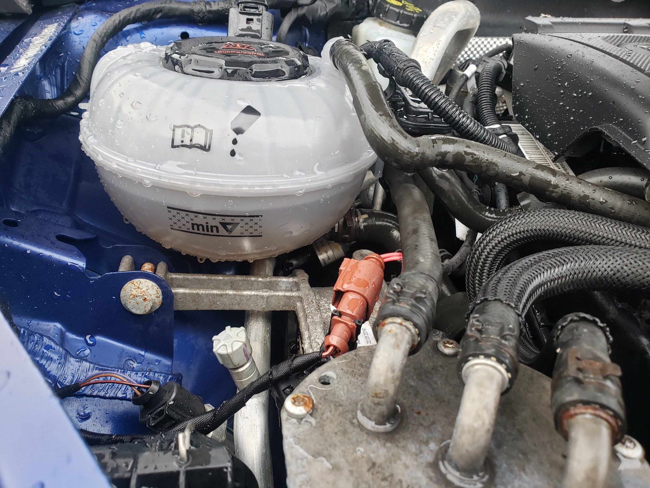

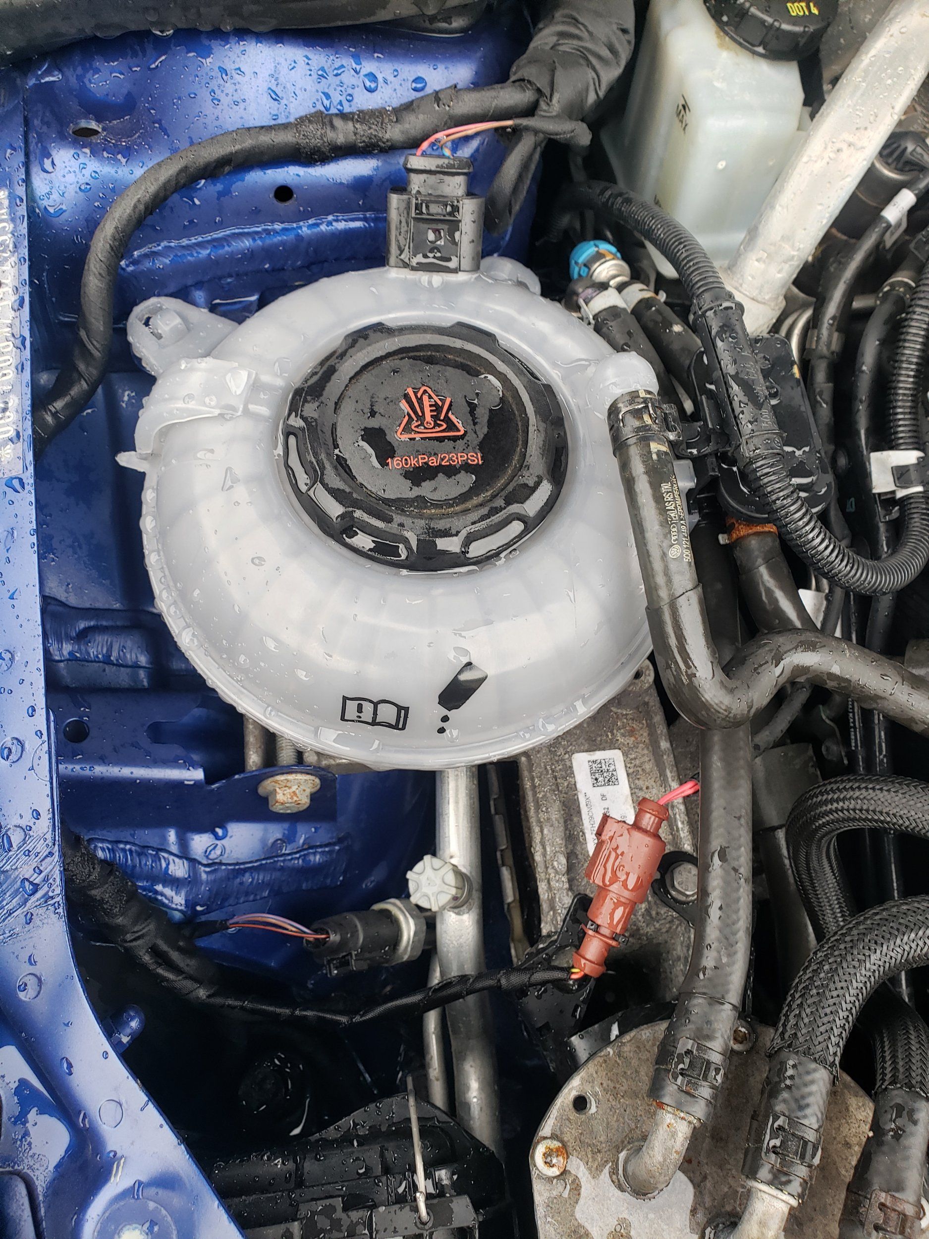

About 20 min also for me per Golf and Cupra for unmount the tank and delete the silica bag. No cost :).
As it looks now I will do a partial change using G13, perhaps 2x (runing engine before process no 2). I dont want to go to workshop/dealer, want to do it by my self. I expect to get out about 45-50% of the volume per process.
I dont like the possibity that if I mix G13 and G12EVO it will end up color Brown.....Dont know if it is like that.....
You had it lucky, as I did with my 2014 Leon 1.6TDI. The bag was easy to get out of the expansion bottle, with it just sitting in a pouch. The current 2019 Leon has (had:)) the double skinned bottle, so impossible to remove the bag - but 20 mins work and £19 for a new bottle is a much cheaper option than sorting out the results of a potential burst silica bag months or years in the future. At least I know the threat of that has now totally gone :)

My son have a Leon Cupra ST 2019. When in time I take care of his car I need to order a tank I suppose :).
Did you order a tank identical to 5Q0121407M?
Thanks for the info ref the silica bag, removed this morning nice and simple 5 min job
