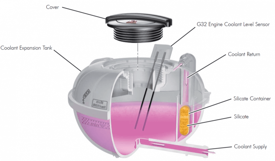

This is the 'double skinned' version I had in my 2015 184TDI - no removable 'Tea Bag'
You cannot remove this type of silicate repository without destroying the tank.
I have my doubts whether this type can actually leak? and if it did the coolant return flow would have to be strong/fast enough to carry the granules up and over the container which again I doubt as there isn't much flow through the coolant header tank return pipe.
I changed mine anyway to a tank without Mit'Silicate. 'just in case!'

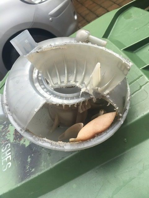

There was a forum member over on briskoda.net forum who butchered their double skinned expansion tank to get to the silicate bag - picture from post on page8 of the discussion thread at the link below;

The pressure in the system would surely allow flow of the granules, they won't be that heavy. If the design is as in the diagram, why on earth have they not built in filters to stop the granules moving away from where the bag is situated?

I can't see them bothering to fit these silicate pouches if they were not needed, mainly, it seems, with TDI engines, as I've said many times, "is this only a G13 coolant issue?|" and if so, changing to G12evo should let you walk away from it.

Cooling systems aren't designed with much flow through the expansion tank. The expansion tank is only there to collect air and allow expansion of the coolant is it gets hot.

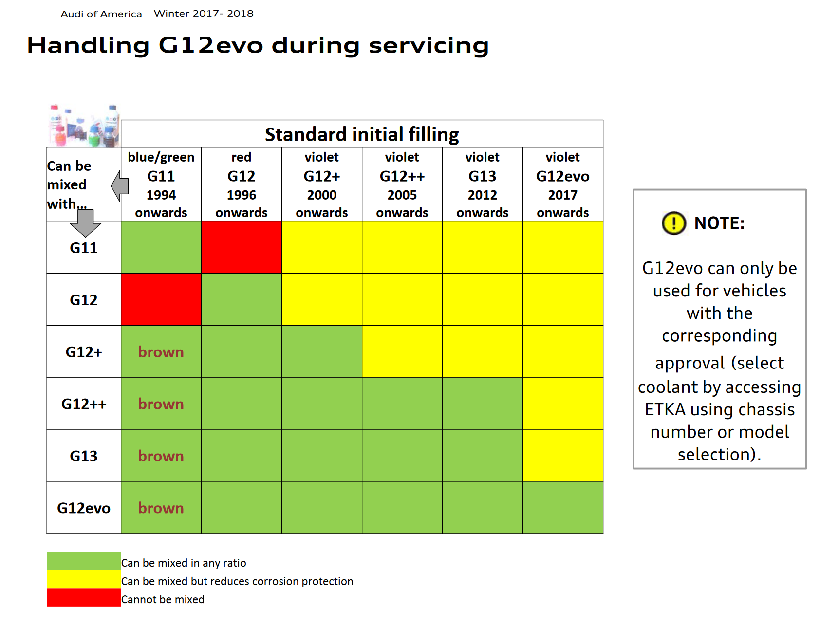

Are you going to replace the G13 with G12evo when you replace the reservoir bottle?
I was servicing the brakes, including replacing the rear pads on my daughter's May 2019 Leon Cupra, I meant to check the coolant with some "test strips" that I have, really just to make sure that the PH level was still okay as it should be as it has one of these silicate loaded reservoirs, but I forgot to bring the test strips out with me to the garage, and her time was tight, so I just topped up the coolant with neat G13, I should try to convince her to change to that non silicate reservoir and change to G12evo in the spring time, I'll use your info on which version meets that criteria, if or when she agrees that doing that is a good enough plan!

For the moment I'm just going to top up the new reservoir with 50/50 G13/water and do the change to G12evo early next year.
I'll admit to being naive enough to have assumed that all reservoirs that had that material within the double skin, would have a properly engineered way to package it - I was wrong!
