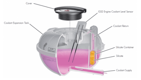

Is there an easy way of knowing if you've got the revised expansion tank below? From the cut-away picture, it's difficult to work out if the silicate is still a large sack or a pellet of some sort. Does anyone have a part number for this revised tank?

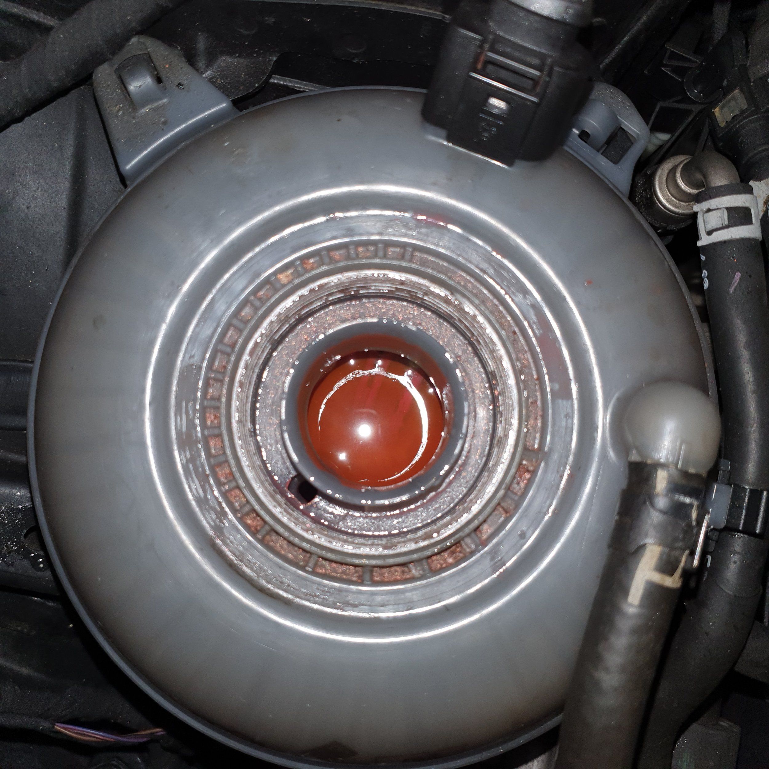

If your tank says MIT Silicat on it then it will either be this design 'container' - or the 'tea bag' design?
If the 'tea bag' design you can see if you look through the top of the filler neck.
If the 'container' design you can't see it from the filler neck.
My tank is 5Q0 121 407 A and it says Mit Silicate and has the 'silicate container' like in the diagram above, and my car is 2014 Leon ST 184 TDI - there is no way to inspect the integrity of the 'container' unless you cut the tank in half!

I'd guess, but only a guess, that as that diagram shows a raised "bump" on the upper surface, then if you had Mit Silikat and that raised bump, it would not be the "tea bag" version.

Yes, they ALL have this raised bump - it is just the flow return connection.
One visible difference though is earlier versions (like mine) have an internal path for overflow coolant - via a hole at the bottom, and the later ones G and M have an external pathway for expelled coolant to the side, I guess so it is more obvious if your tank has been leaking - like your overflow on your boiler at home must be visible.

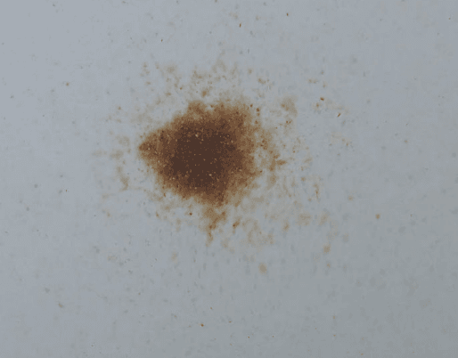

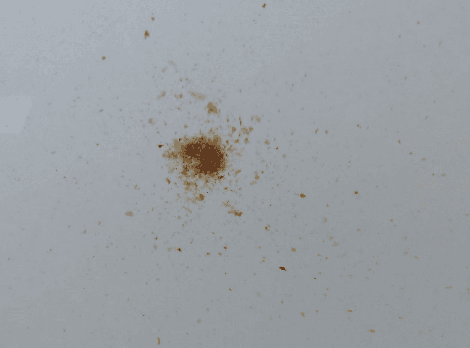

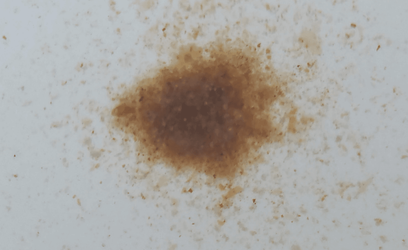

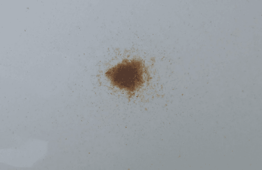

this is what I collected out of my heater matrix on the last flush I did in March:
Anyone know if this is Silicate from the header tank - or remains of casting sand from engine production?
edited as the picture had changed a bit dark!
Zoomed in but a bit blurry

In your photos it does look more like fine grit which possibly is as you say casting sand ?
To be honest you're always going to get some kind of fine abrasive particles from any engine that's water cooled, antifreeze can help against corrosion but it can't fully prevent it, small particles from inside the engine block or cylinder head are going to wear away or partly dissolve making the coolant semi abrasive, including other bits wearing away from inside the radiator core tubes or heater matrix, and thermostat possibly even water pump.

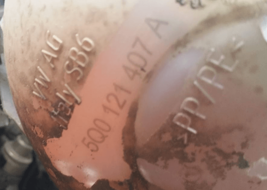

Interesting info - just to add/confirm:
My Leon (2014 184TDI) has header tank 5Q0 121 407A and I can confirm it says Mit silicate and has the inner chamber type silicate which you are unable to remove/inspect.
Agree 5Q0 121 407M is the latest revision and this is without silicate.

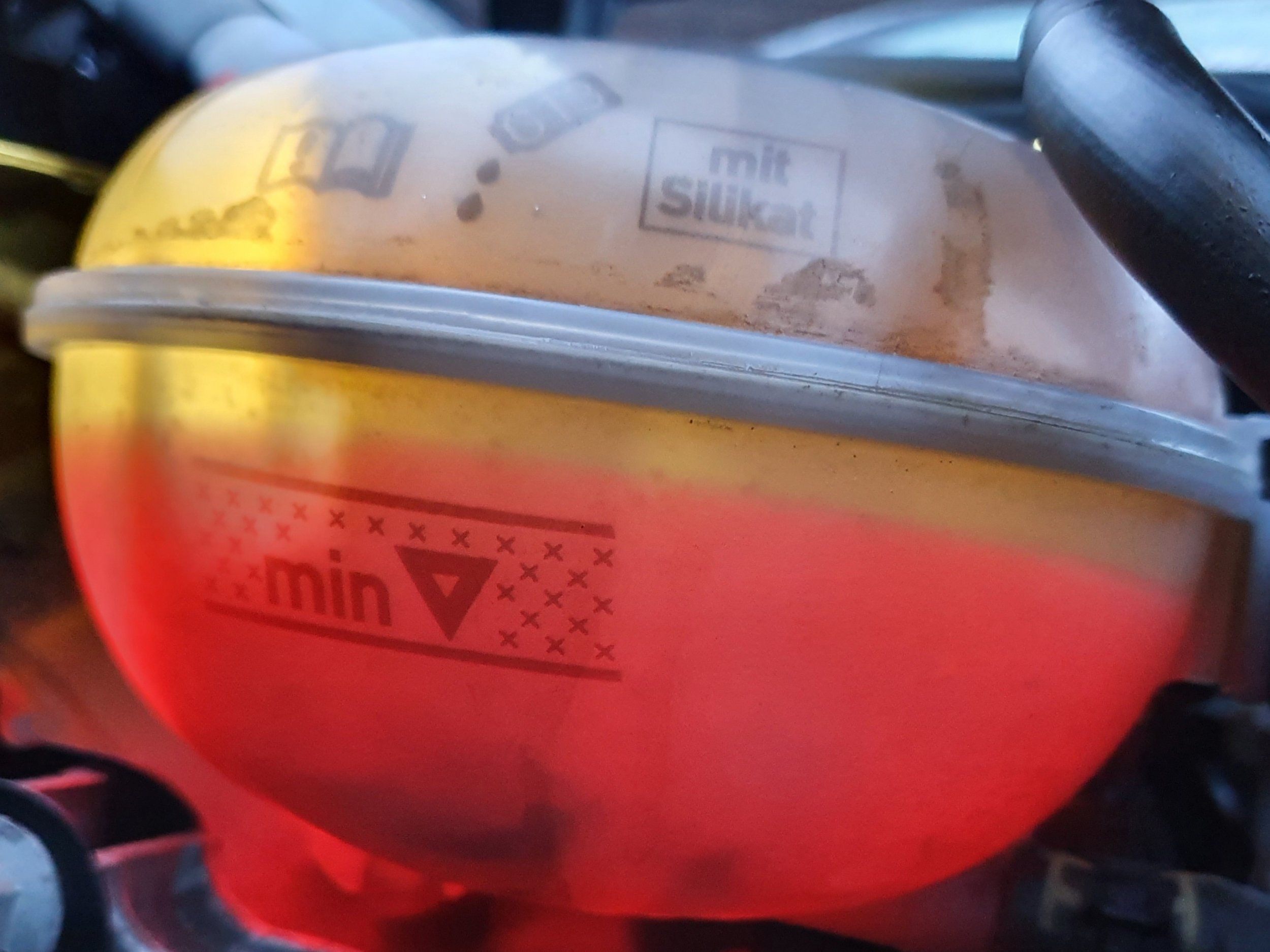

I‘m unsure which header tank version my 1.8 TSI currently has but wondering whether it is something that should be replaced :unsure:
As local garage fitted a new heater matrix last week when climate control stopped warming the cabin (water pump, thermostat housing and temp sensor were done last summer following a P2681 code) but perhaps the expansion tank is another ticking time-bomb ?
View attachment 20264 View attachment 20265
The part number is on the bottom - but it says Mit Silicat - so includes silicate repository.
As above so possibly is one of these part numbers below that I listed in my previous post.
