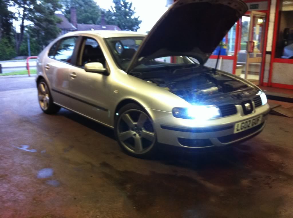

hey guys had my leon for for about a year and a half now, some of which has been filled with trouble free motoring however allot of it has been rather painful ownership as i have ran in to alot of problems with Leona...(her name now) i have done a few things to her.
this is how shee looked about august last year..

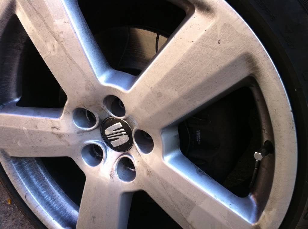

i sold those alloys as was going to sell the car on so she now sits on the old standerd 16" alloys.
im thinking about going bbs ch reps or 3sdm alloys next.

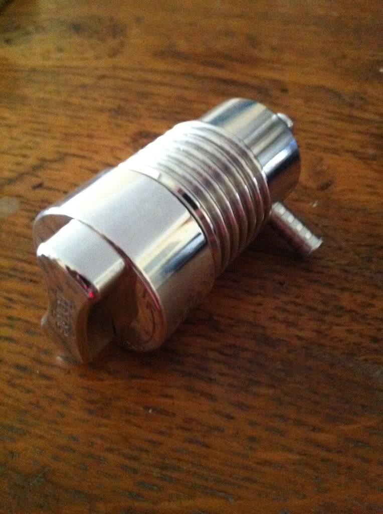

first i thought i would do a oil service new plugs and whilst i was ordering stuff a awsome/forge 007p dv

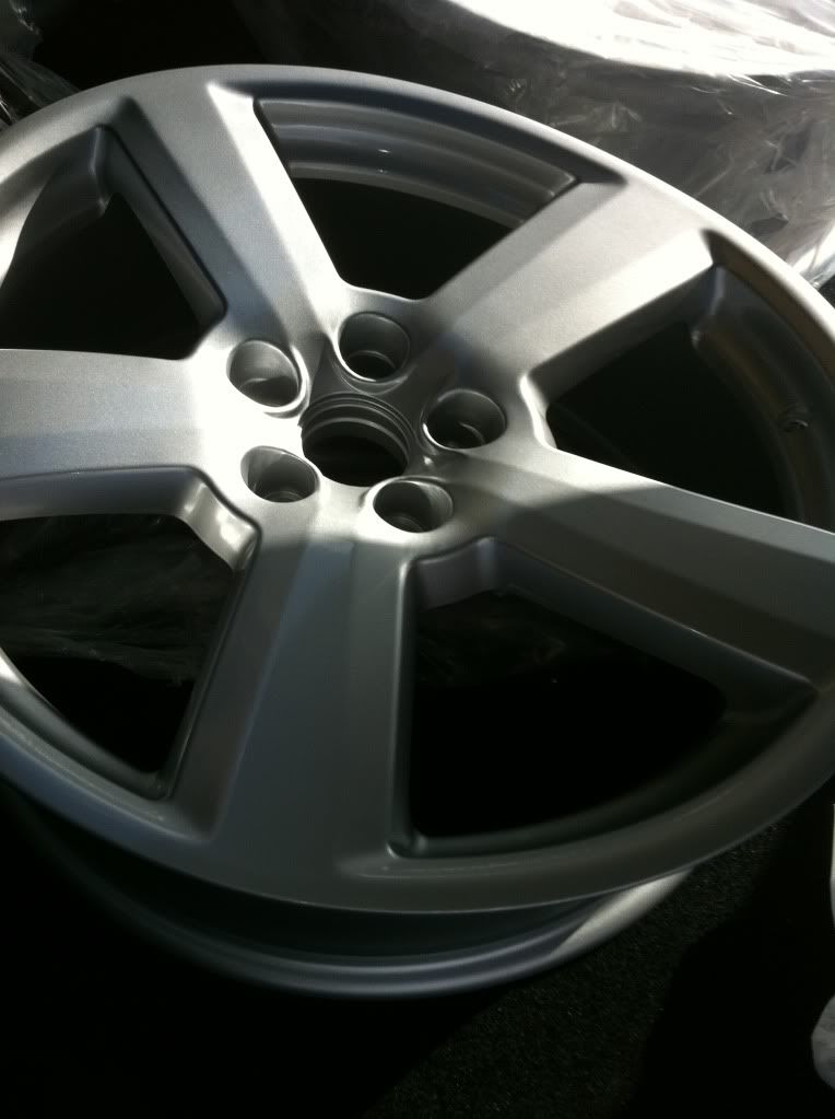

then i got some RS4 rep alloys with yokohama parada spec 2's

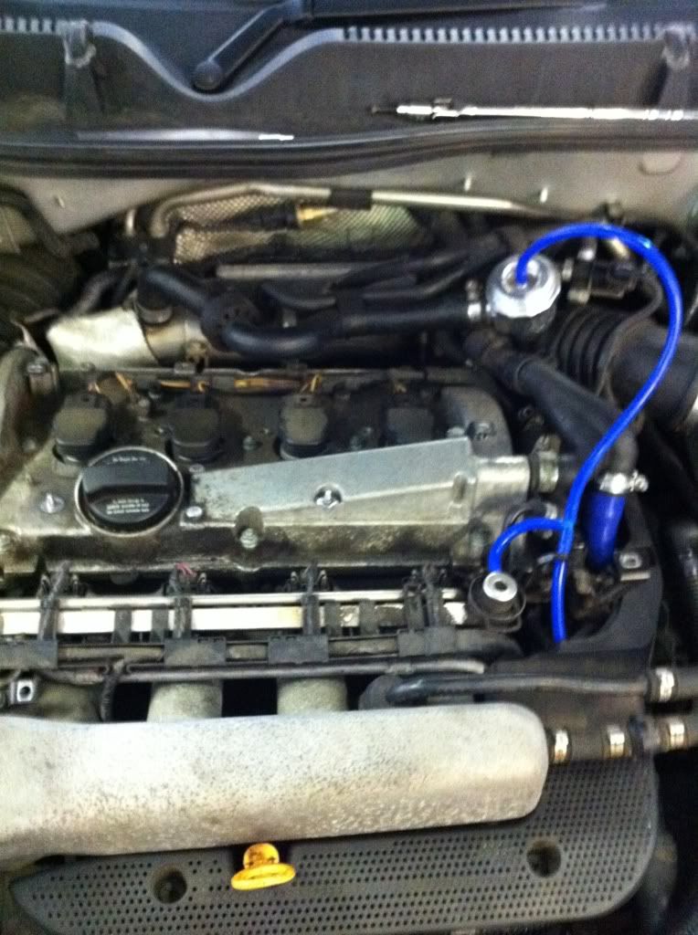

then lack of money kept me from doing anything big so i done the n249 bypass
but realised when i toolk the plastic air chamber off i dident block that hose off :blink:

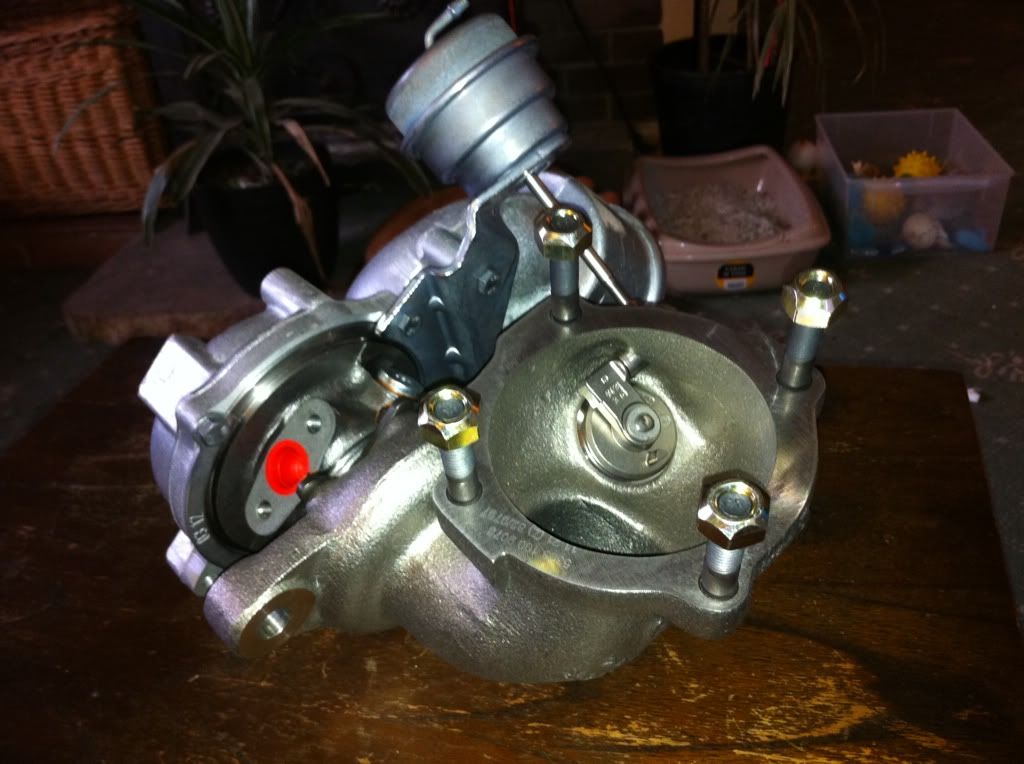

problems started shortly after as i was getting an unplesent whining sound from the turbo :(

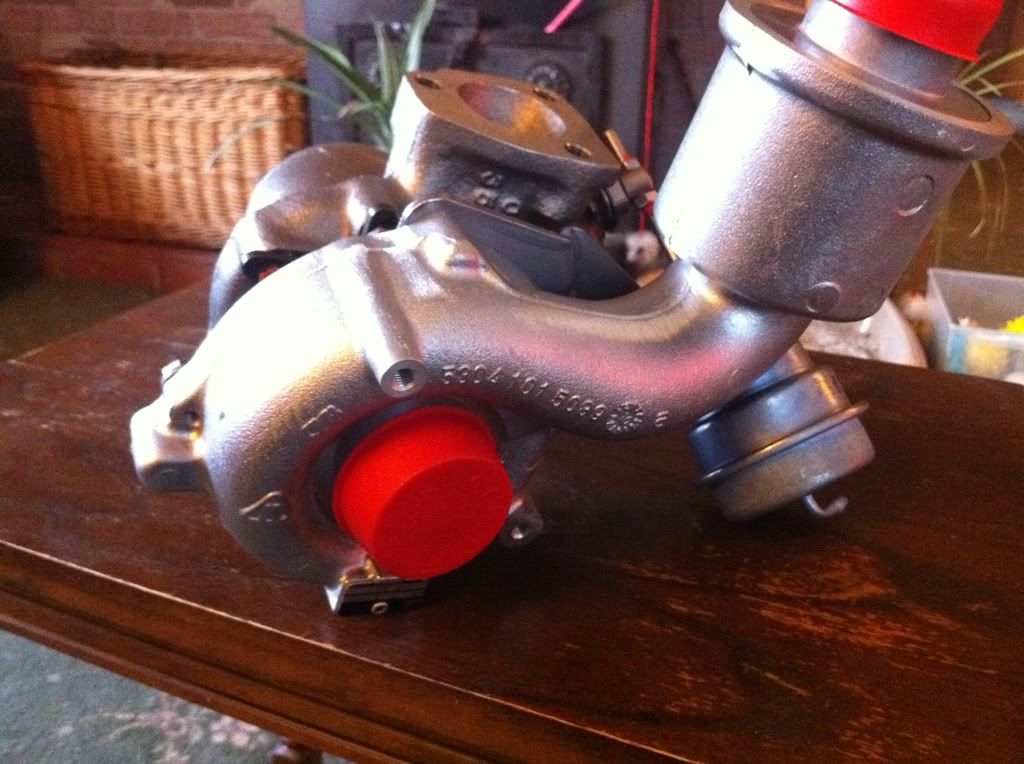

so when i had enough money this got bought!
shiney! :whistle:

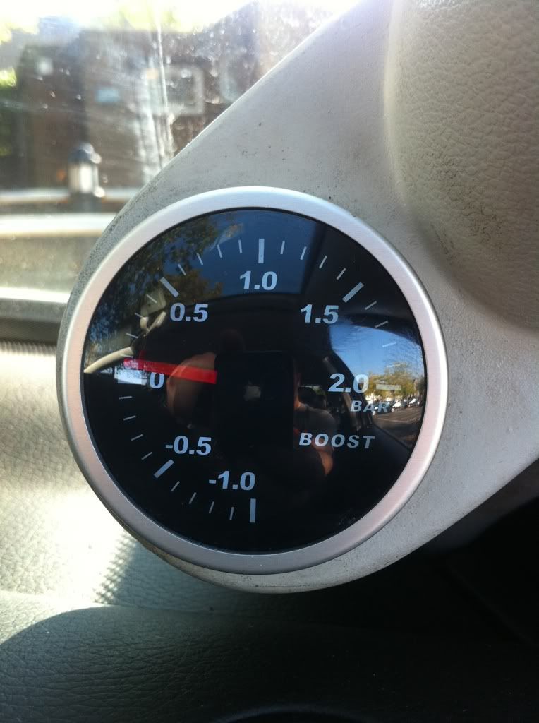

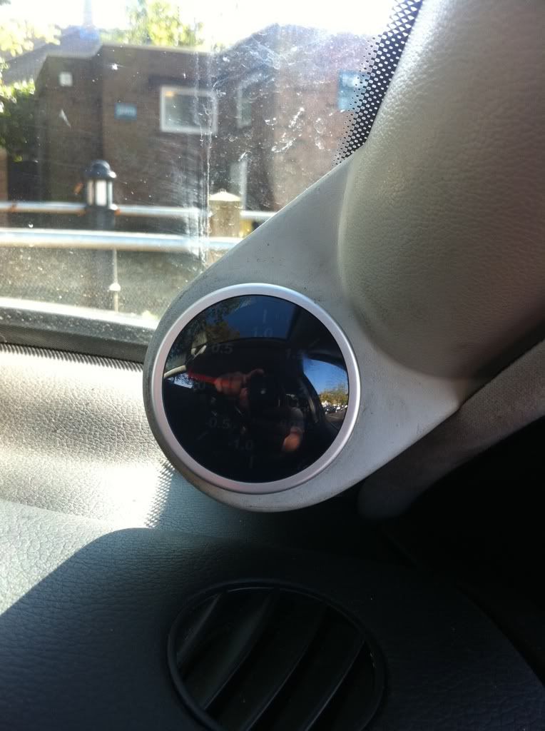

after it was all fitted ran like a dream and then i bought a boost guage and nomad pod that i was a little disapointed ith as i had to screw it down for £50 i thought it would have used the same style fastners.

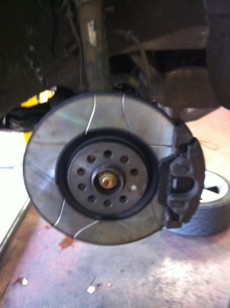

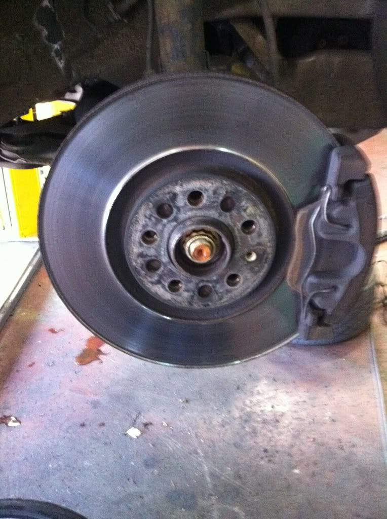

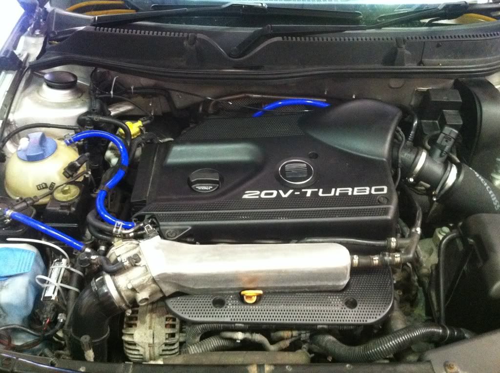

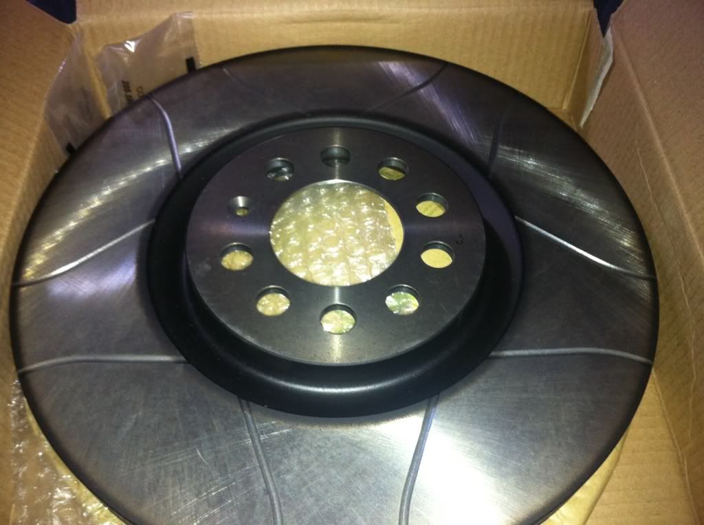

at that point my brakes were looking prittie poor so orderd some brembo discs, ferodo pads and whilst i was on the internet i bought filter and a hose kit from kellsport to replace all the top end hoses in the engine bay :funk:

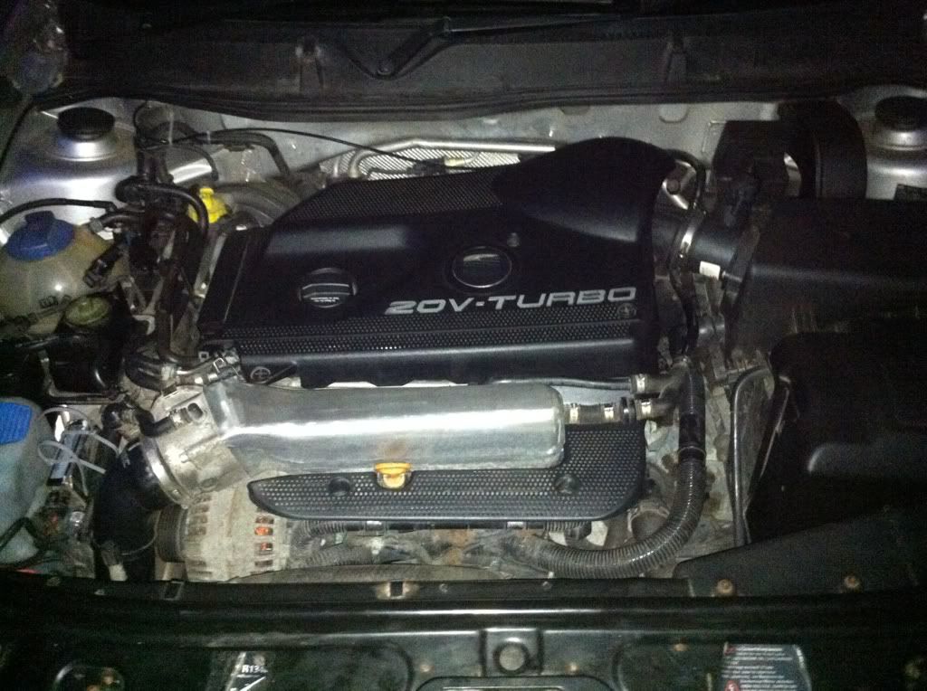

last night i decided to clean my engine bay as photos of your guys bays were making mine look terrible
lookey at what arrived today!
just waiting for the rest to arrive now :)

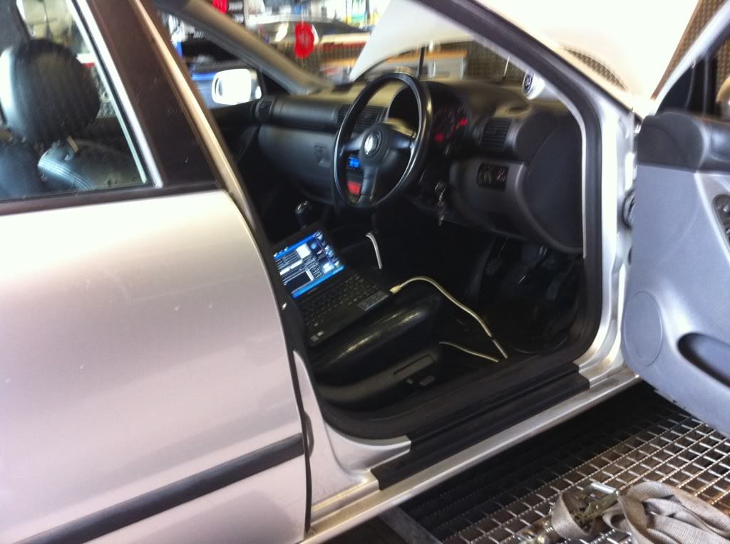

had her remaped couple of weeks ago[B)]
havent had it rolling roaded yet but the guy said it should be 205-215bhp as it has been tuned for min 97 ron fuel with the revo settings timing 6, boost 6
lloking good mate , but why do you cupra r intake and or cupra r 386cc injectors , if your planning on sticking with k03s turbo that stuff is not needed , only needed if your going hybrid and even then you standard inlet manifold will be more than adequate
I saw a guy on here running one with the cupra r charge pipe yellow LC forgot his name on here and in my mind thats a better setup that will get rid of the pancake pipe and will make it Easyer to fit an fmic in my opinion and aparantly I have to use the injectors with the mani
iv taken a photo of guage pod and guage all in

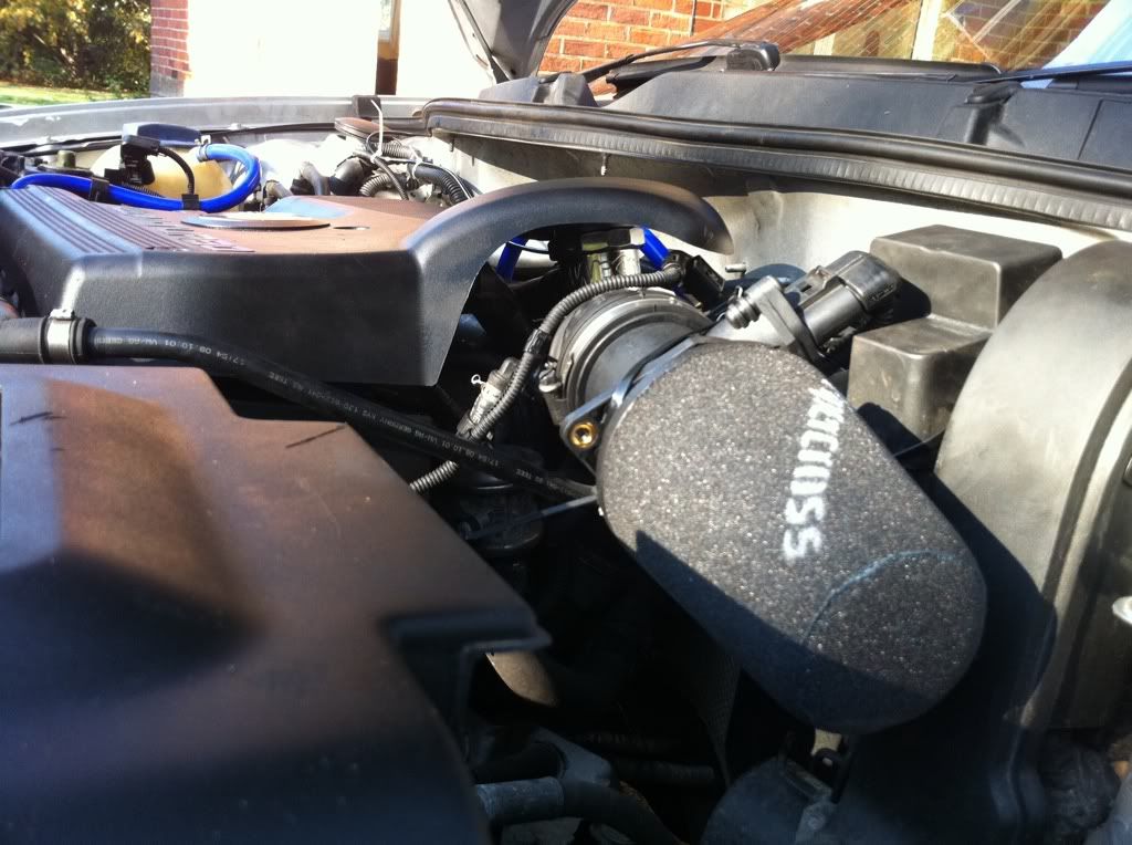

air filter, top hoses pads and new number plates arived today so i went and fitted them:
befor:
arfter:
i managed to fit a few of the top end hoses
i aslo fitted a pipercross filter i know alot of people dont rate foam filters but i got it for free brand new so i dident mind having a go and the noise is amazing!
what you guys thing of my work today :happy:
