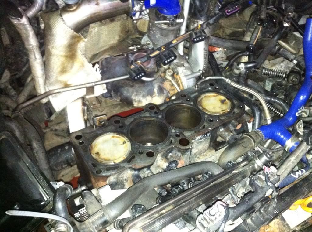

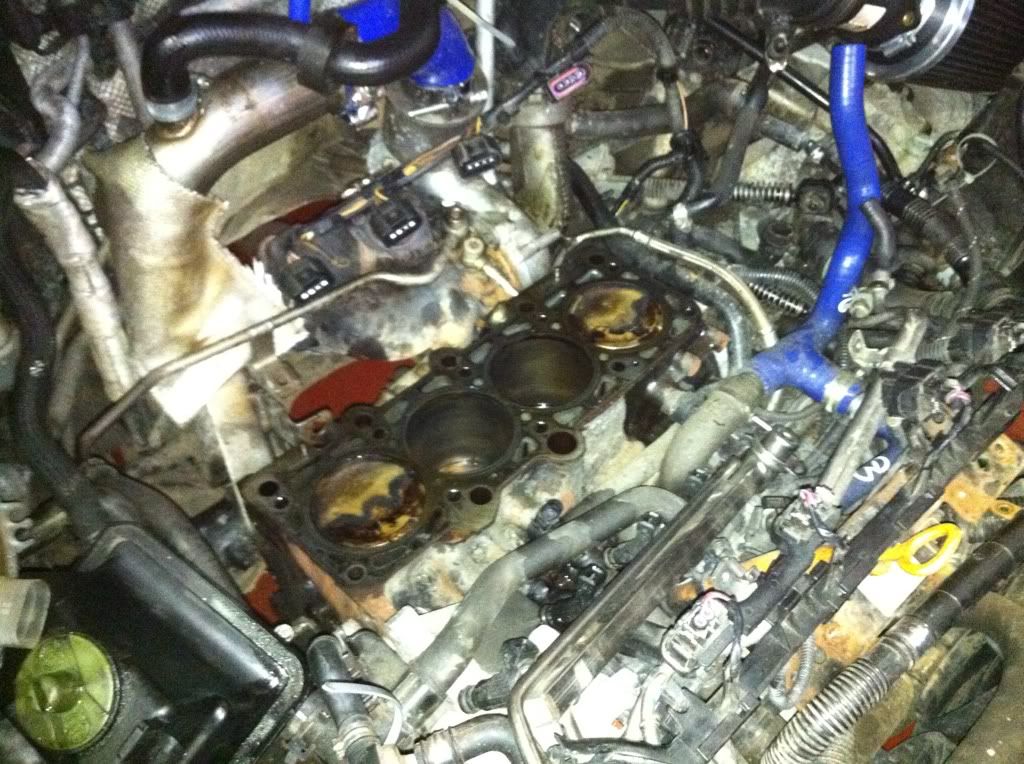

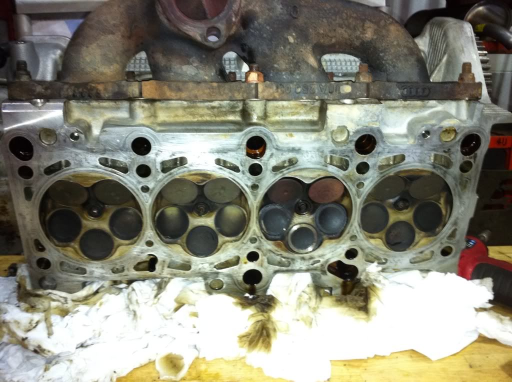

couple of photos
befor
after
and a nicley cleand head :)

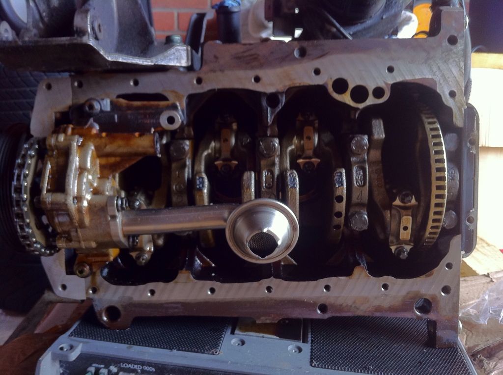

as soon as i ripped open the packaging i got straight to work on cleaning it up..

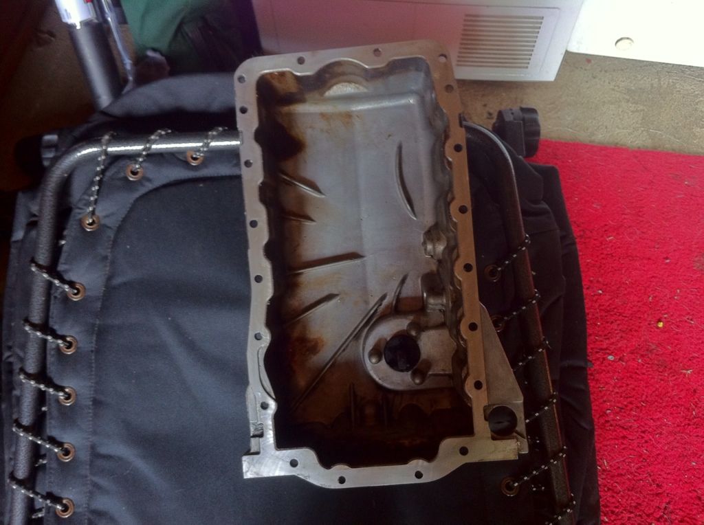

sump came off first i cleaned the surface areas and made sure the pick-up pipe was nice and clean.
then made sure the inside was nice and clean aswswell.

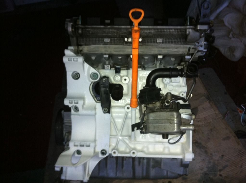

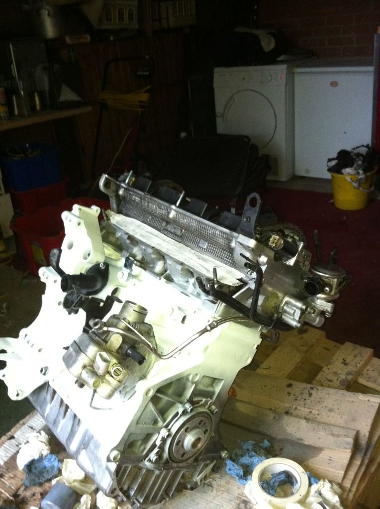

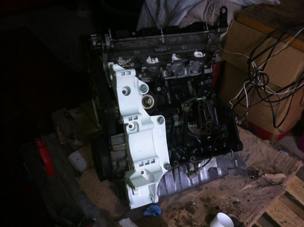

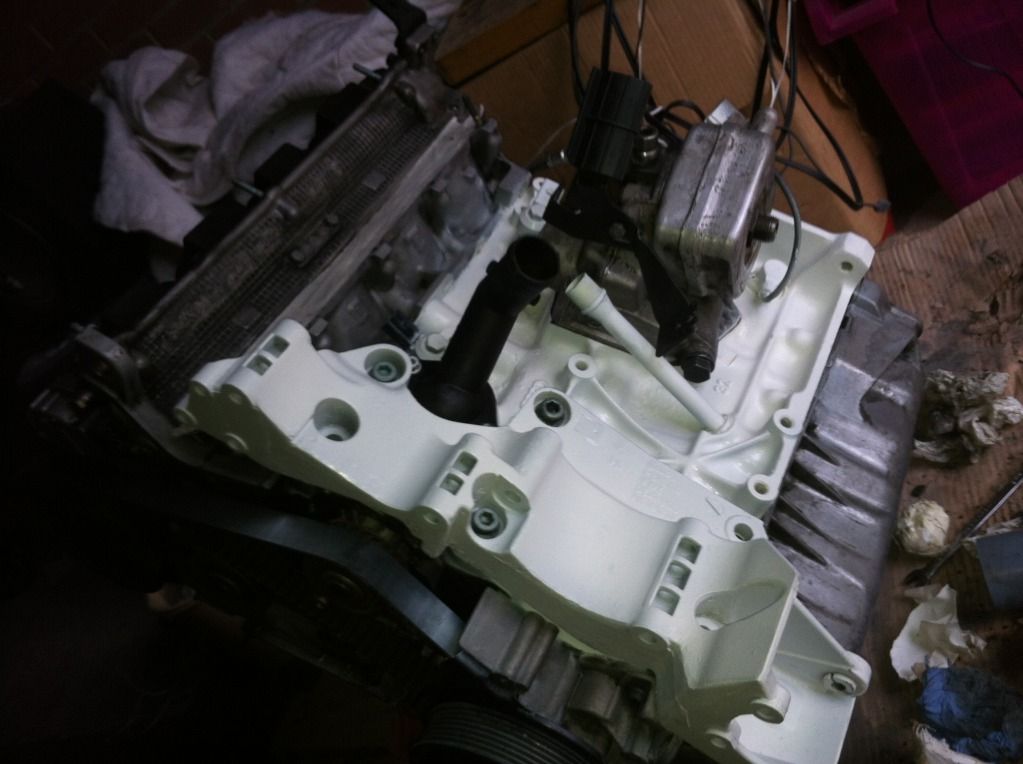

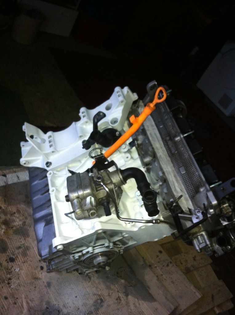

Block Painted
iv now cleaned most of the parts on the block and painted it, quite happy with how it looks shame you wont get to see any of it lol
first part I painted as a test piece
then finished cleaning the block and went for it
