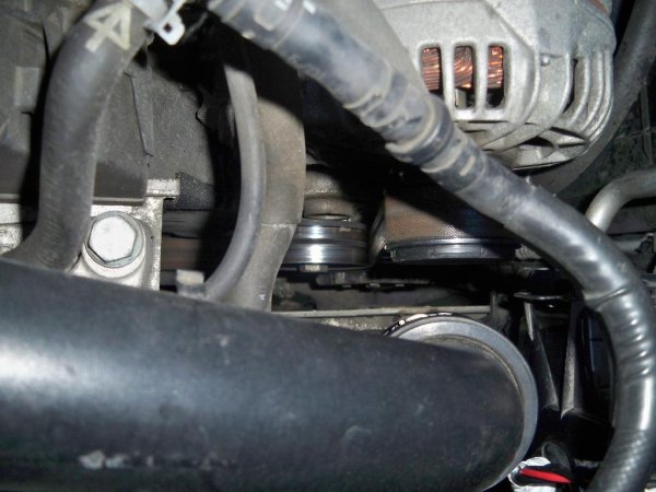

I have a tensioner on what looks like an arm.
Does it look the same?
The adjustable spanner is used to leaver it back against it's built in spring, then you stuff a screwdriver through to lock it back. this leaves the belt loose so you can then remove the arm with the roller on.
Doesn't look the same to me, looks like I have to drop a spanner down there and adjust that bolt on the tensioner to get it off?
That thing in the middle of the picture.
Looks to me like it is very much the same but fitted upside down, I reckon you will need to get under the car and then it will maybe look the same.
I've been under and there ins't anything that looks like that from memory, I'll have another look though. Thanks a lot mate :)
