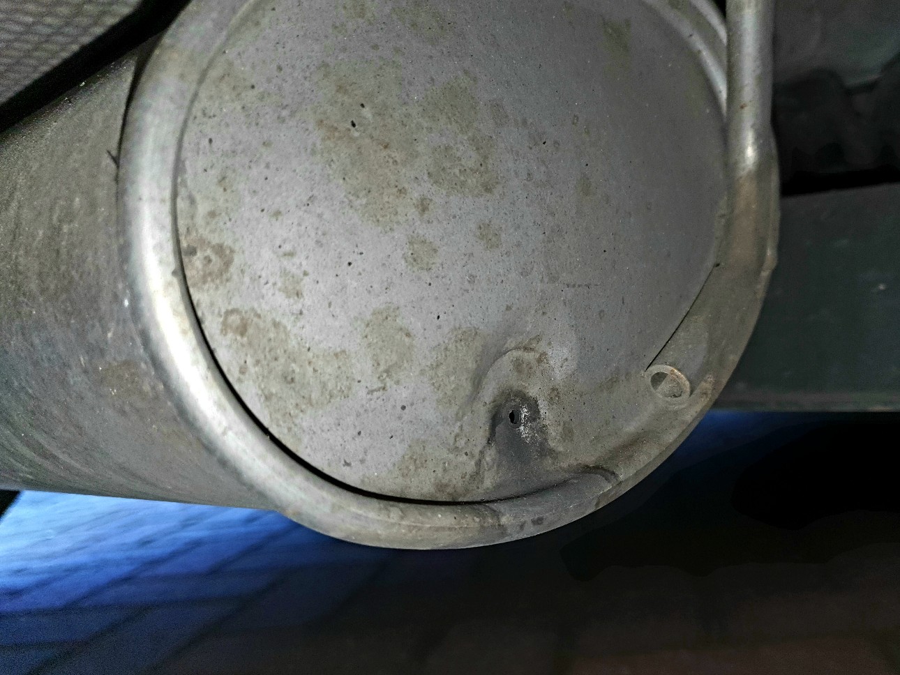

Noticed a slight blow noise from my 1.4 Tsi 150 yesterday and found this.
Its bizarre as the hole looks drilled it's that perfectly round.

It’s been discussed on various VW forums as owners have noticed they have a similar small hole. It’s a condensation drain hole, so normal.
The bizarre thing is I noticed the blowing like it was a new issue.. it's never been as audible as it is now. When I cover it up with my finger the noise goes.
I was going to fill in with holts gun gum.. but it looked such a perfect hole I thought I would raise here first
It’s normal on VW’s, so I assume it’s the same on Seat’s. Maybe other 1.4 150ps Leon owners will check their exhausts!
With it being such a uniform hole and not one that’s appeared as a result of corrosion, then it’s almost certainly meant to be there, so I wouldn’t block it up.
