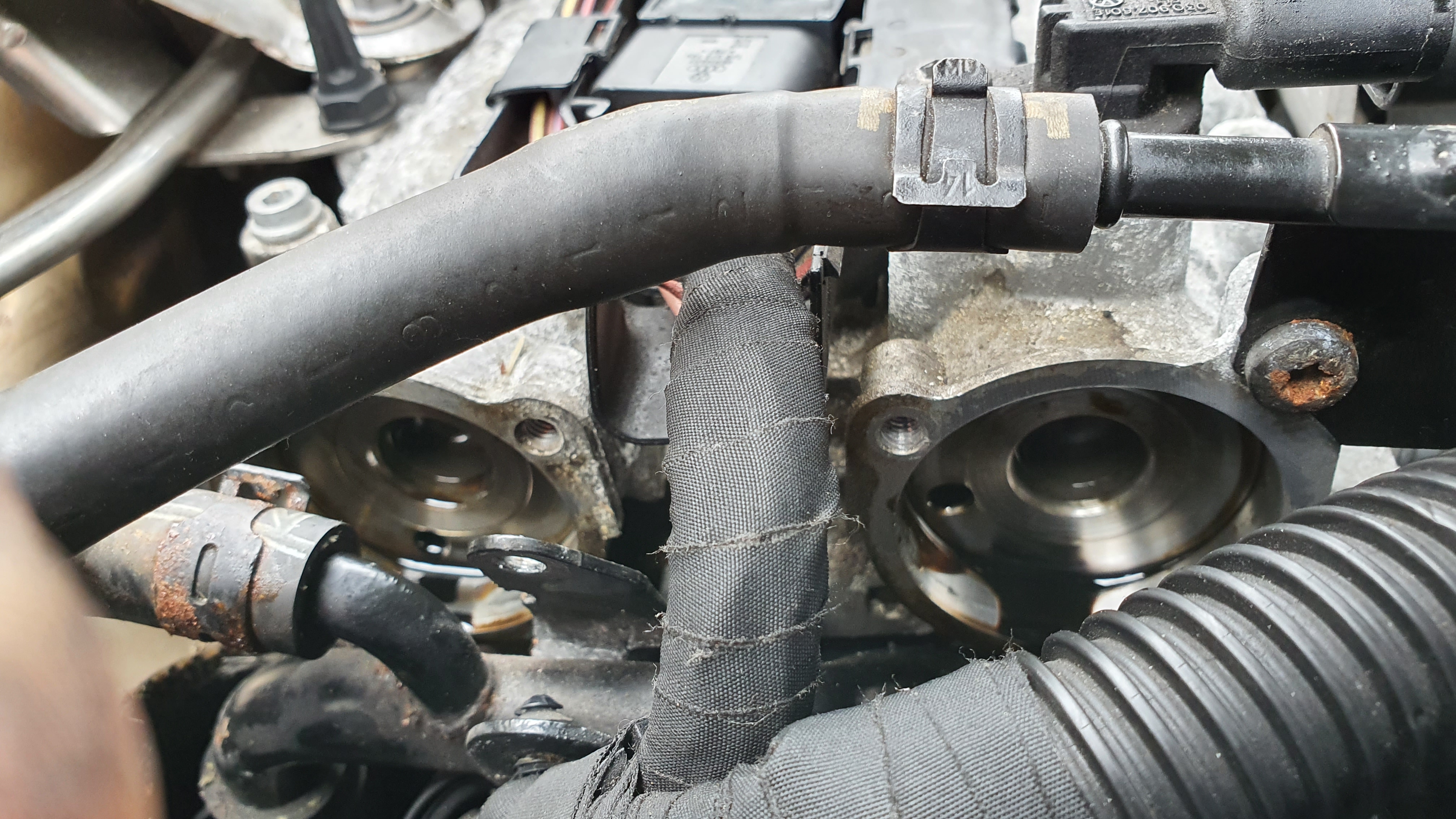

Removed No1 spark plug, then put a 1/4" drive extension down to rest on top of the piston.
Rotated the crank pulley through clockwise until the extension at it highest point before dropping down then looked at the cam ends location holes. They were opposite where they are supposed to be. So rotated the crank again until again the extension was at the top of its travel. Then took another look at the cam ends location holes ((the picture above is of that).
Looks to me asthough the inlet cam (rear) is not far off where it should be. Yet the outlet cam (front) seems to have slipped.
Obviously something went wrong with the cam chain tensioner that's allowed cam slip. Will this have bent valves?
Looks like possible head off, new valves, head gasket, cam chain etc....
My next question... if the valves have being bent, will that force damaged anything below? Controls etc....
I would personally doubt that as I assume valves are not as tough as conrods etc... but your knowledge on these cars is far greater than my own.
Any help or thoughts would be appreciated
