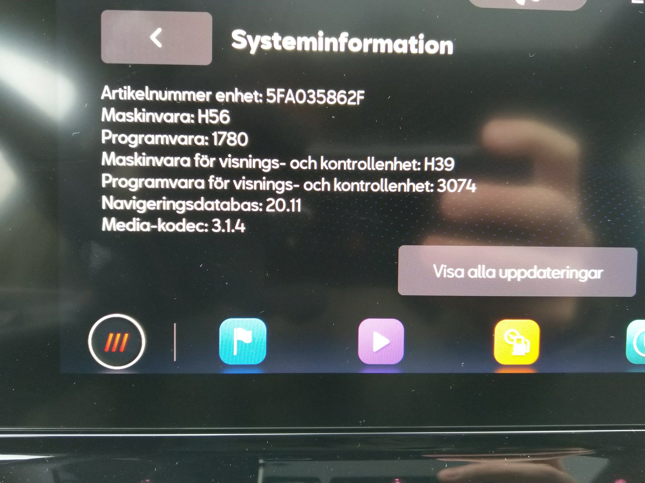

Checked SW version in my eHybrid:
Have noticed some issues:
- Keyless acces does not work. This is a known issue that will be fixed in a later version.
- Sometimes navigator and compass are not started in the Digital Cockpit.
- In the navigation settings, POI selection list are in german

I agree, keyless and foot swipe under rear bumper doesn’t work. Qi charger works sometimes, usually gets aborted after ~30 seconds. A variety of unmotivated warning signals coming and going, e.g the parking brake. CarPlay issues.
