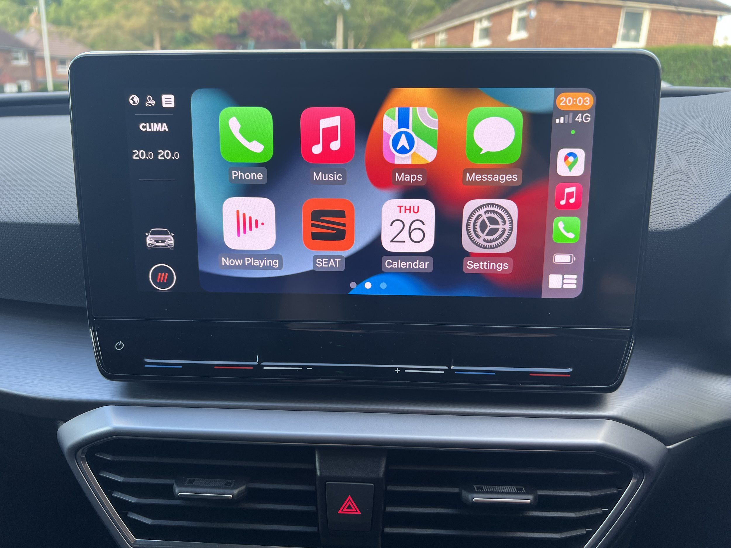

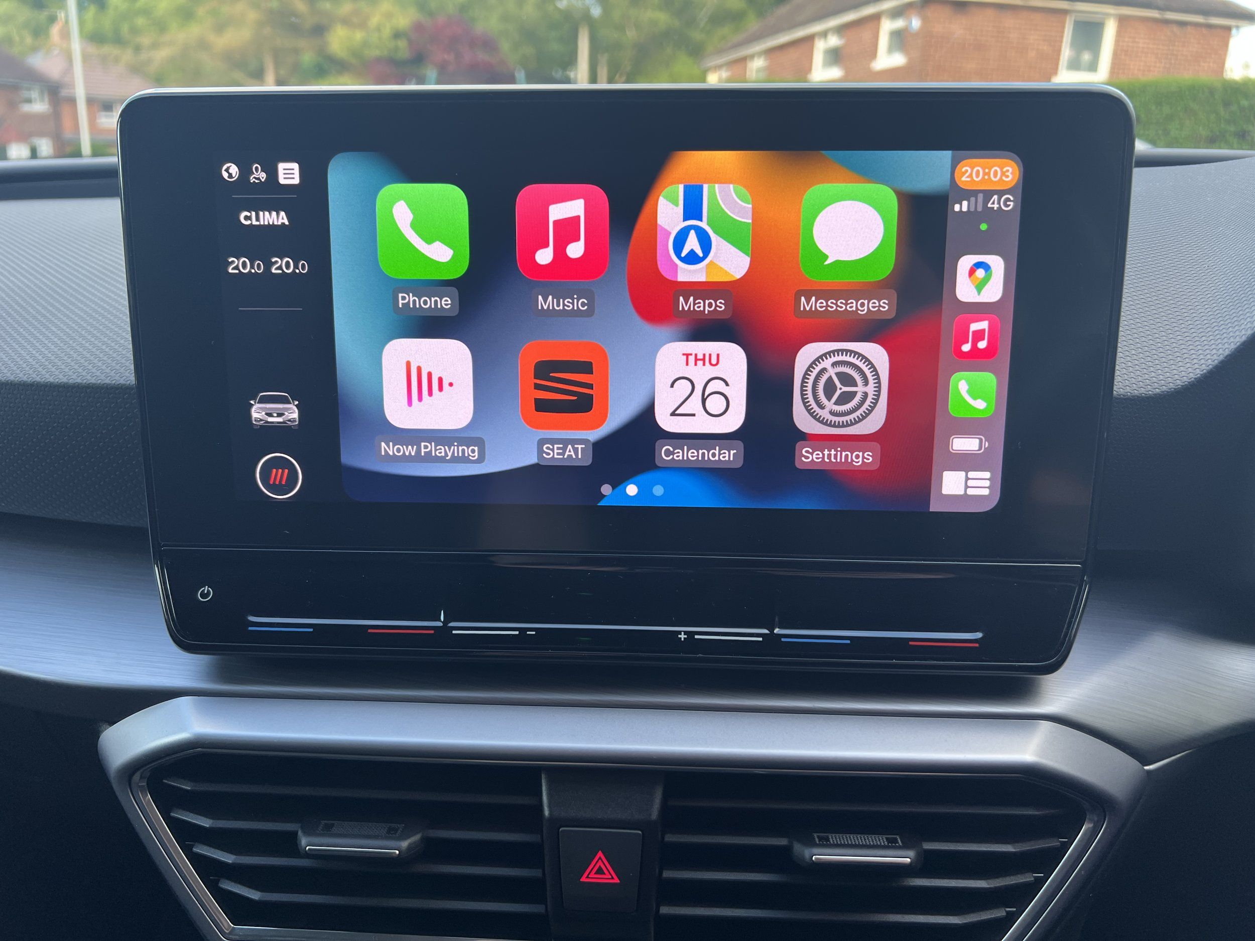

Got my car back from the dealers today and I must say, the update has put a smile on my face ? it’s now how it should have come out the factory!
Bigger CarPlay screen
Audio is a lot louder, not sure if everyone had this issue but my sound was crap! It was like it had some sort of speaker protection is how I can explain it.
When flashing the main beam, they now points higher so people can actually see them. Again, not sure if everyone had this issue but when you pull to flash, the motors lift the lights just like when putting the main beam on properly.
Drove for around an hour or so and no SOS, globe or pop/crack from the speakers so all looks and sounds promising!

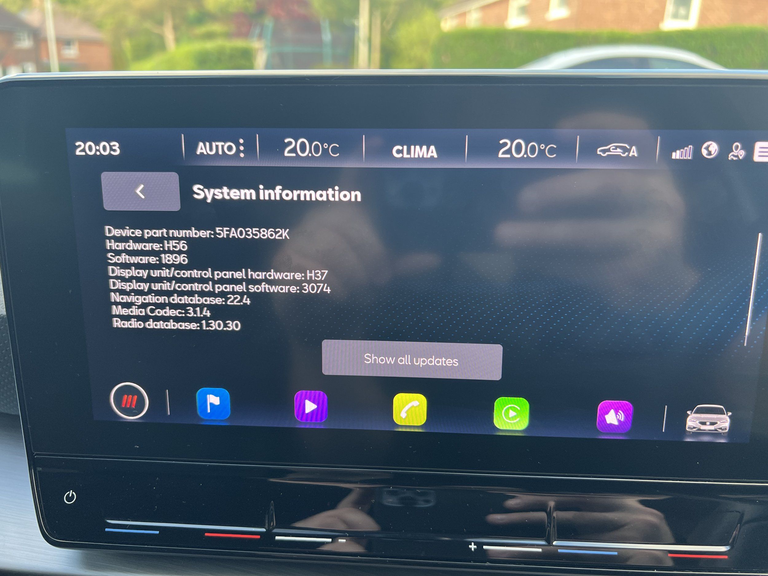

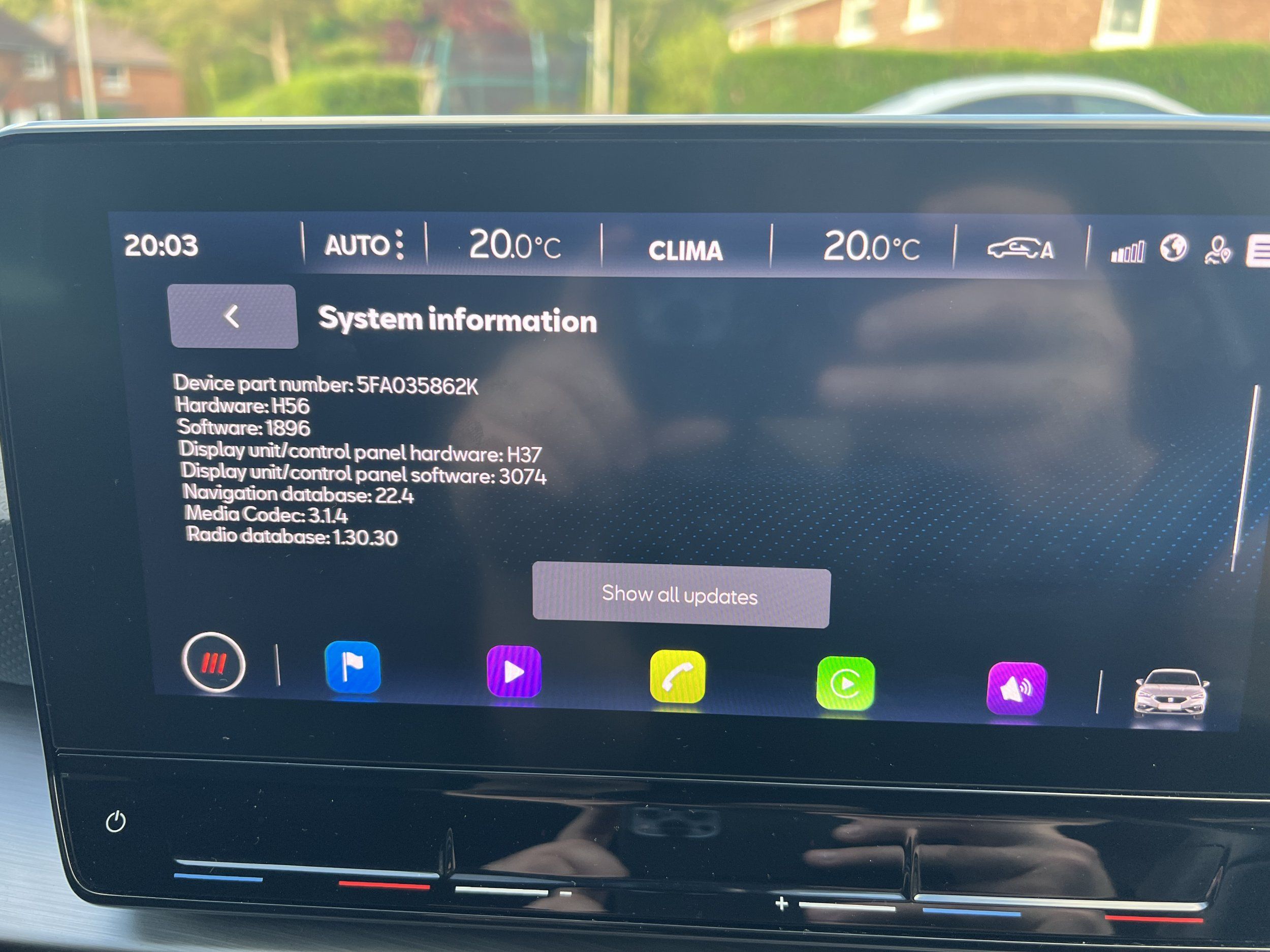

View attachment 31954View attachment 31955

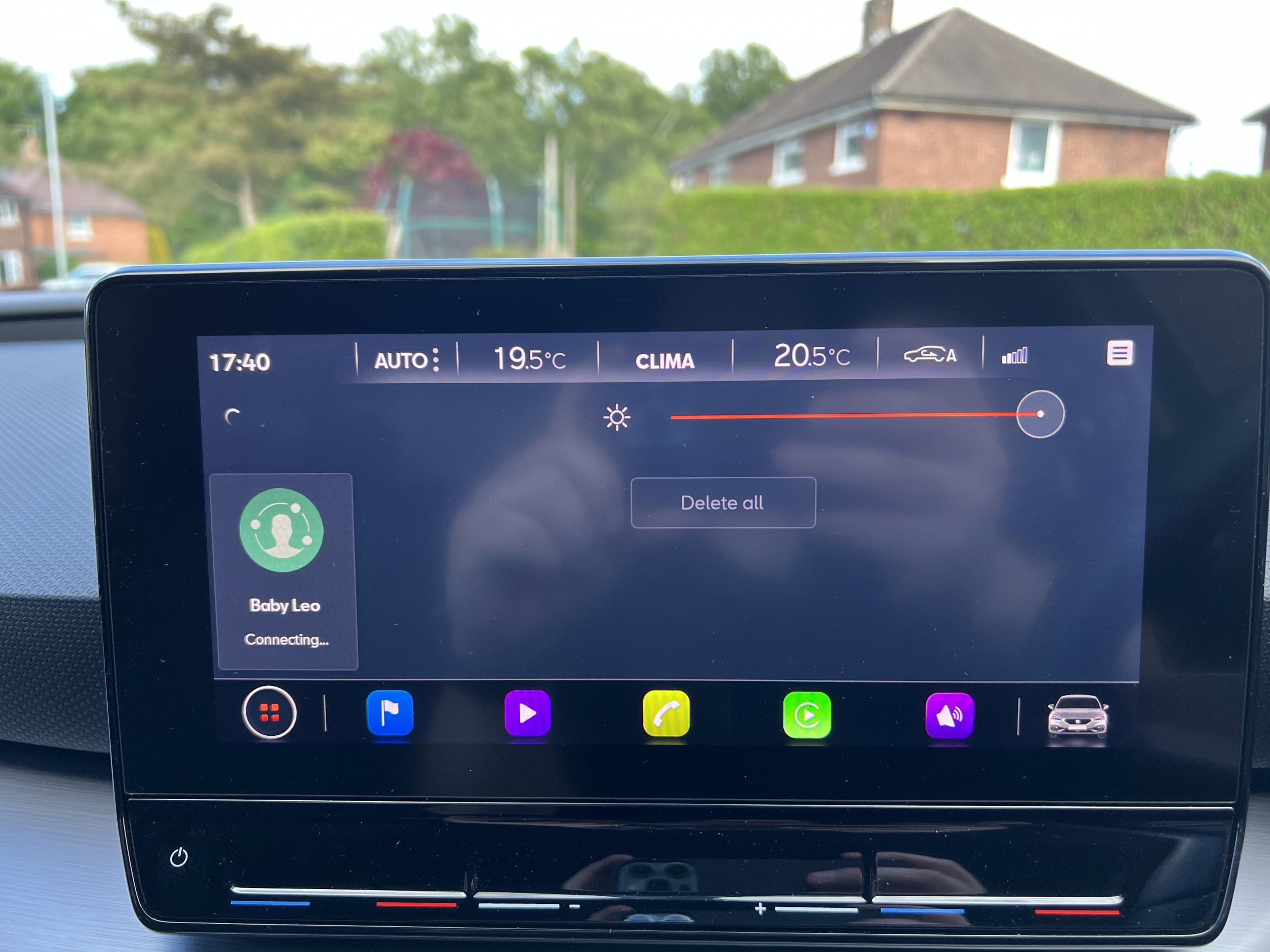

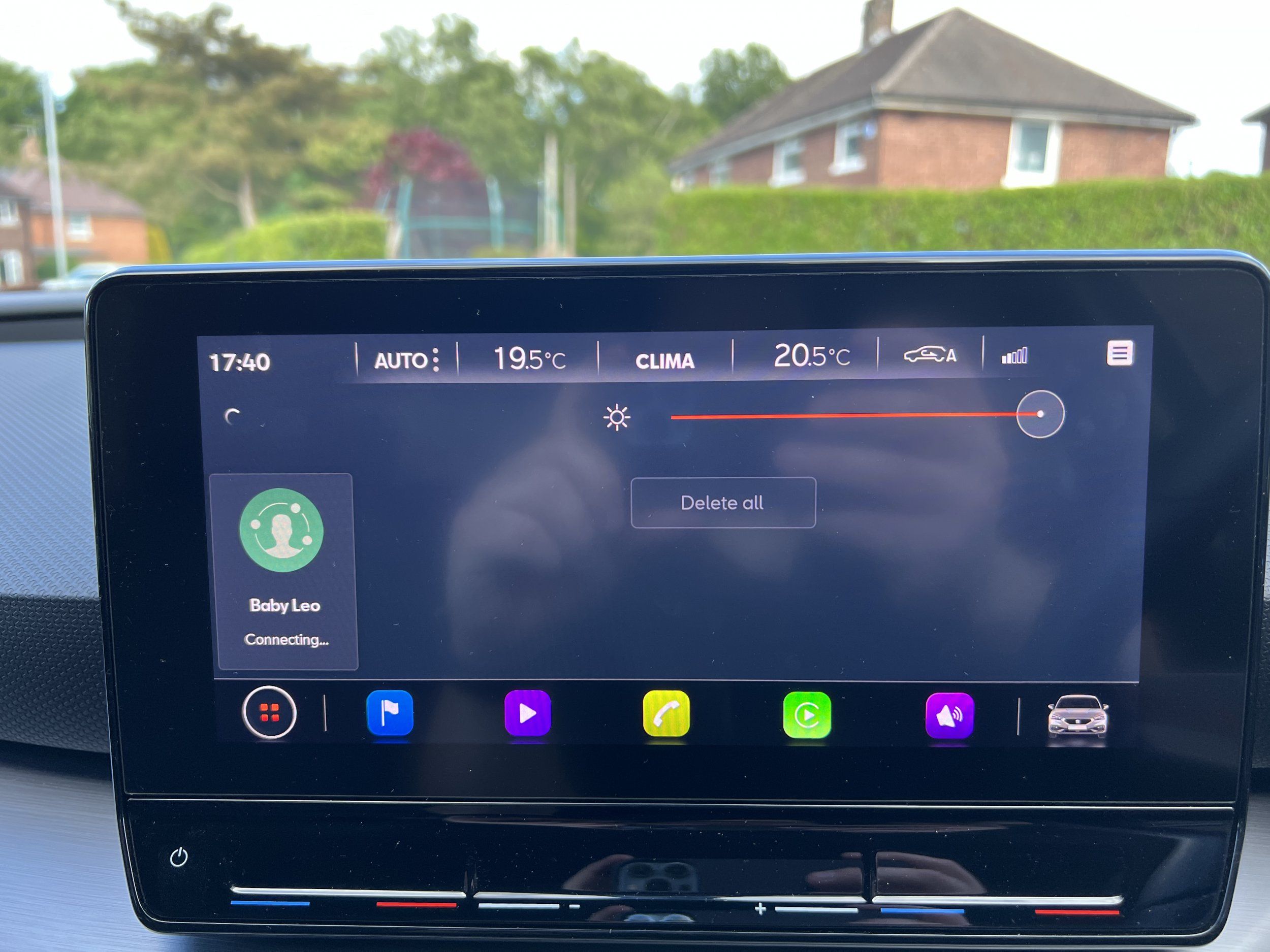

spoken to soon….. the globe has gone and won’t load driver profile ? just keeps saying connecting
Hello all,
So for update my car with code VSS ZZZ KLZ MR from the 1672 to the 1896 I need to go to my dealer? With the 1896 the infotainment works better?

Yes, dealer update.
move noticed a massive improvement. Apple CarPlay, headlights, SOS etc. no issue since the little hiccup after the update.
it did a few OTA updates a day or so after the dealer update.

I have the same problem with the user. I tried to delete and add again and it just pops up, "This is currently not available"
I also tried to set up a new profile and the same. There was a problem with S-PIN.
The only thing I do not have in my LEON, and in a replacement car (LEON MK4 2022) I had a new Virtual Cocpit theme and the Seat car icon was colorful there, and here I still have a blue one.
Regarding the user issues, I believe it has something to do with the privacy.
Don't remember the exact path, but if you lower the privacy settings you should be able to connect.
