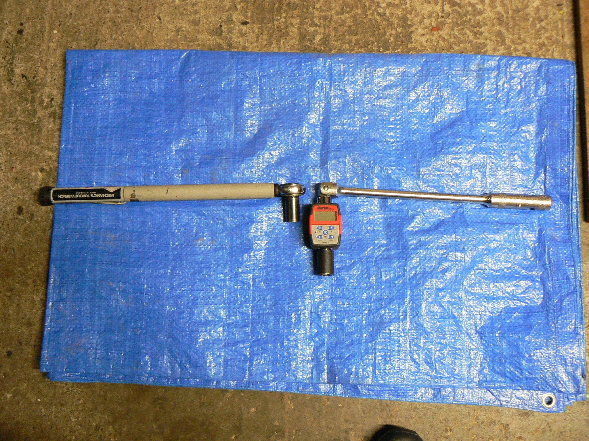

One thing I really do like it for is checking my other wrenches for accuracy. Here it is plugged into an old O2 sensor socket in my vice and the Britool on top:
Set the scale to "ranging" and as you pull on the wrench the scale displays the rising value. just watch for what it's showing when the wrench clicks. repeat a few times for accuracy. Of course, if you are using it for actually torquing a fixing, I prefer to have it set to the required figure and listen for the audible warning as that figure is achieved.
So now, the big old Britool is simply an impressive ornament on my tool board. The smaller Britool I bought all those years ago spends most of it's life resting in my tool chest, ready for duty "just in case". So these are the "friends" I use all the time:
