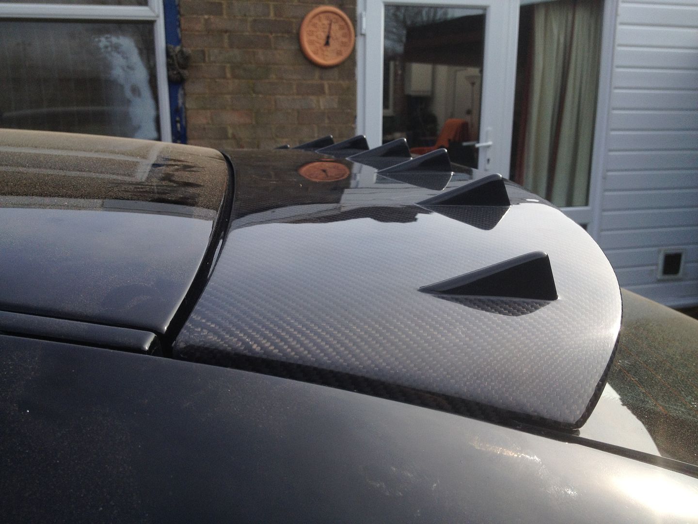

:whistle: Looks a little like the right side didn't fit perfectly ?
Did the original spoiler maybe bended more easy along the sliightly curved window then the carbon one ?

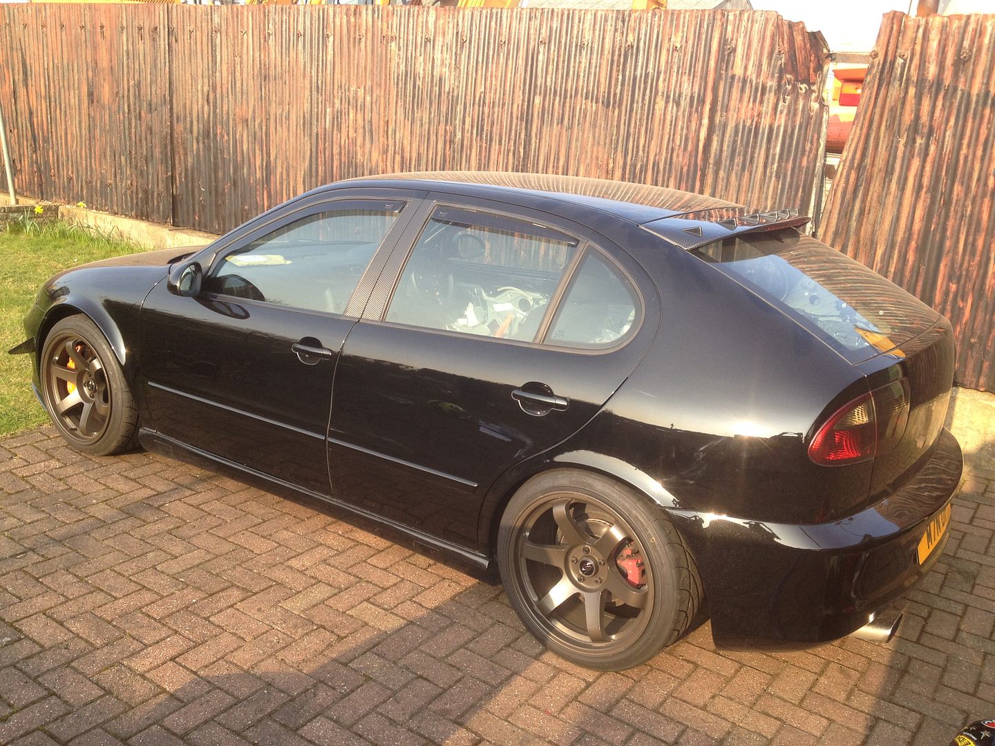

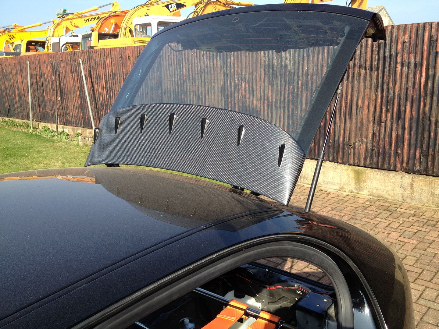

It's looks cool. I expected a huge spoiler, seeing it down on the floor. But when placed it looks really nice.
Its the same size as the standard spoiler , it might not be bolted Down fully kinda put it on and was more worried about getting my seats sorted , will have a look tomorrow

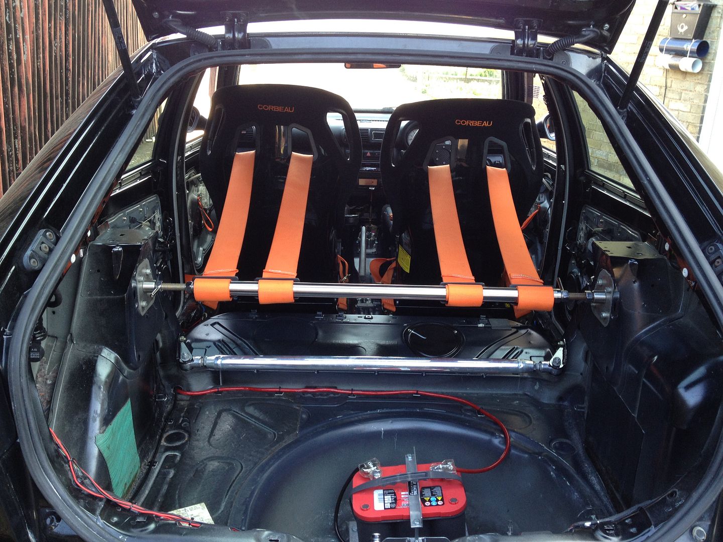

Seat belts on a strut brace are a big no no, they don't have the strength in an accident compared to a big piece of T45 steel tube.
You'll rip the threads clean through at that angle & carry on until your chest bends the steering wheel.
With your current setup, you'd be better off using the original belt mounts, or an i-bolt setup until your cage is fitted
Yer I have an extra door bar to go across the back part of the cage won't be long till its in and fitted , feels like my car again there really comfy as well :)
