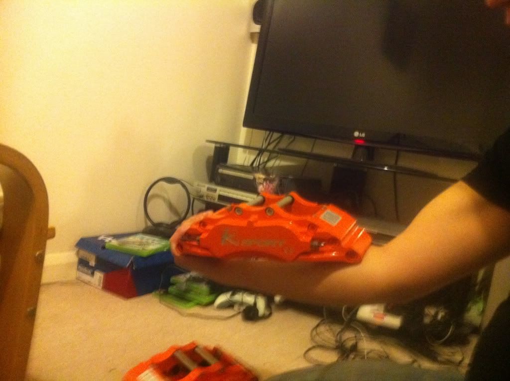

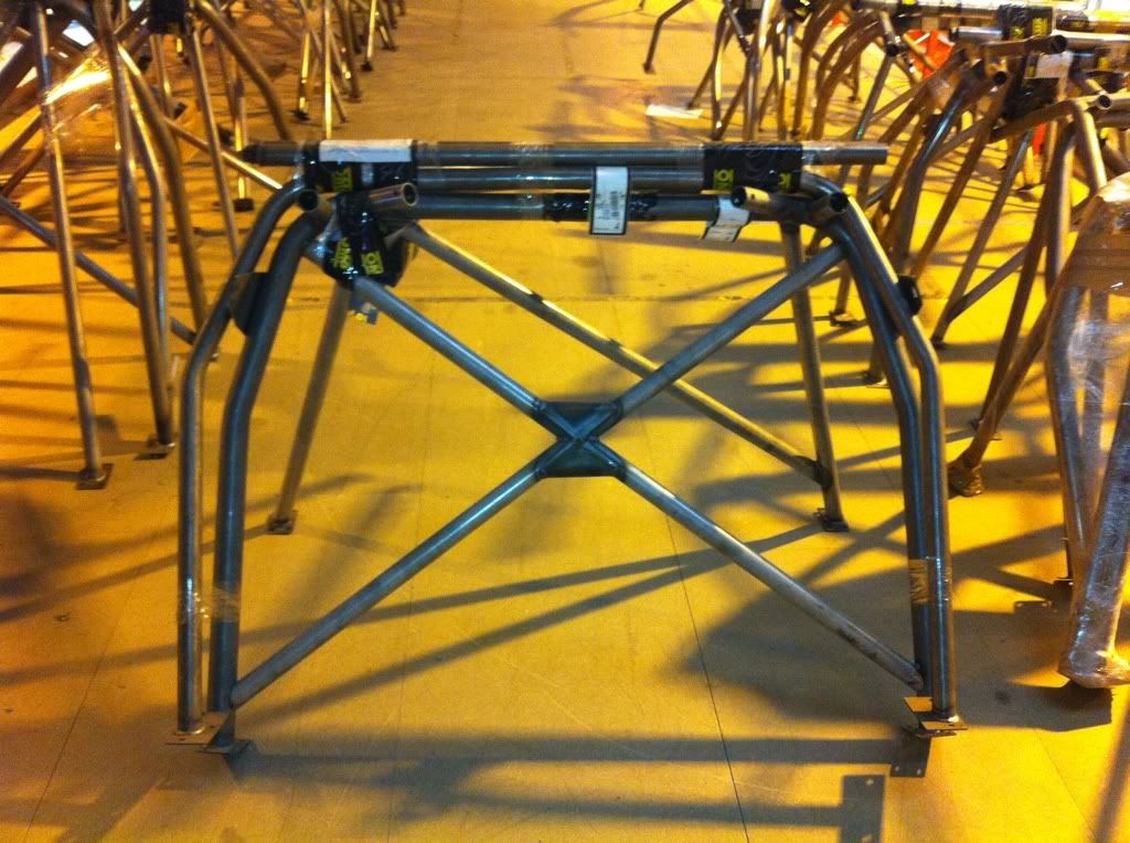

Any way today I paid for my cage will be here Monday , This one

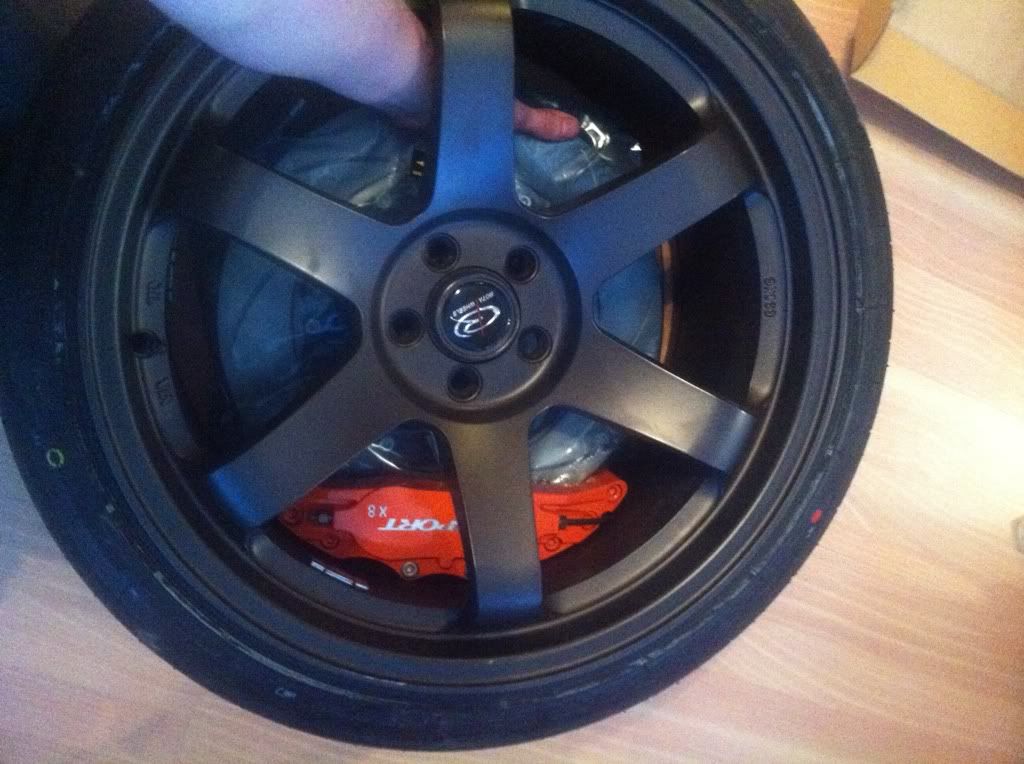

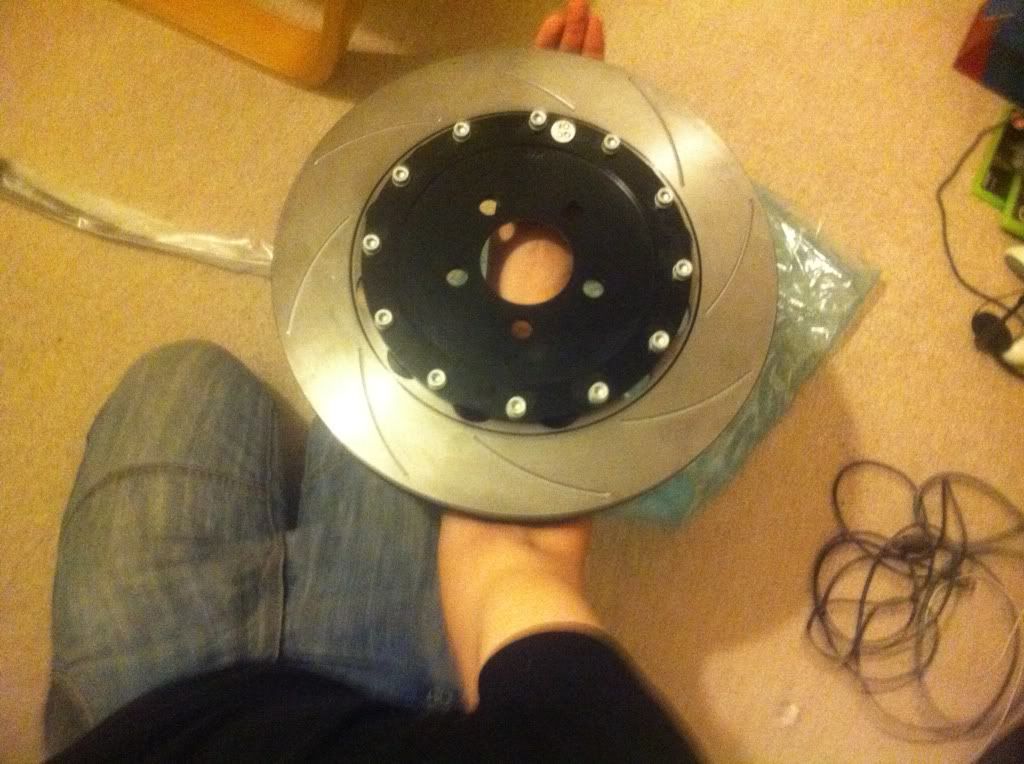

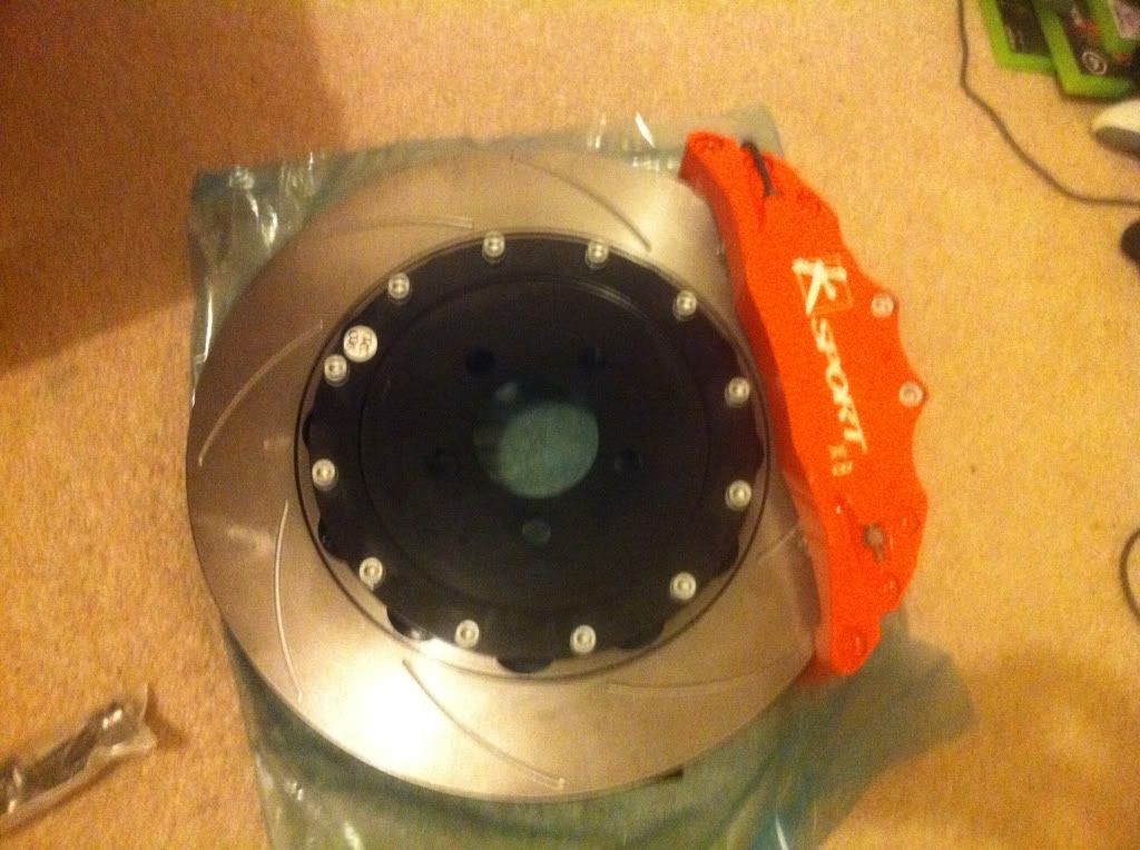

These few bits came
Oh and these baby's :)
Prawn believe me it's a road car more than track lol I want it to look mean and think I will pull it off I will be doing track days as well after a few shows and the weather is better :)

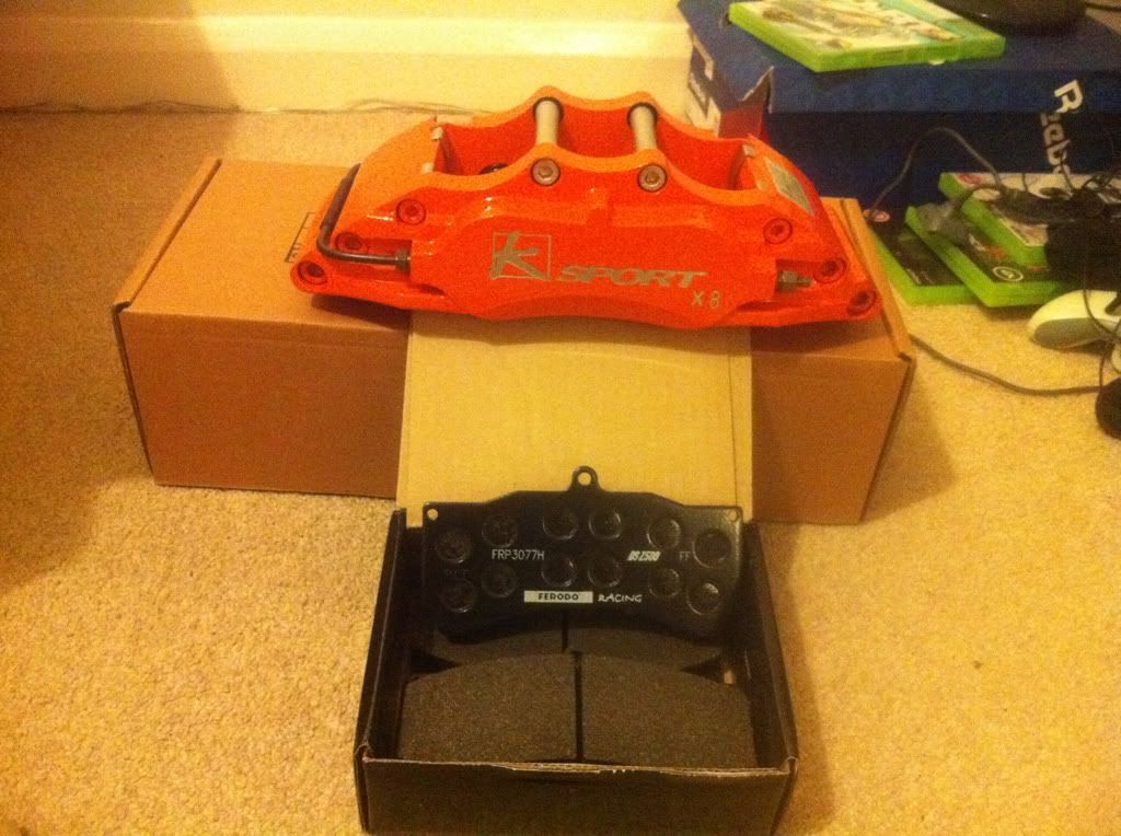

We are using the same pads.
FRP 3077H
6pot and 8 pot use the same pads ;) 330 and 356 :)
same pot design etc etc.
Make sure you clean well those bleeding valves once you install them as the paint on those callipers aint that great and it will peel off in that area.

It's the same cage as prawn looks **** in that pic will be here Monday tho :) I've just ordered some fluid rbf600 can't wait for the car to be done now
