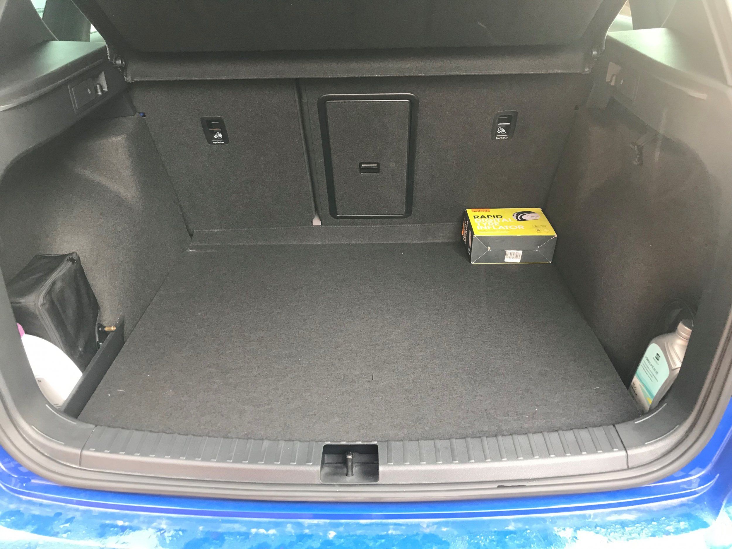

I have a 2017 2.0 TDI 190 4Drive. It came with just a thin piece of carpet and a round piece of foam in the boot when I bought it.
I ordered a spare wheel kit from the same place as you, Caffyns, for £340. The part number for the kit I ordered is ZGBBOM235SE.
It will arrive in a few separate boxes. You get a space saver wheel, jack/tools, foam surrounds and a new boot floor. There is absolutely no modifications required to fit it, just goes straight in and fits perfectly.
You lose a bit of boot height, but I prefer this as you have a flatter load area with the rear seats down.
Mine has already saved my bacon when I recently got a puncture.

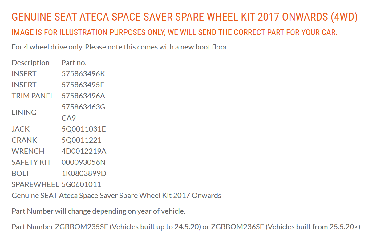

I have noticed though the kit part number is slightly different so some of the parts must be different?
Yours ZGBBOM235SE.
Mine ZGBBOM242SE.

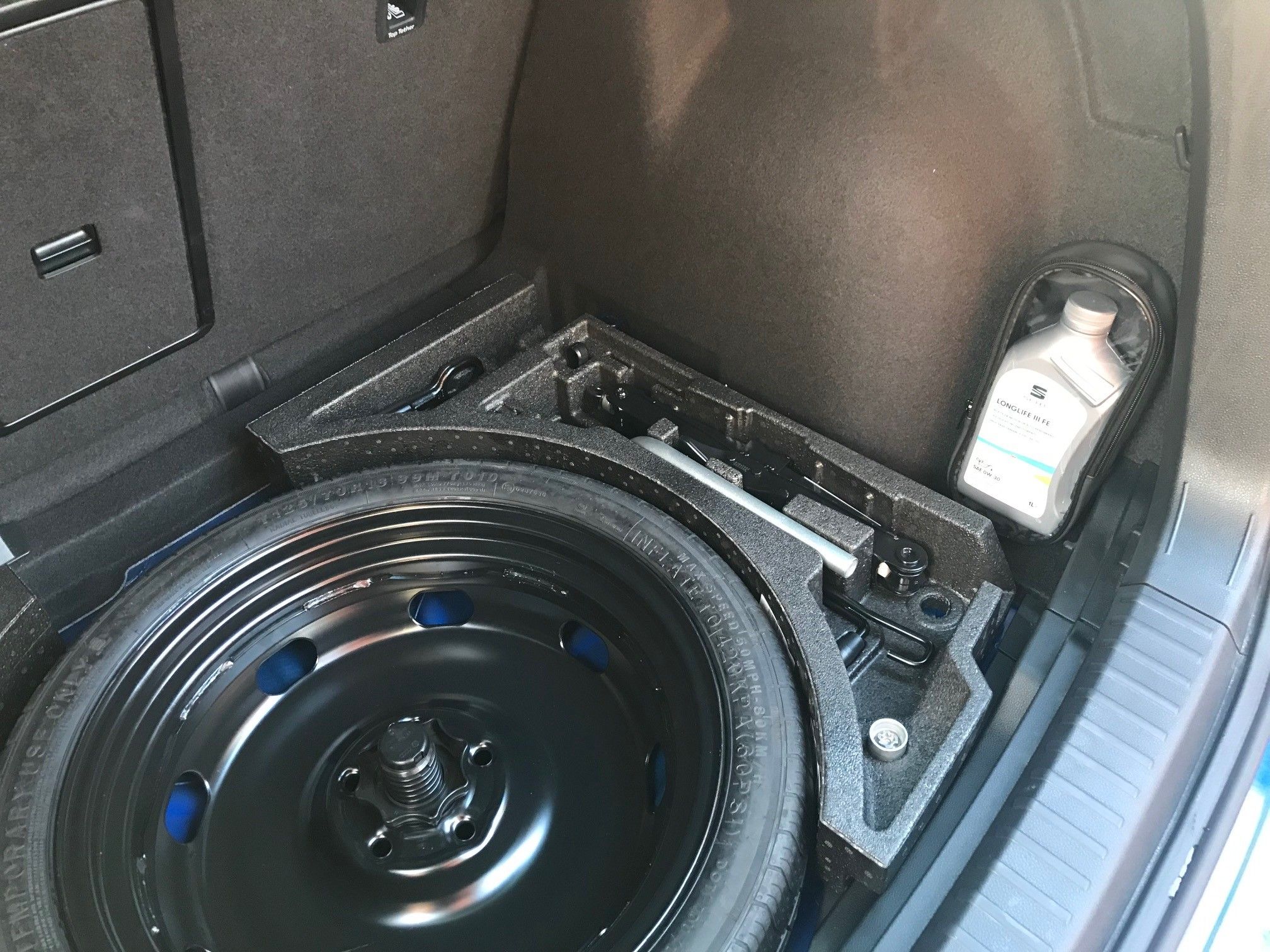

My excuse for not digging about in the boot is sciatica have to be careful I don't trigger it off, however I did have a peak underneath today and yes the floor panel does just sit on the plastic mount form. My old Altea I took a traditional 32" cathode ray tube TV in the back on the platform. They are stronger than you think.
The other secret is where the locking nut goes. That's shown in Little John's picture in its own cubicle in the moulding. Bottom right. That's where your tyre place expects to find it. Those spare wheels have an expire date on them but I wouldn't worry about that. Only boards do. ?

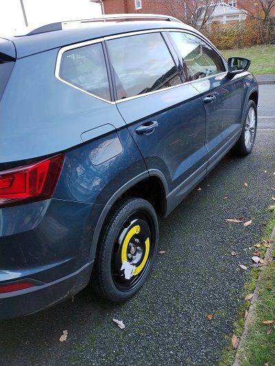

I found my tyre flat on my driveway, so didn't actually drive on the space saver, just fitted it so I could take my wheel to the garage to get plugged. Still very handy to have though. I also like all the storage space in the foam inserts. I carry loads of spares in there (fuses, an extending wheel brace, electric tyre pump, water, high viz vest etc).

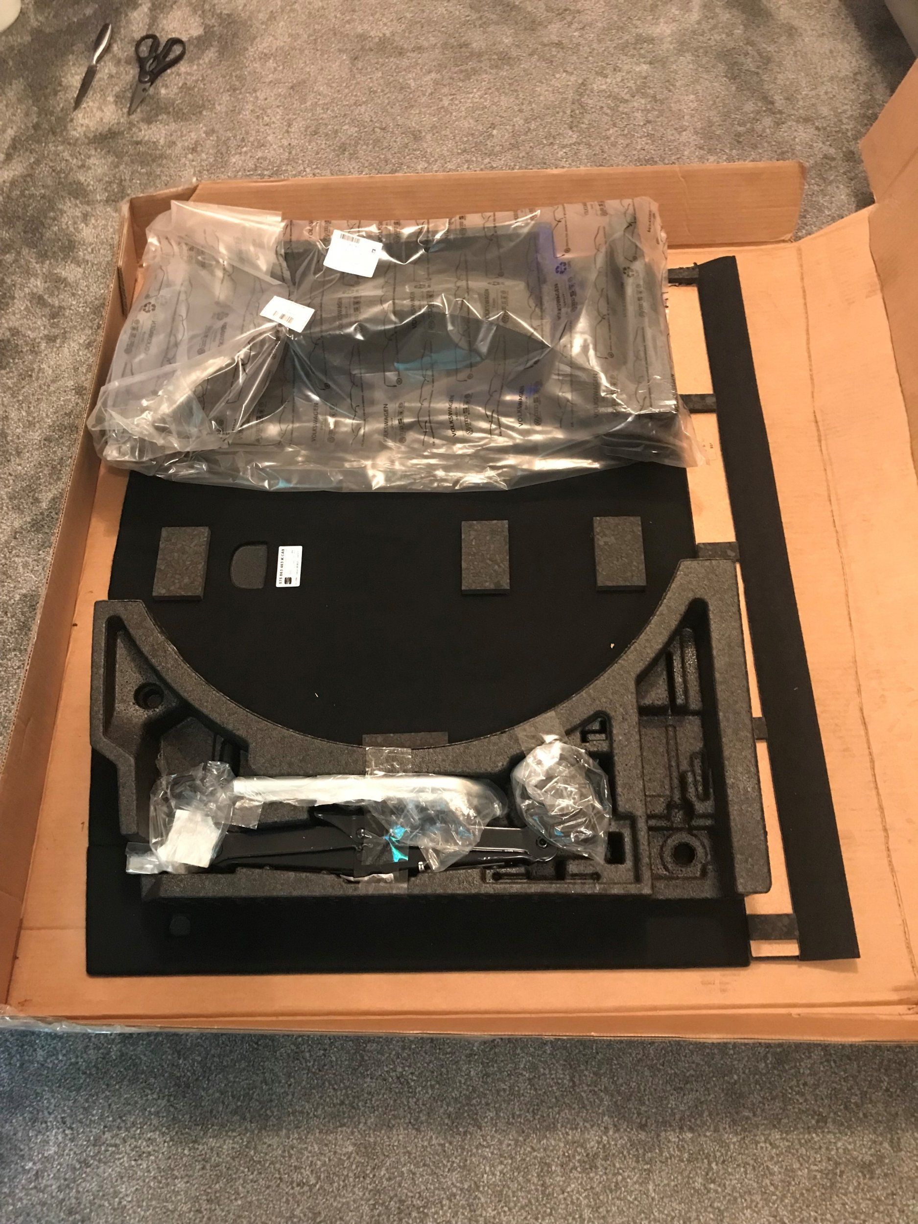

Hi Andy
I would have had it off you if I had not already ordered mine.

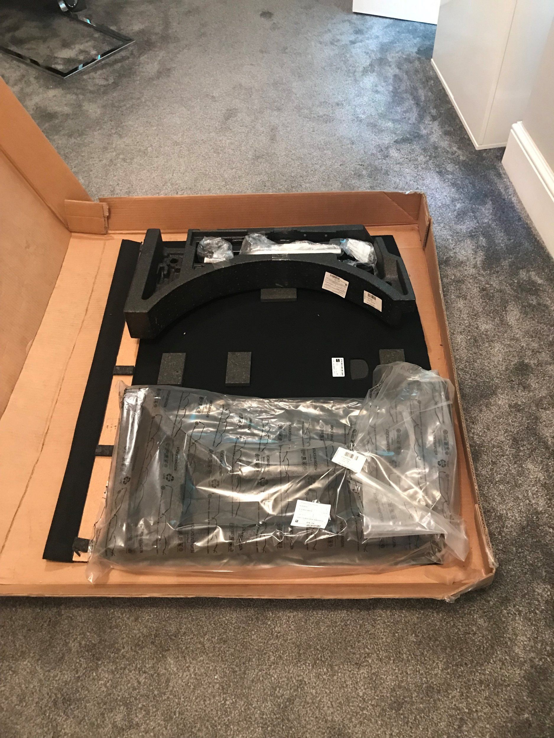

The rest of my kit followed a few days after the spare wheel was sent.( see attached)
Will post some pictures once I fit it this Friday in the car.
Hopefully it all fits in fine. Seems to be only the variable floor that needs the brackets and finding the holes.
Hi Tell
Looks like you remove the original carpet and slim piece of foam and bolt the wheel down.
Put the two foam inserts in either side, one which houses all the tools then you just sit the new floor on top.
We will find out on Friday.
Will post pictures plus the receipt which shows the individual parts.

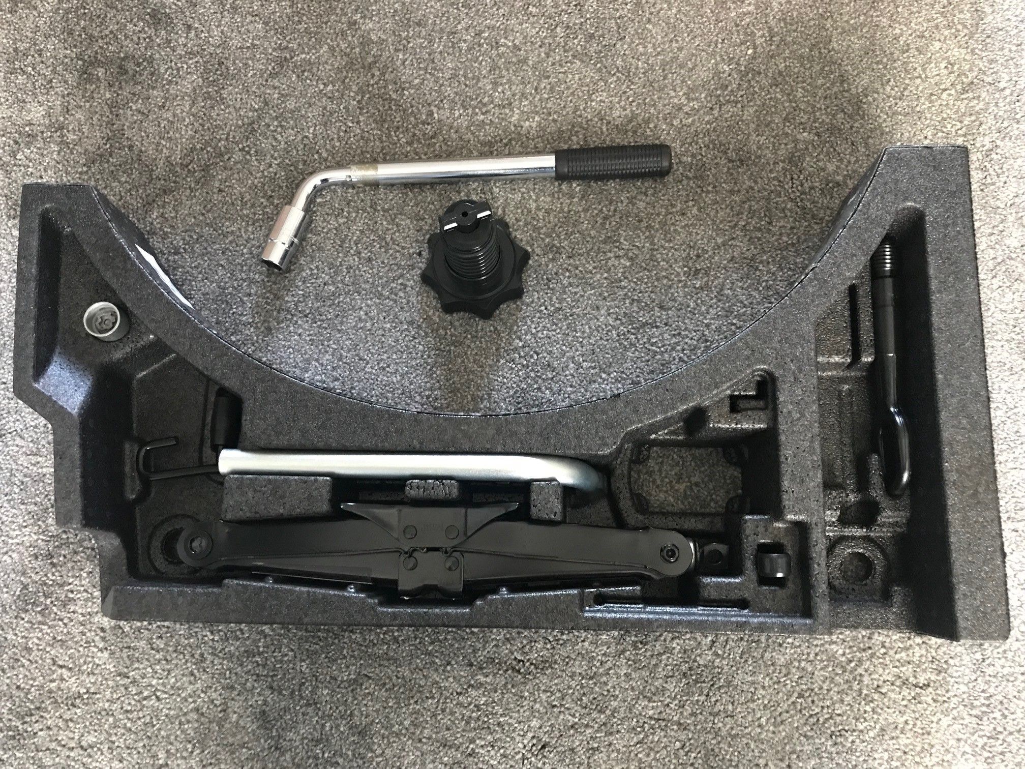

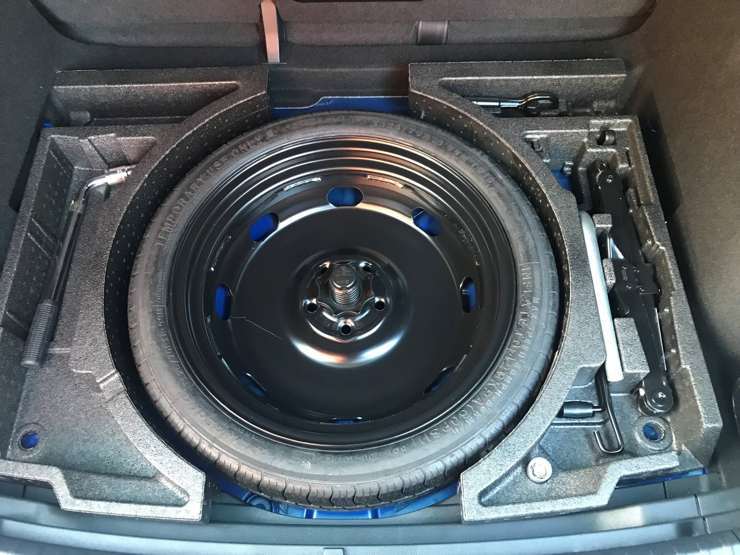

Good evening all
So today I fitted the kit and this is the procedure.
Remove the thin carpet and piece of circular foam.
Put the spare wheel in face down and bolt down using the supplied plastic bolt.
Put both foam pieces in either side of the wheel.
I put the towing bar eye and locking wheel nut in the space provided in the foam.
Put the new floor on top of the foam. It just sits on top.
It is probably not as strong as the original set up if you were to put something very heavy in the boot.
You also loose about 140MM of boot depth with the kit in place. (See attached photos.)
I have included the receipt which details each part in the kit ZGBBOM242SE for the Cupra Ateca no sound.
The kits are all priced differently depending where you buy from and by a lot!
Note: The adjustable wrench is mine which I have put in as the supplied one is quite short.
Hope this helps anyone requiring a space saver kit for their 2019 Cupra Ateca without Sound.:cool:
I have used the original thin carpet and placed this on top of the new floor like a cover.
Karl

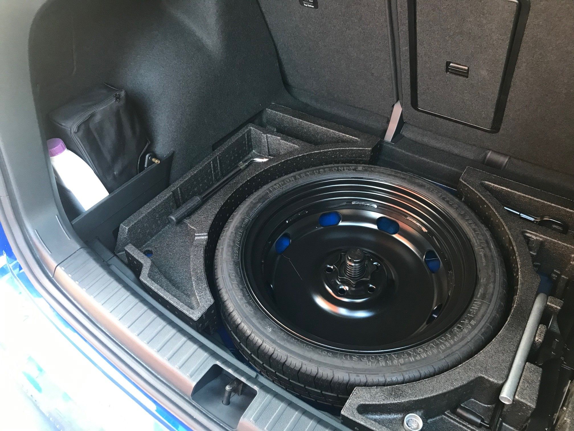

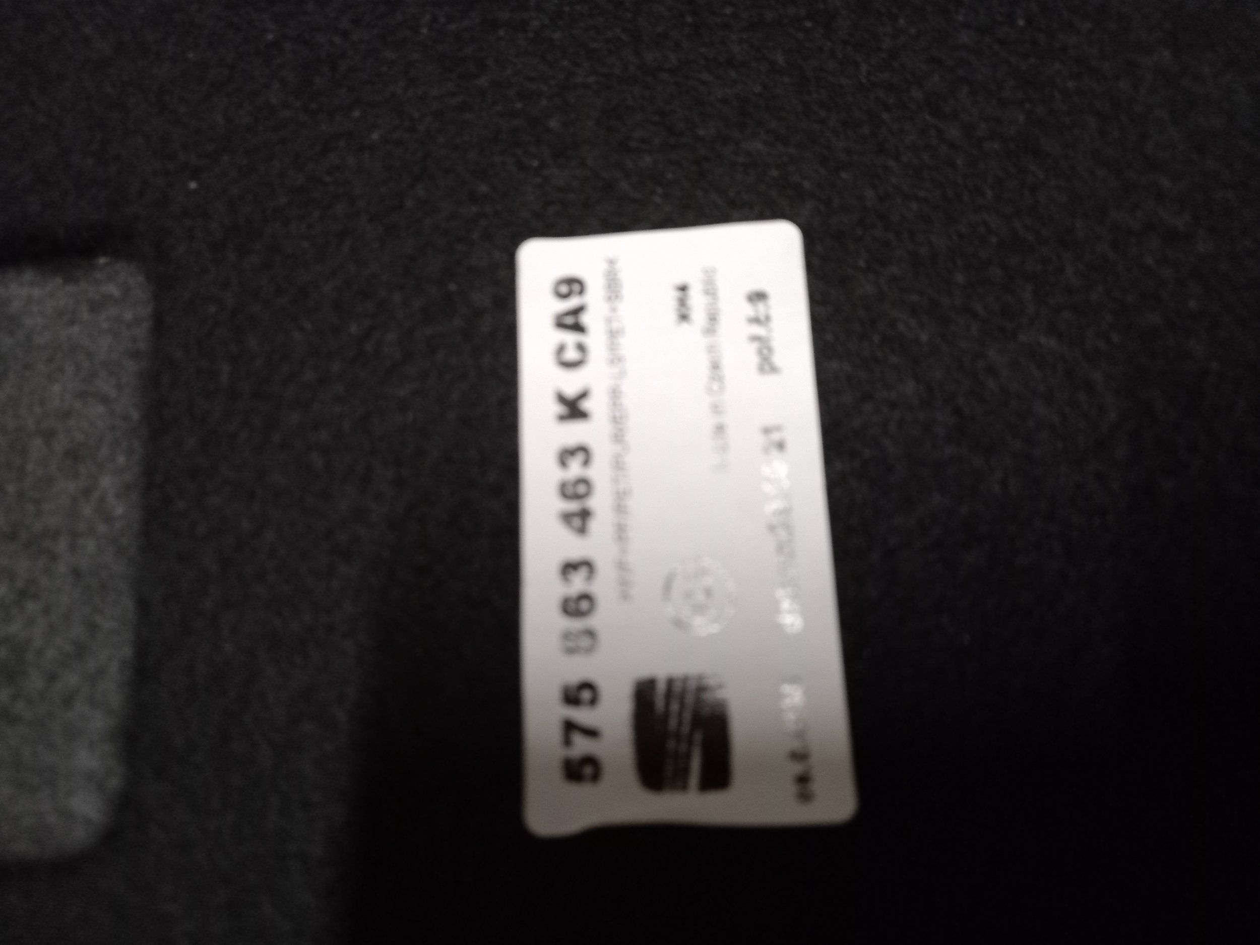

Exactly the same as my kit by the looks of it. The new boot floor has a hinged opening bit on the left hand side, so if you need to access anything in the storage area where your extending wheel brace is, you don't need to lift the whole floor.
They are expensive, but are a perfect fit and finish and I wouldn't be without it.
Reactions: Tell and KarlW300
Hi Bendy

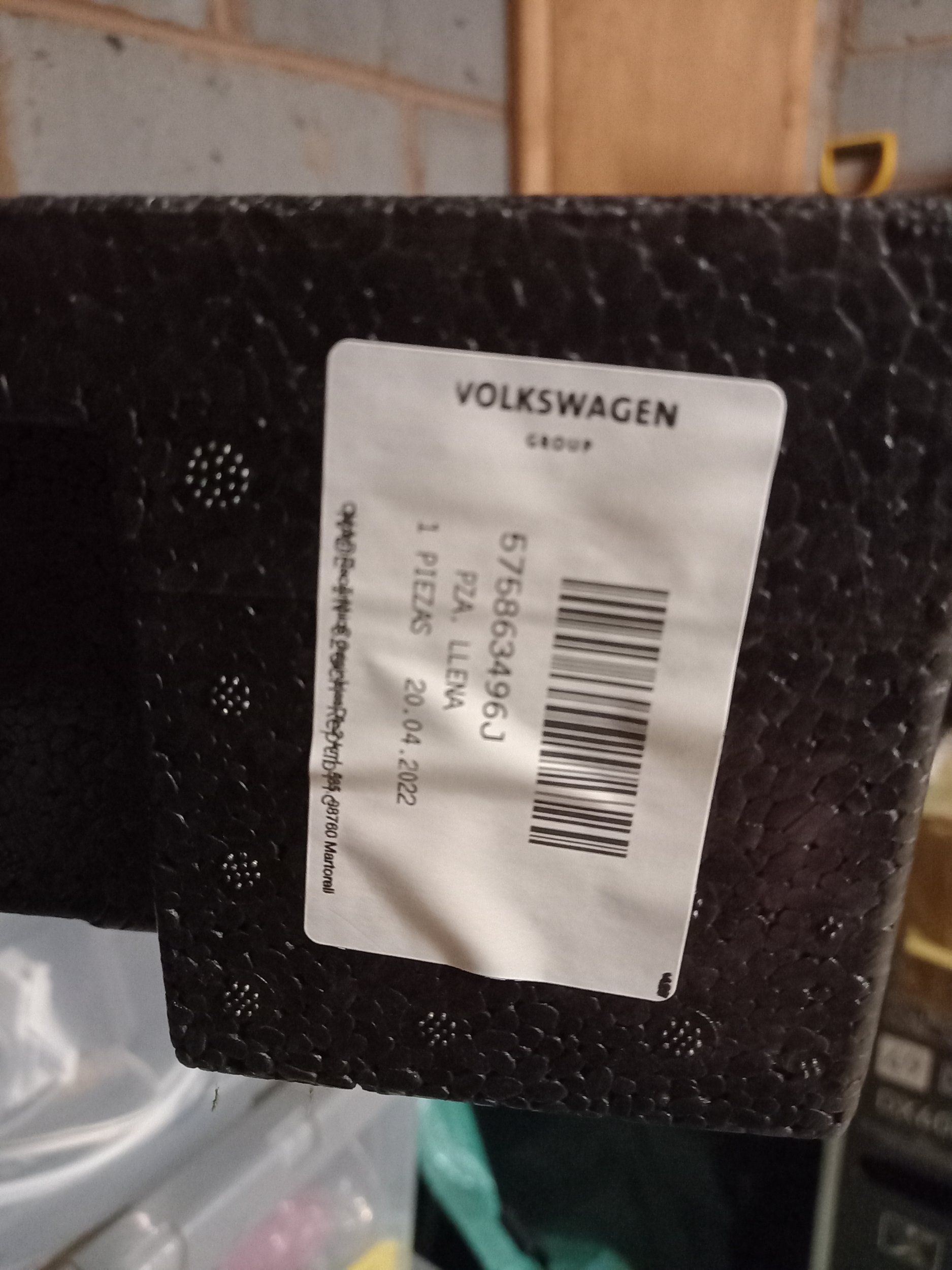

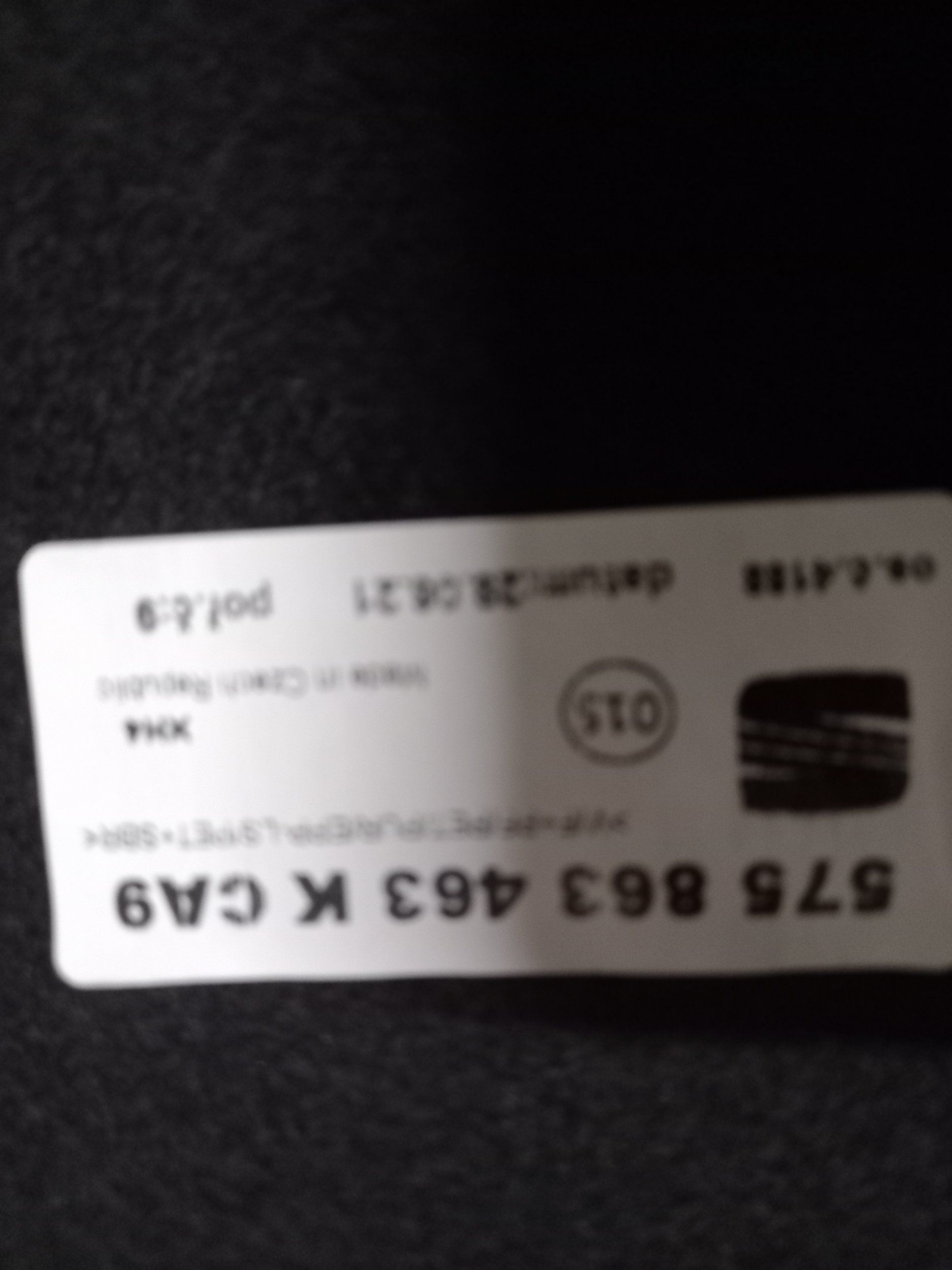

Yeah sounds like they are the same although your kit part number was slightly different to mine.
Yours ZGBBOM235SE.
Mine ZGBBOM242SE.
Think the tools are the same and the wheel but the foam inserts, Boot lining and jack are different part numbers?
I will attach a photo of both parts in mine and your kit to see the difference.
Maybe Tell will know what the difference is between the Cupra Ateca and the Seat Ateca 4WD is?

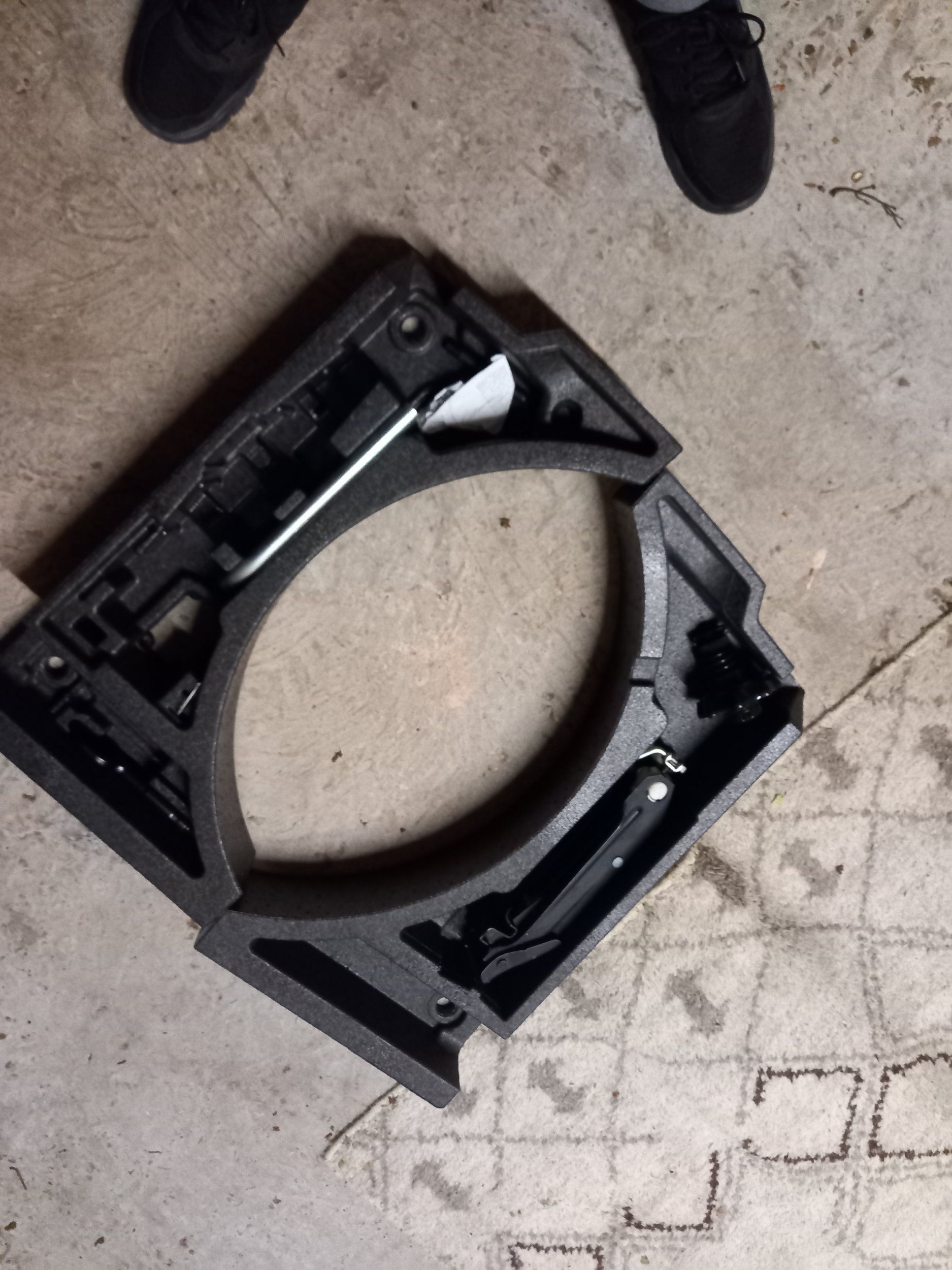

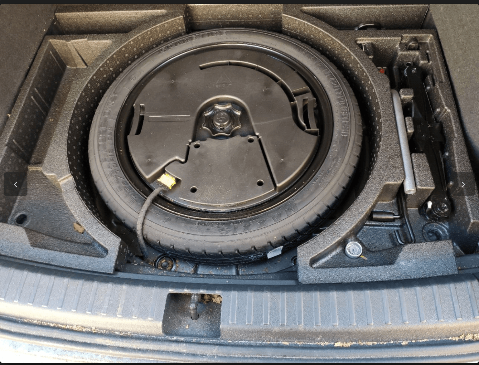

Here are some pics
