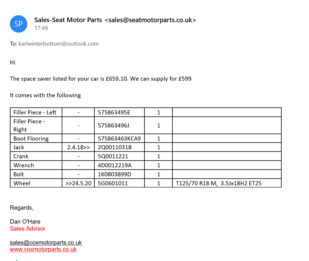

Seat motor parts got back to me and the spare wheel for my Cupra is different compared to the Seat Ateca 4WD non sound which we thought was the correct one. (Part Number ZGBBOM235SE (Vehicles built up to 24.5.20)
Below is the parts list I require. The actual wheel and some of the tools are the the same but the jack and foam inserts have different part numbers?
The cost is also almost double as well!:unsure:
Below is a list of the parts they provided. ( I have attached the parts with the kit (Part Number ZGBBOM235SE (Vehicles built up to 24.5.20) for comparison.

Hi Tell

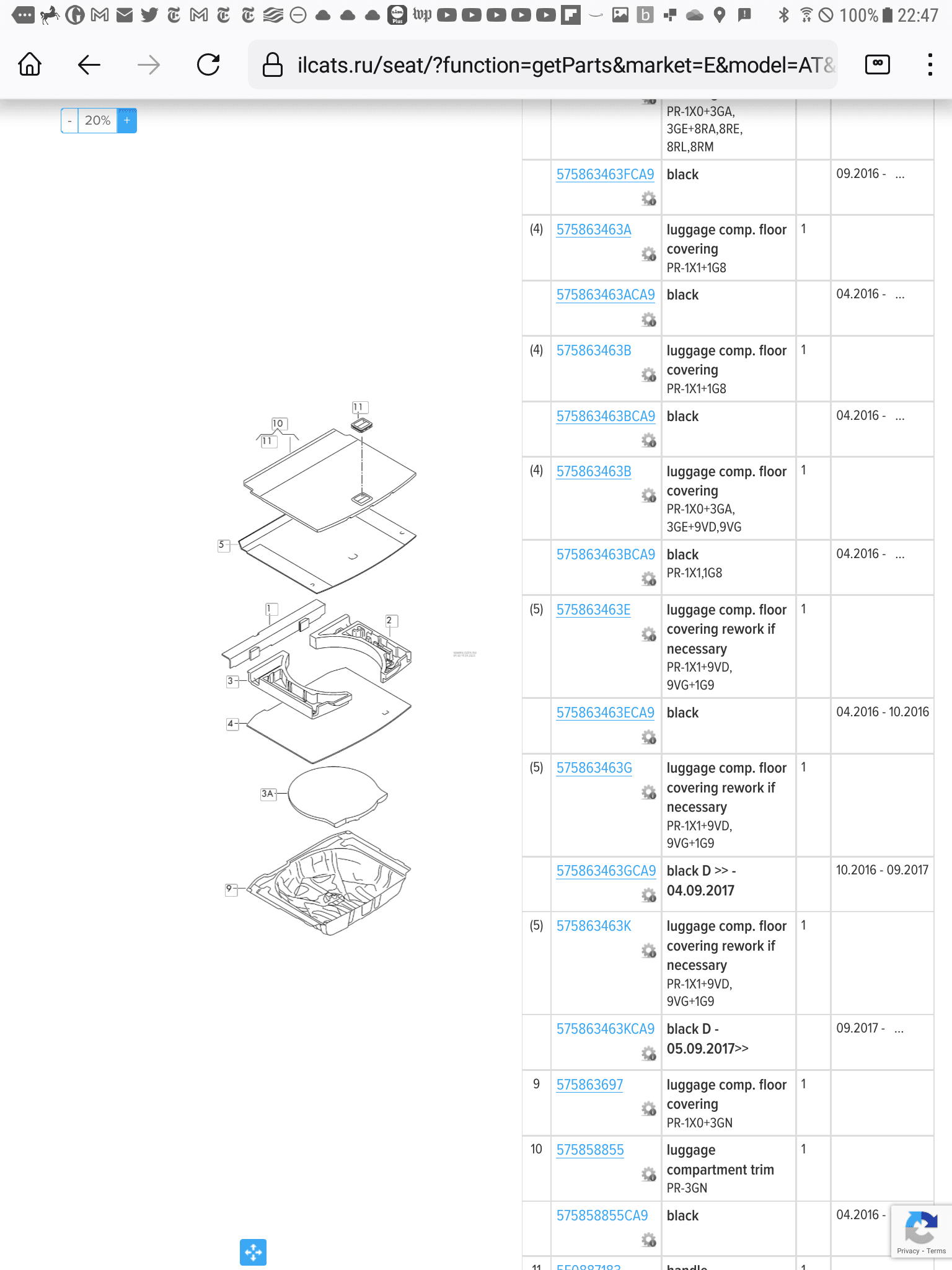

I've found another spares catalogue - Russian - diagrams. Handy to see where the codes fit in with the diagram.
Right filler
Filler piece left in this one (also covers the variable floor one)
You can get lost in these parts catalogues. Based on the first one.... I can't see anybolts for supporting brackets. Perhaps it does just sit there in the 4Drive configuration.
You need to make sure you got the boot base as shown in Little John's first picture and all the rest in his second picture to fit yours.
That's the wheel bolt to the floor.

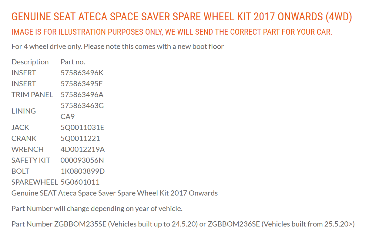

I'm not sure why one spare wheel kit is £357 and the one they quoted me is £659 minus club discount for both items especially when the actual spare wheel and most of the parts are the same?
The jack is different and the foam inserts and possibly the floor so I don't know why the price is so much more expensive?

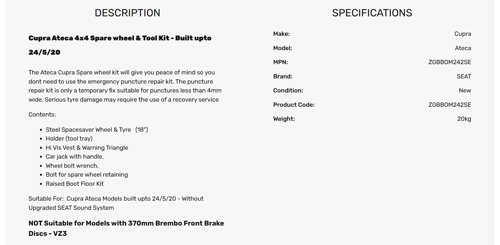

I have just found the below spare wheel kit and this says it is for the Cupra 4WD no sound and no brembo brakes so this should fit my car and the price is £345.31 which is more like it.
Part number SKU: ZGBBOM242SE
https://seatdirectparts.co.uk/parts...eca/cupra-ateca-2017-present-spare-wheel-kit/
I will enquire and supply my reg for confirmation.
That sounds more like it. The jack in the other one was nothing special I tracked that part number to polos etc so it wasn't a special up grade for the weight of the car.

Seat parts direct got back to me today to confirm that their kit is the correct spare wheel for my car.

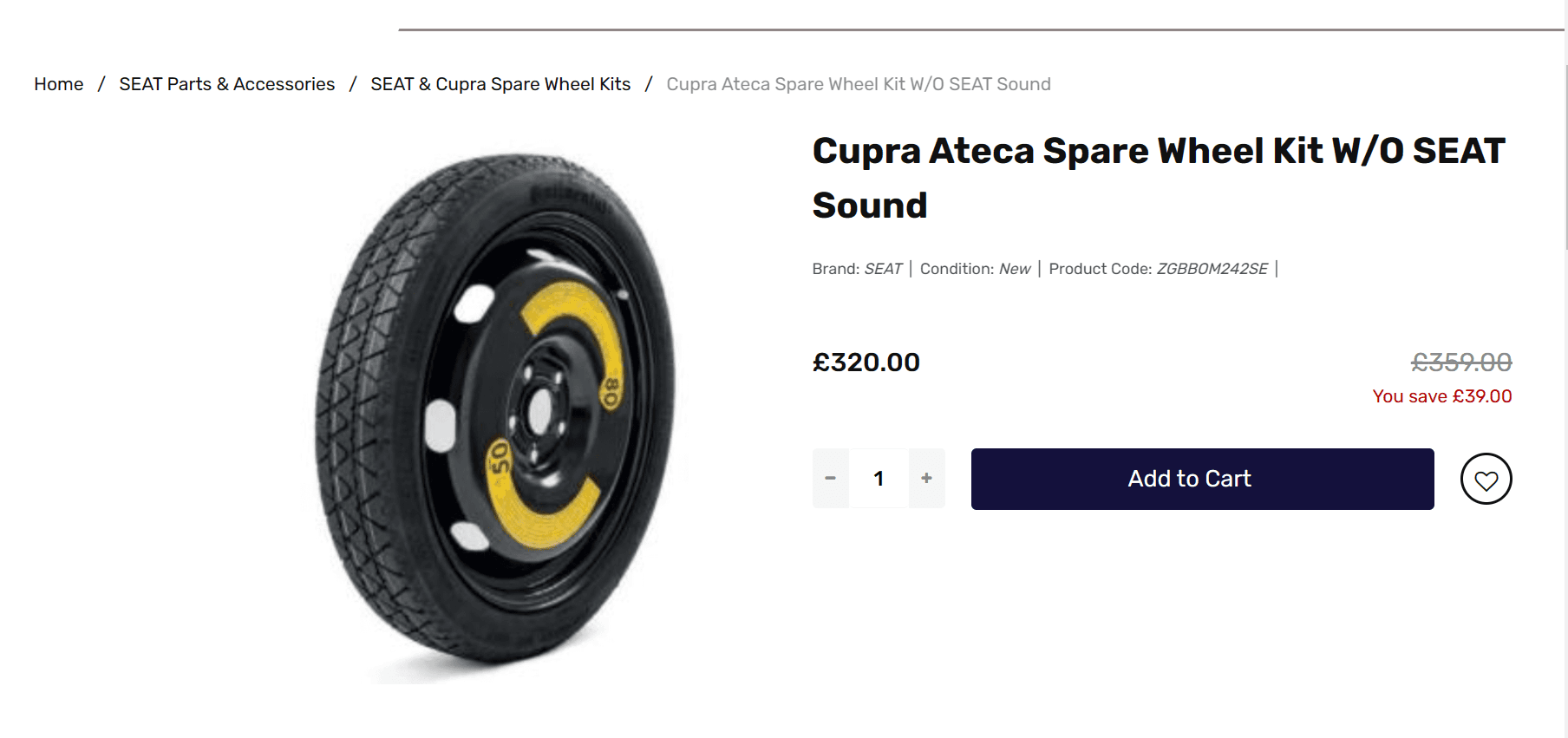

Good evening all
I have just found another Seat dealer with the spare wheel kit ZGBBOM242SE which is correct for my car.
The price of £320 so much better than the original £600 quote of a certain Seat parts stockist.
https://www.caffynscarparts.com/cupra-ateca-spare-wheel-kit--wo-seat-sound-5465-p.asp

I emailed the place with the space saver for £320 (ZGBBOM242SE) so once they confirm the kit is correct for my car I will look at getting it ordered.
Will update with pictures etc once the kit is fitted so Tell can use the information to create a guide as he mentioned earlier in the thread.
The space saver kit is now on order.(y)
