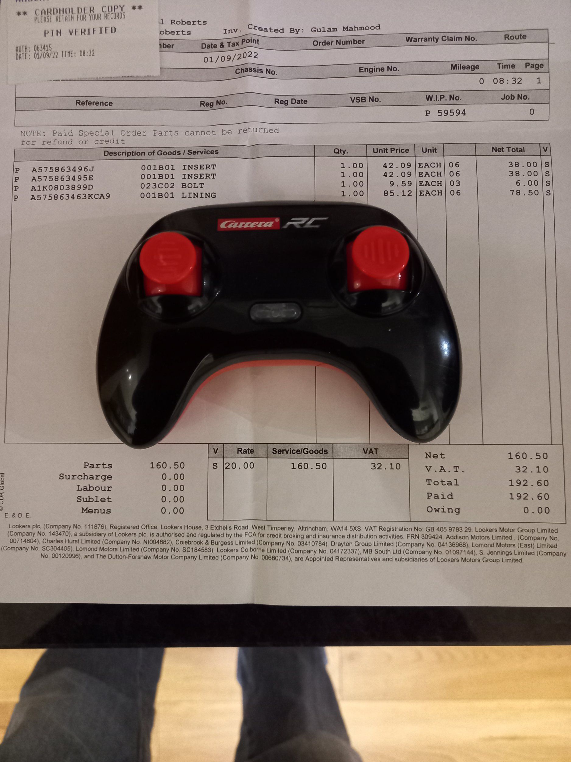

I have just checked the parts against my receipt which I posted and yours are the same as my Cupra Ateca Kit.
It is the floor, foam inserts and jack which are different in the 4WD Seat Ateca kit.
Not sure why as you would expect them to be the same but there must be some slight difference hence the kit numbers?
Cupra Ateca kit ZGBBOM235SE.
Seat Ateca 4WD kit ZGBBOM242SE.
Pity you didn't post earlier as I would have had it off you if it was cheaper than £320 which I paid from Caffyns who's customer service was excellent.
Mine was a bargin compared to the first quote of £600 for the identical kit!

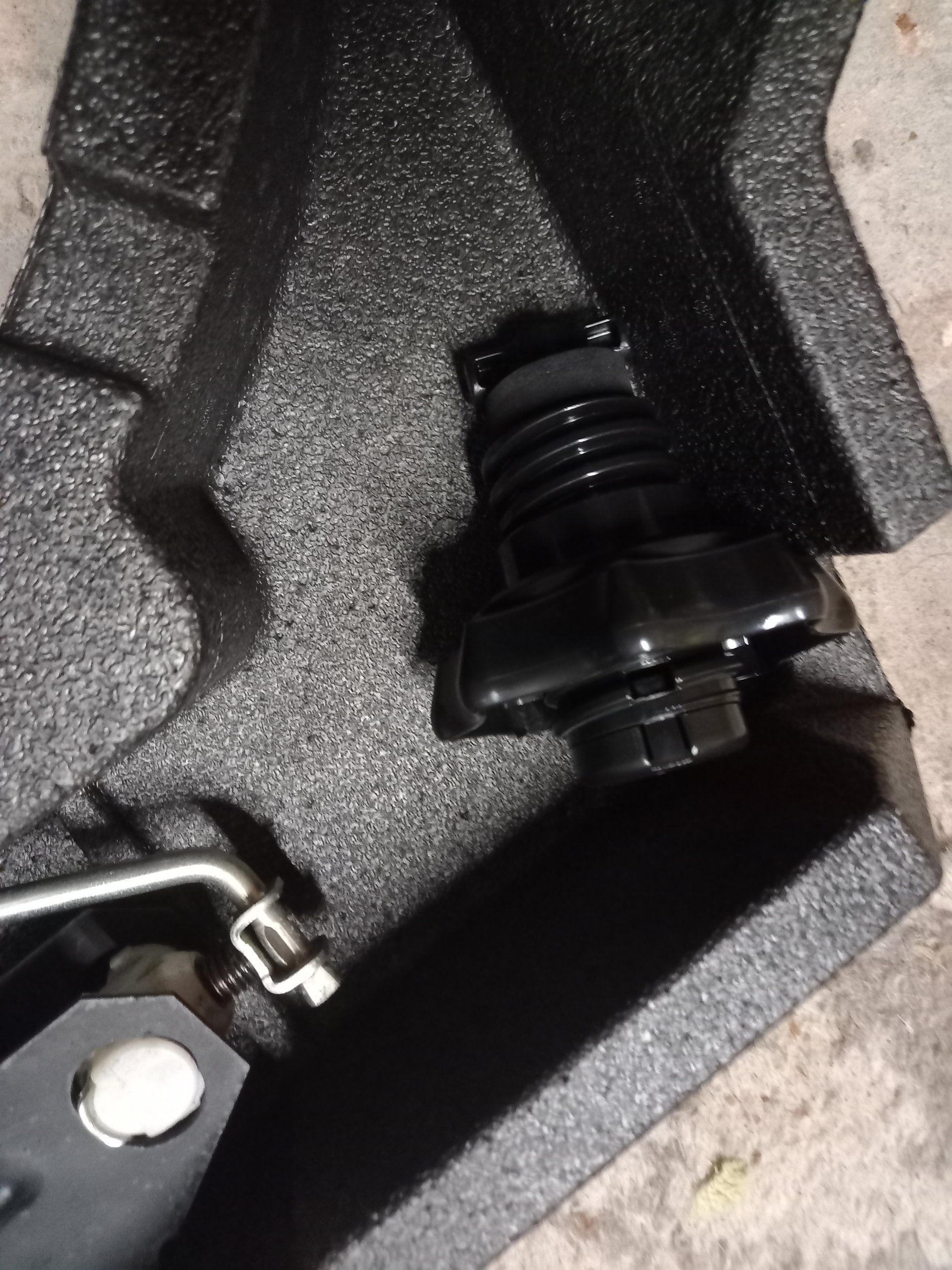

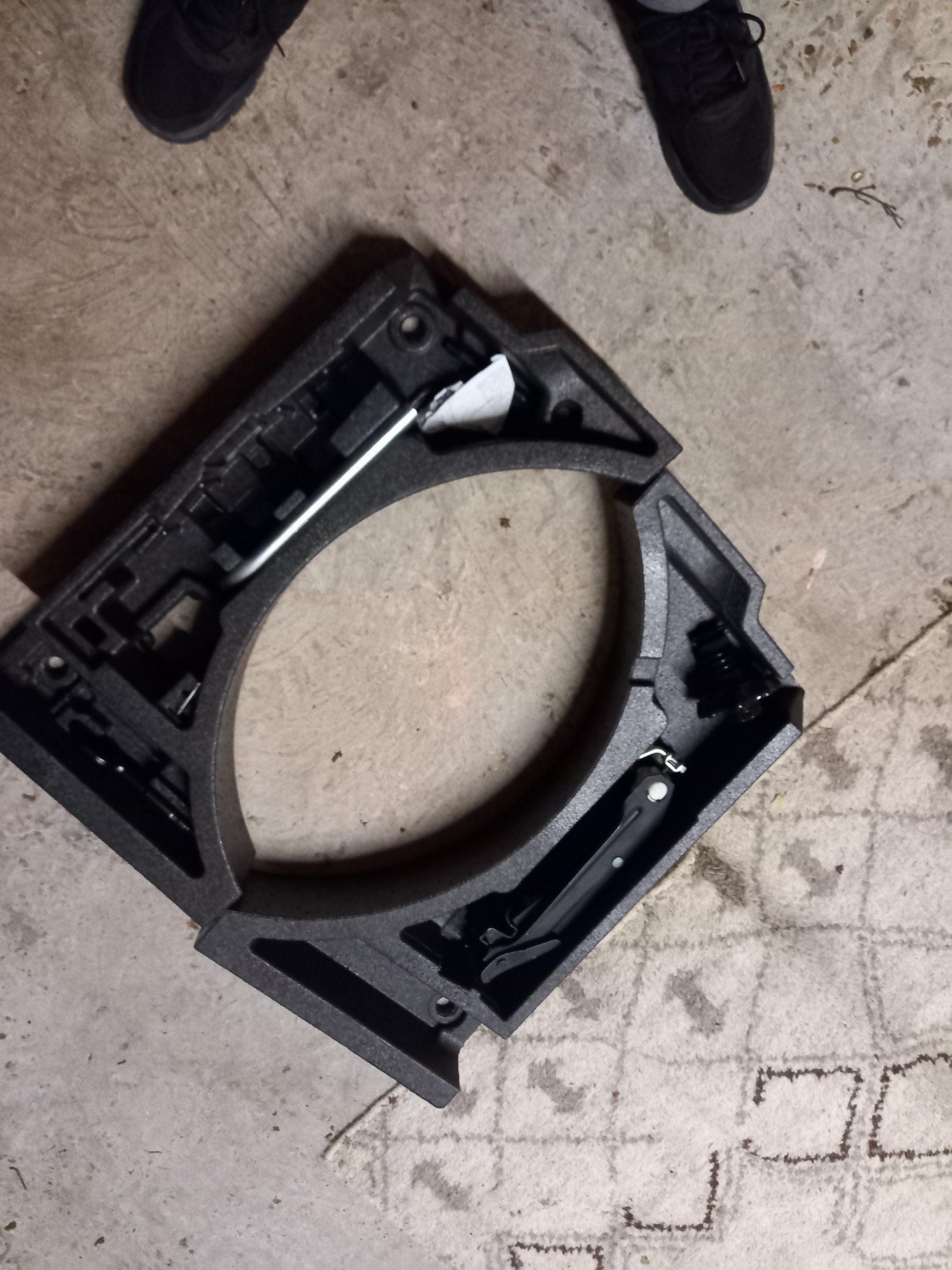

I have the carpet, I will take some pics of it

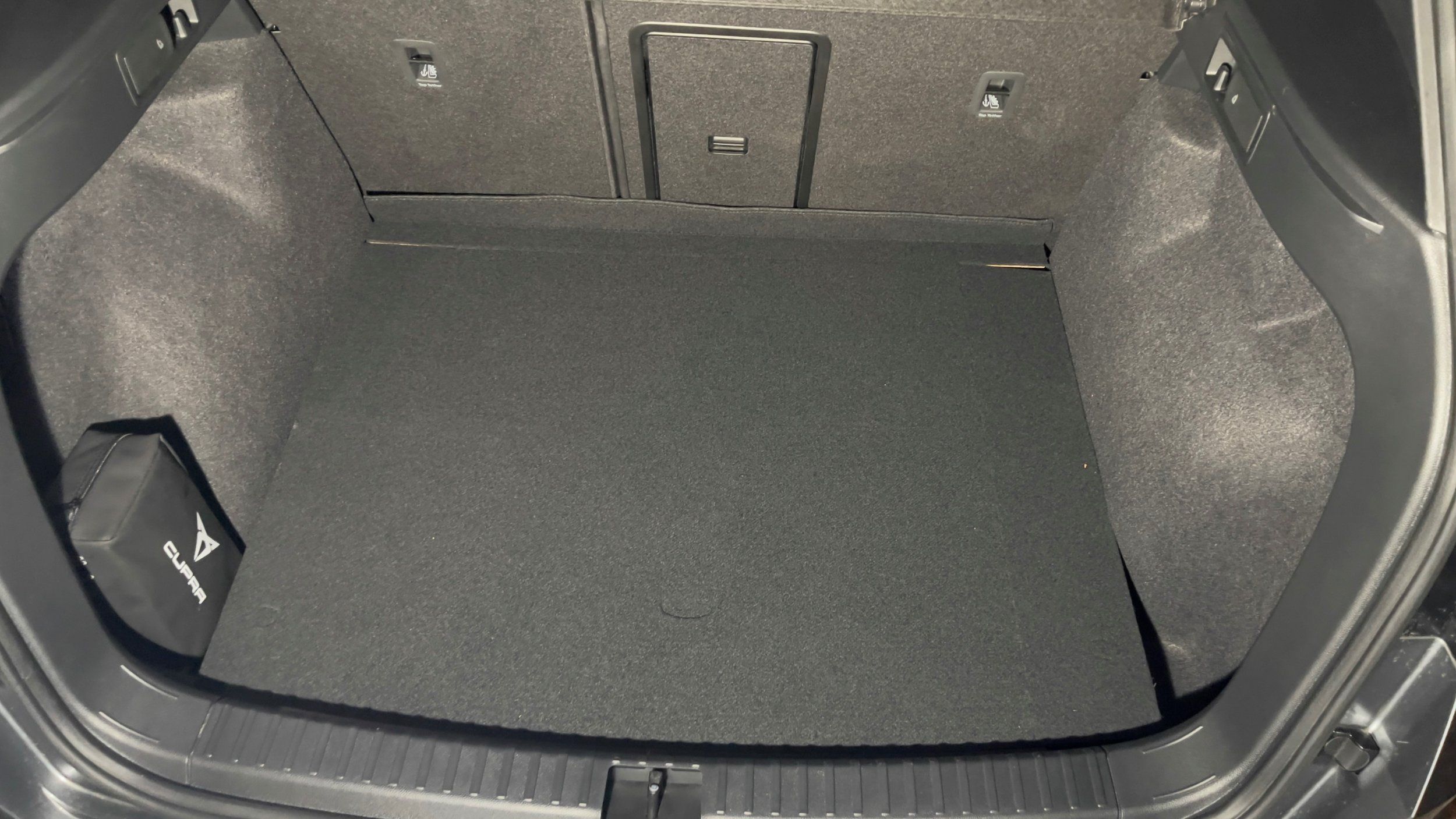

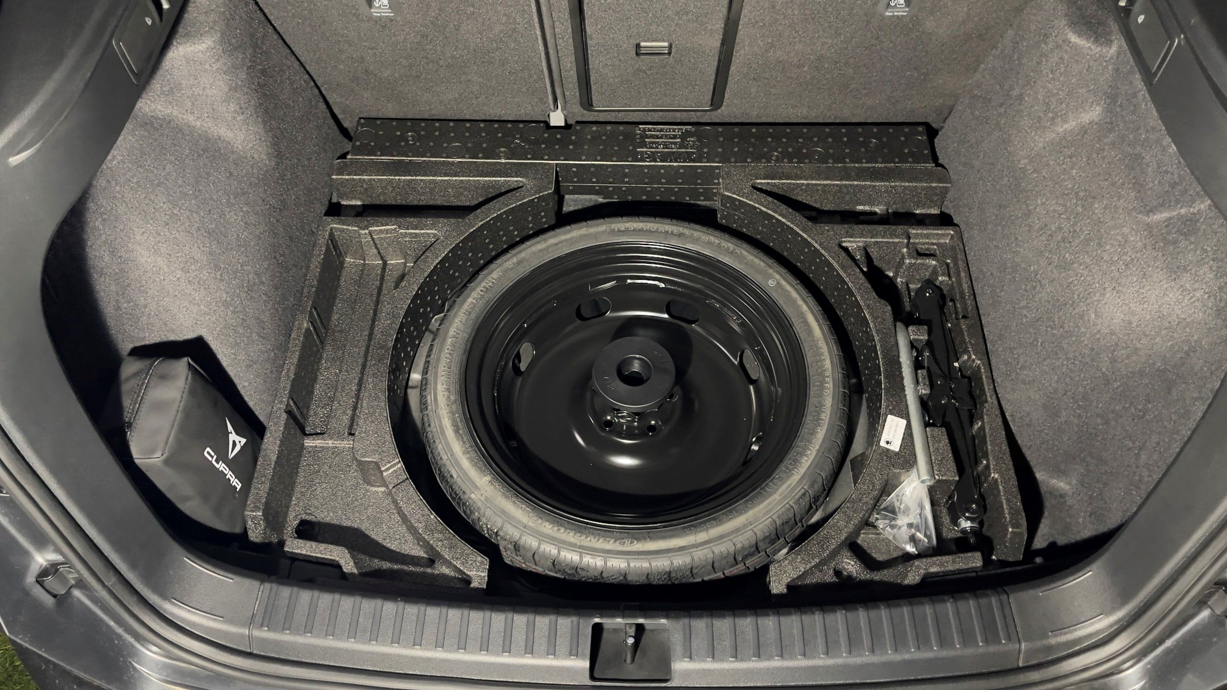

I have just got a Cupra Ateca VZ2 2023 , and originally ordered the adjustable boot floor, but as I only needed the floor raising for the spare wheel,changed my mind and I tried to order the spare wheel, foam surround and new hard floor. I was informed that SEAT/Cupra stopped doing the kit earlier this year. So I ordered the Skoda Karoq one which also states it is good for Ateca 4x4
https://www.caffynscarparts.com/sko...MIi66Sv-ntggMVY0lBAh0VHAc8EAQYAiABEgLLsPD_BwE
Got a few quid off with the Black Friday deal, arrived next day and 10 minute fitting. The only thing I will need to do is to put the original carpet floor ontop
Thanks to all for previous post, who helped me get this sorted

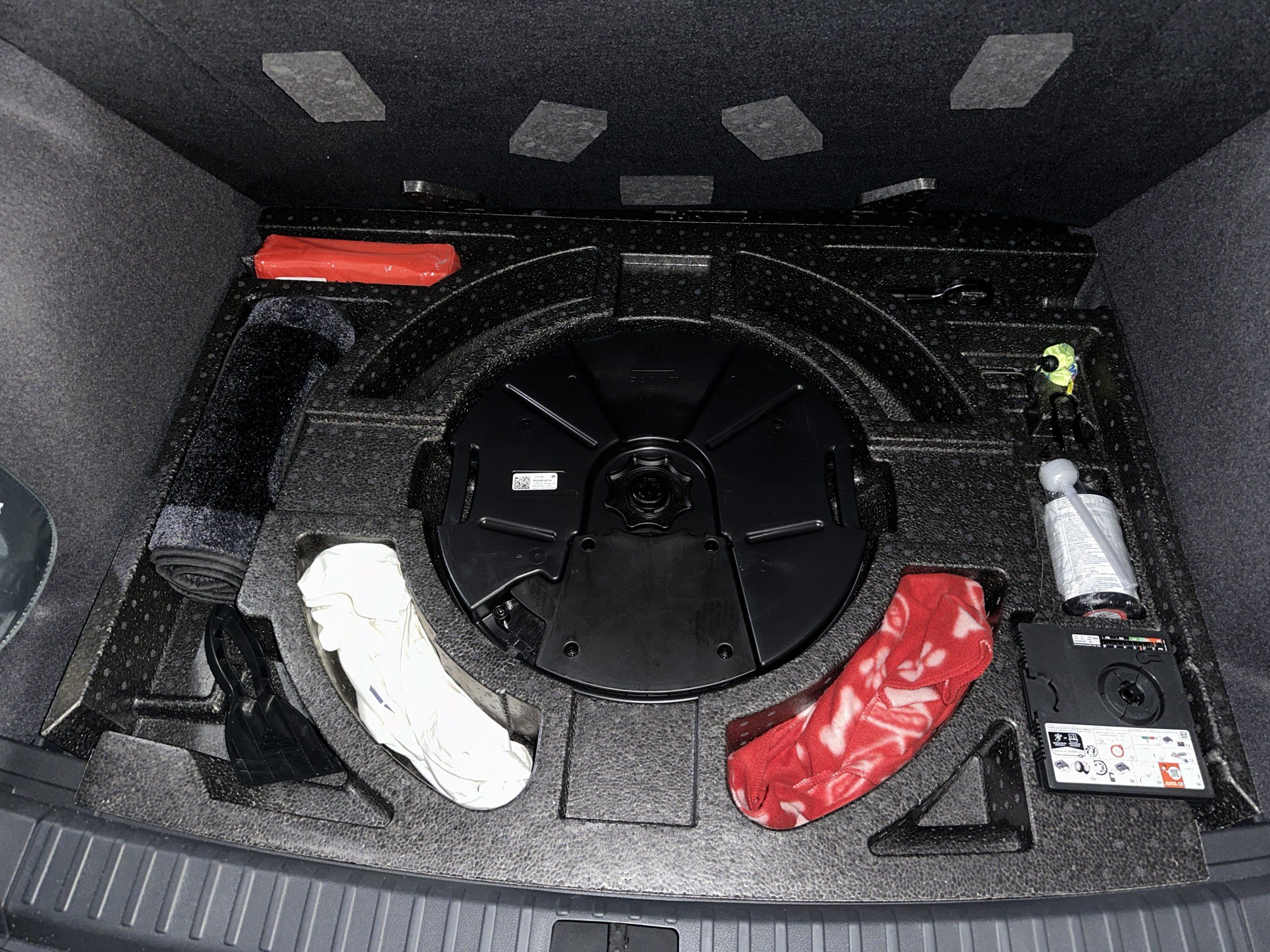

Thanks Tell, it’s the beats audio, and it’s a sub that fits in the spare wheel, has this in my previous FL C&S, and it came with the spare, so left it in when sold. Now I have a foam piece with the sub inside
Reactions: Tell
post 67 looks just like my previous FL C&S but need to find out if the sub will fit
Reactions: Tell
I can confirm that the Skoda koraq spare wheel kit, fits the new vzn with the sub. Very happy and some great advice on this site.
