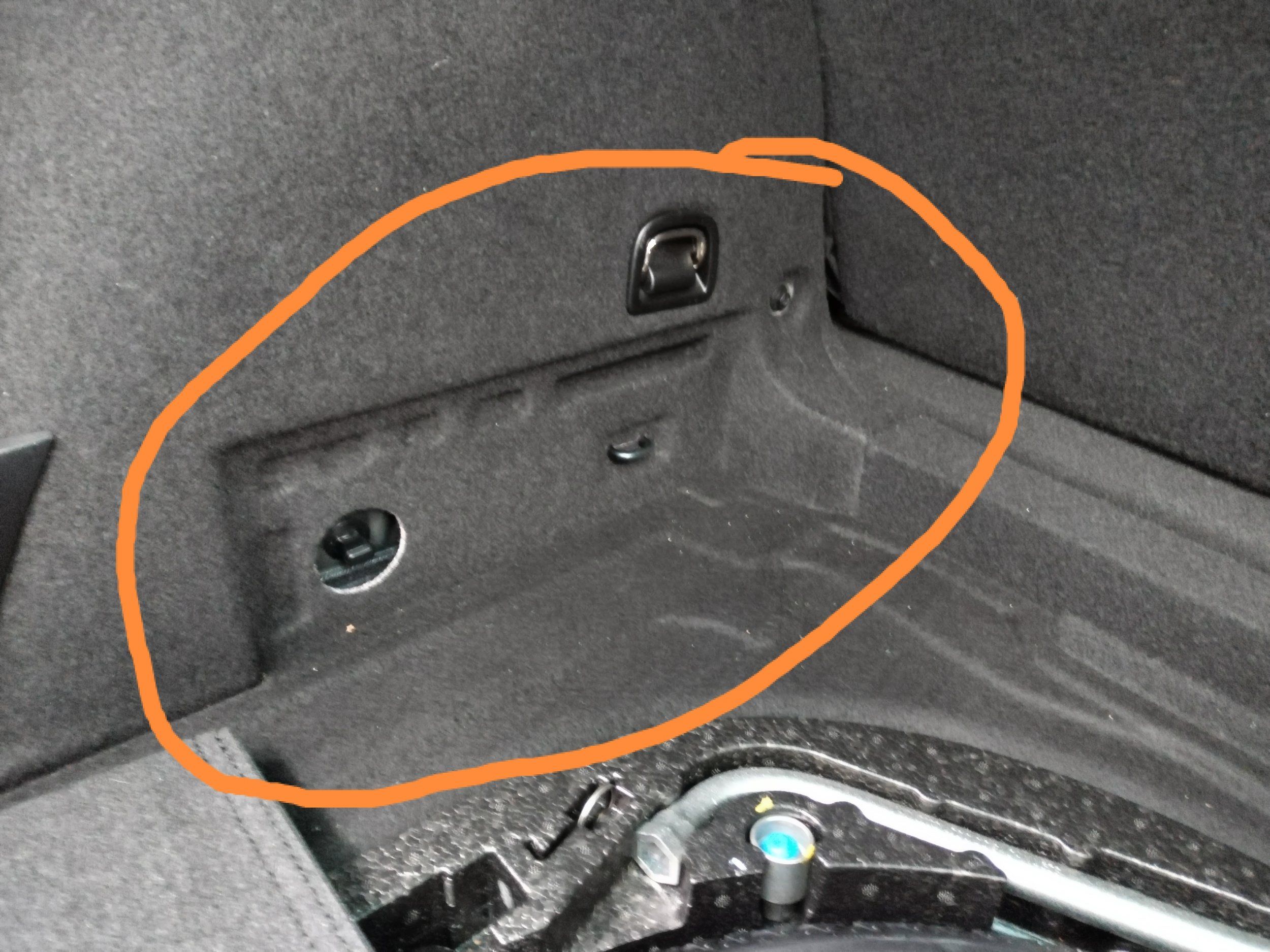

Step 2: Offer up one of the side supports to the boot wall where the anchor point is, as the support will clip on to the anchorage point in the end. This will make the side anchor points redundant.
Step 3: You can now see whereabouts the holes will need to be cut. Mark the hole nearest to the rear of the car with chalk.
Step 4: Move the support out of the way. Lift up the carpet and get your fingers in, you should be able to feel a bolt sticking out of the wall. You need this bolt to come through the carpet and into the hole nearest to the rear of the car on the support.
Step 5: The hole will need to be about 40mm in diameter (I used a hole saw in a drill). This is to allow the plastic of the support to go through the carpet. Offer the support up again. You may need to cut some more carpet of to make it fit nicely. The bolt should be coming through the hole in the support.
Step 6: Once you’re happy with how the support sits, you can push the support on to the anchorage point until it clips in. Hold it here as it will unclip. Mark the other hole. Again remove the side support and cut the carpet. This will need to be about 25mm in diameter. Again adjustments may be needed.

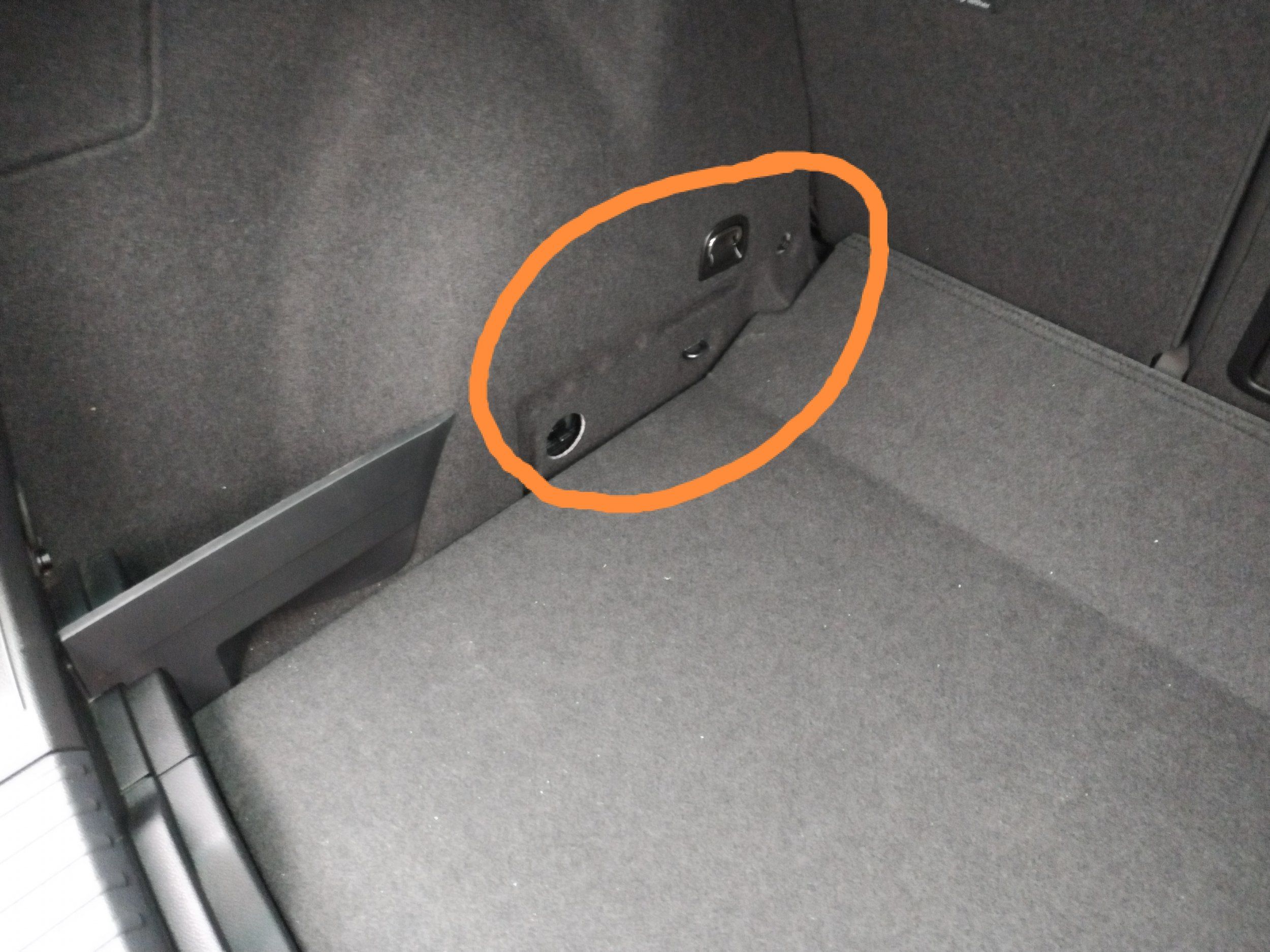

Hi @Ckpearce91 , got a question in reverse of this subject if you can help please, save me posting another thread...
I've got the VBF already fitted from factory, but I've taken the side supports out so I can get the high edge plastic boot tray in (575061201C). So can you guys tell me if there's absolutely anything that looks like a cover where the VBF side supports ultimately go, or is it just carpet and no plastic trim/plate? I'm guessing not as you have to cut to find the bolt hole and the union nut stubs, but at the mo there's just the holes in there and it looks a bit Heath Robinson. Cheers

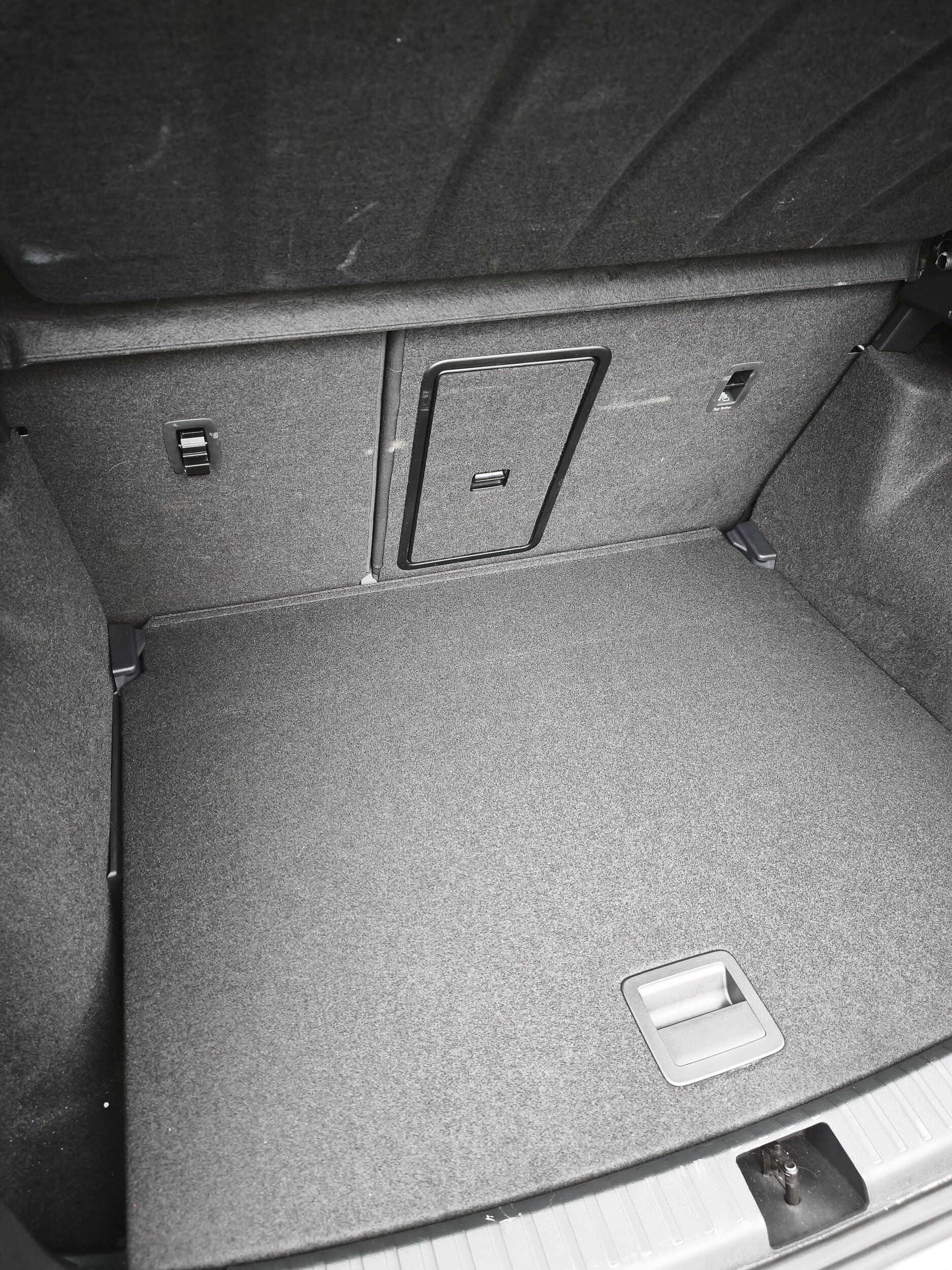

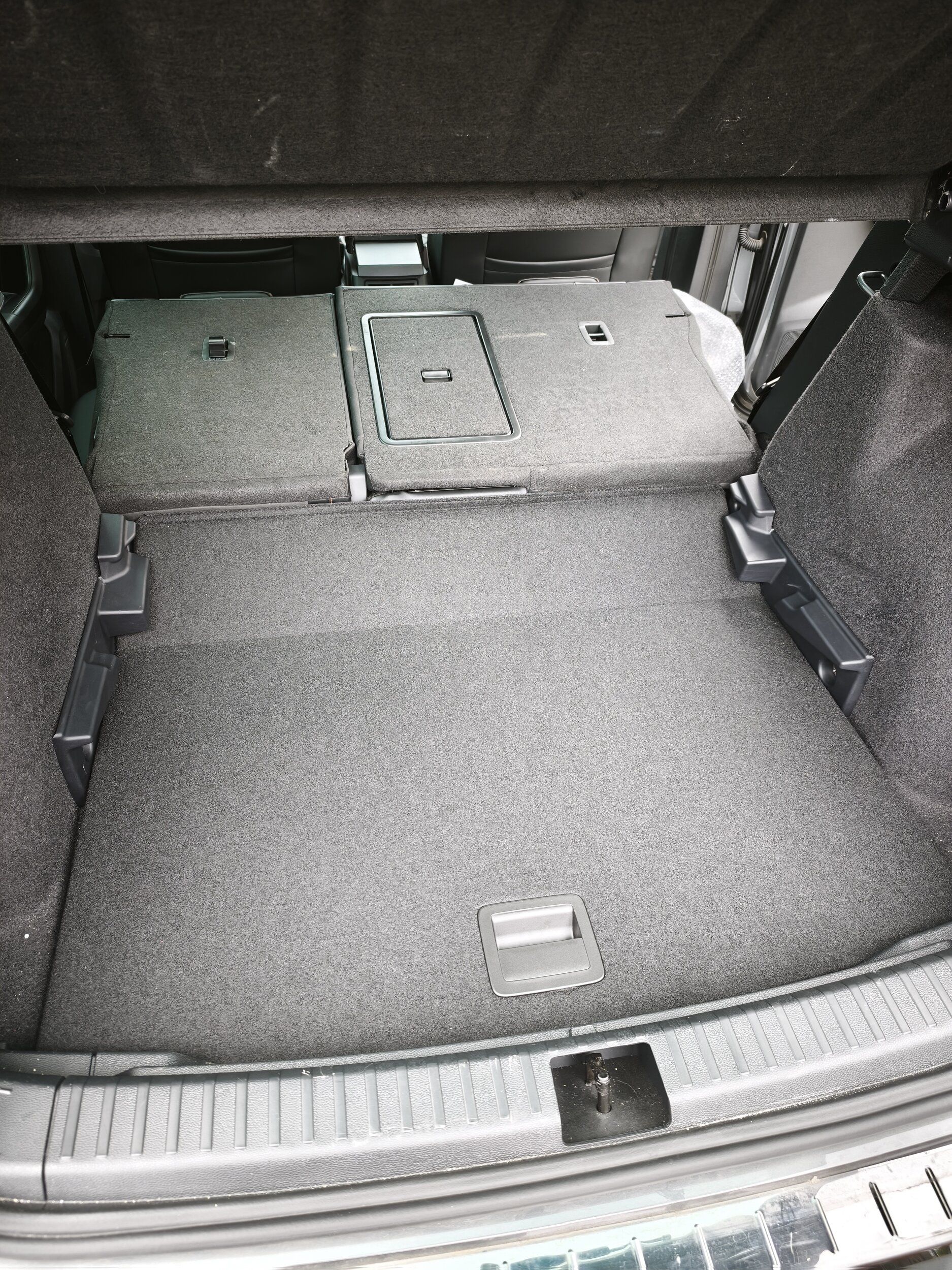

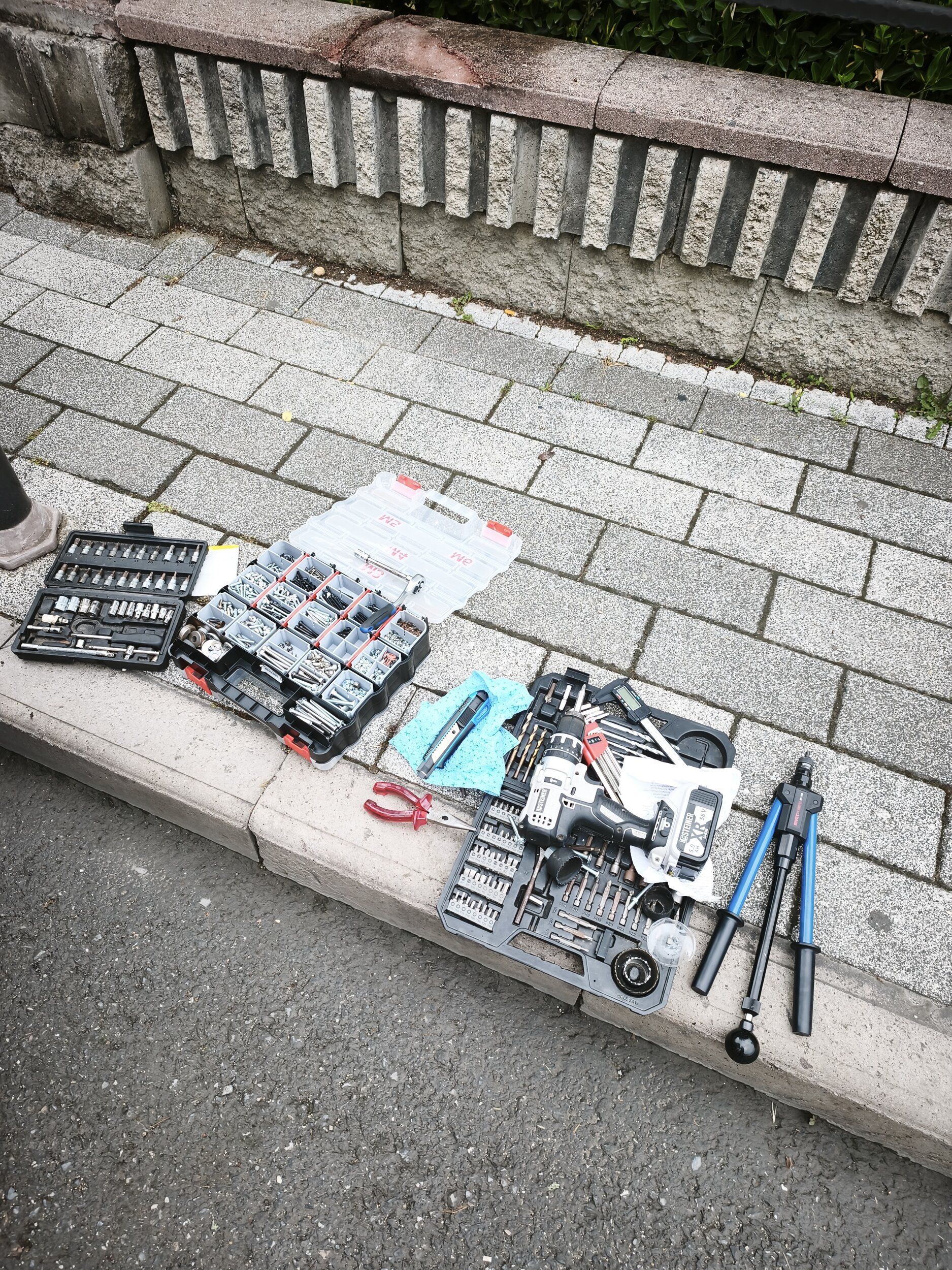

Hello from Istanbul!
I just wanted to say a big thank you for sharing your boot floor installation experience. Your guide helped me a lot and the result turned out really good.
I truly appreciate your help!
