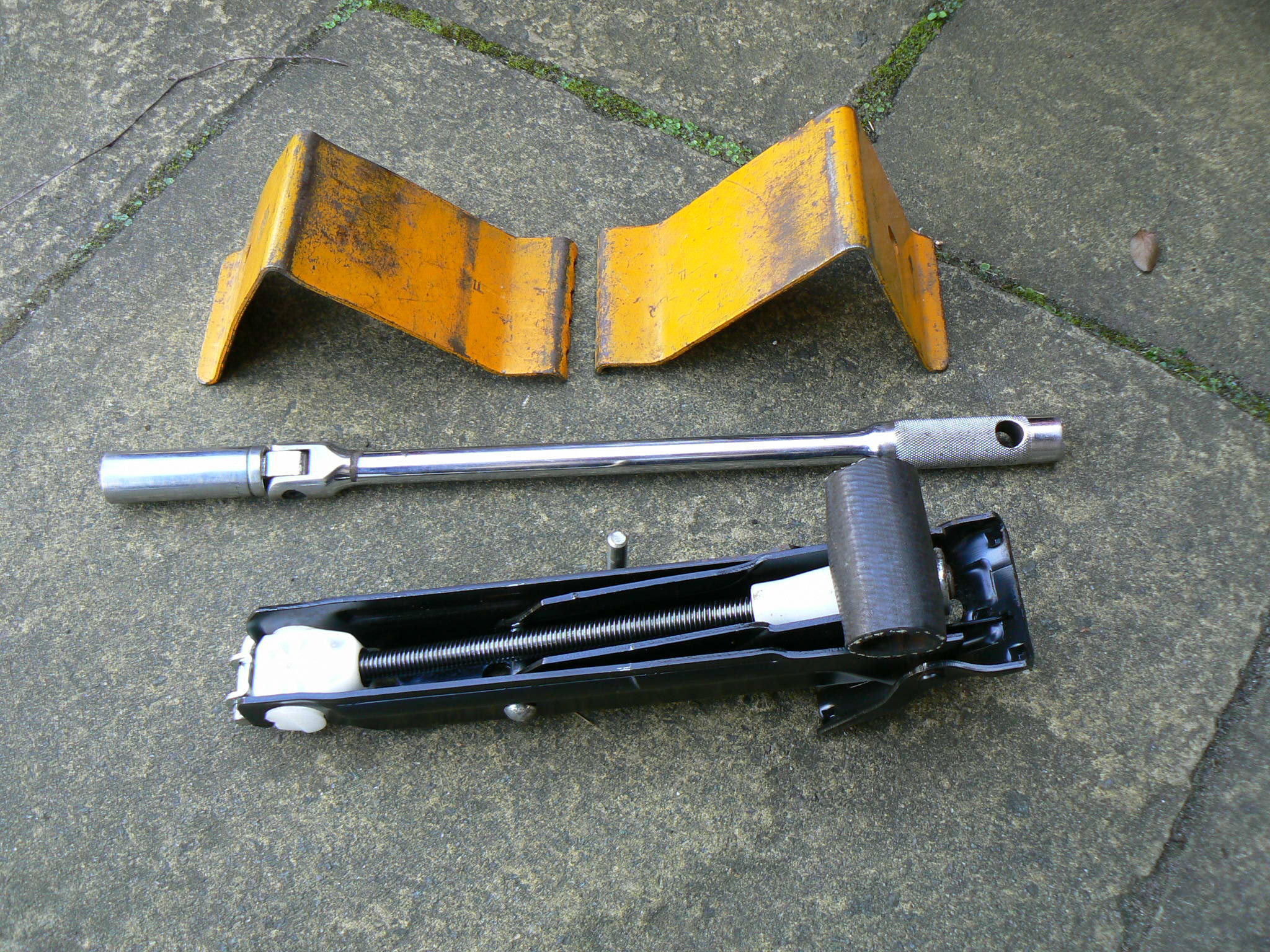

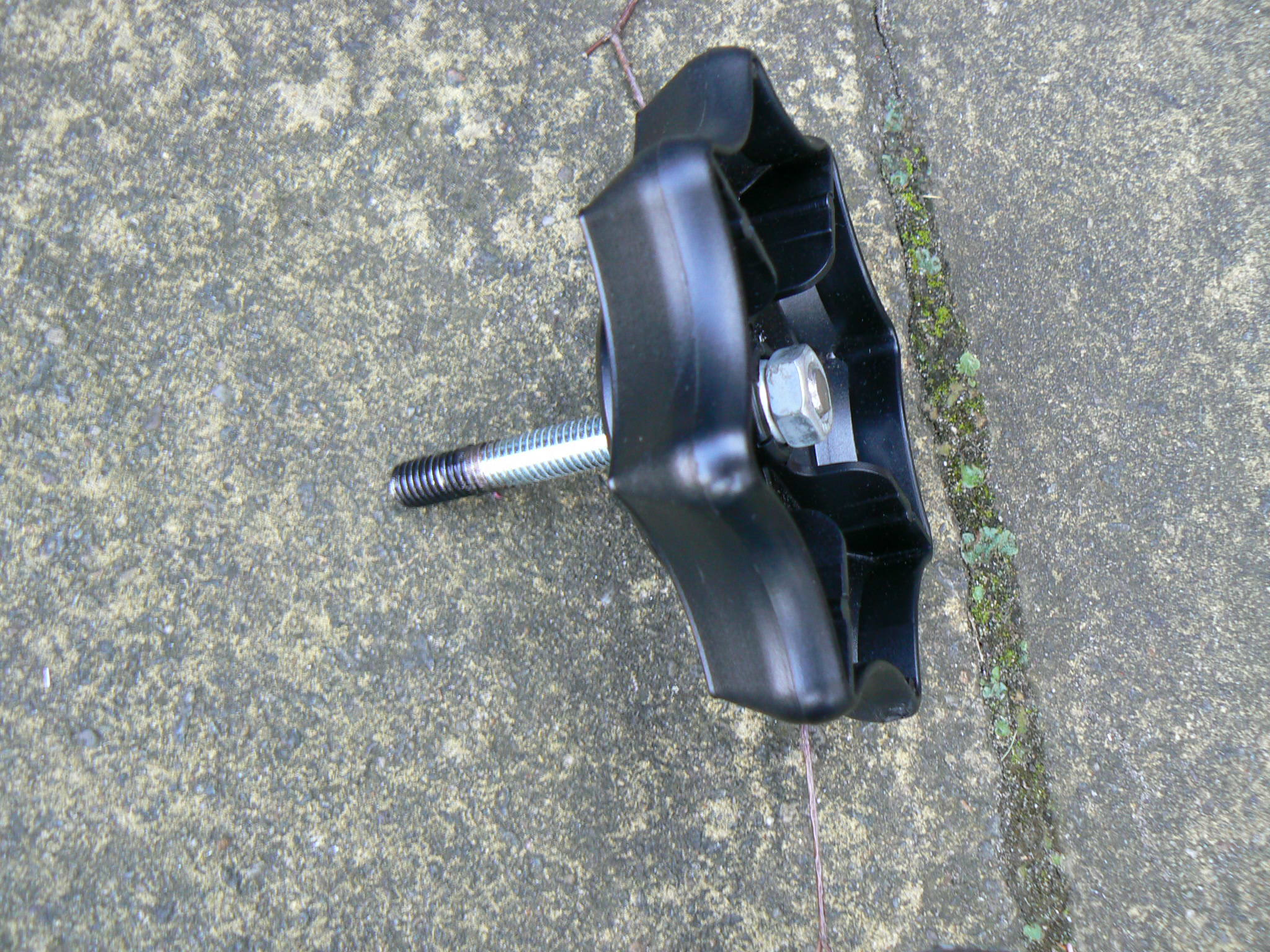

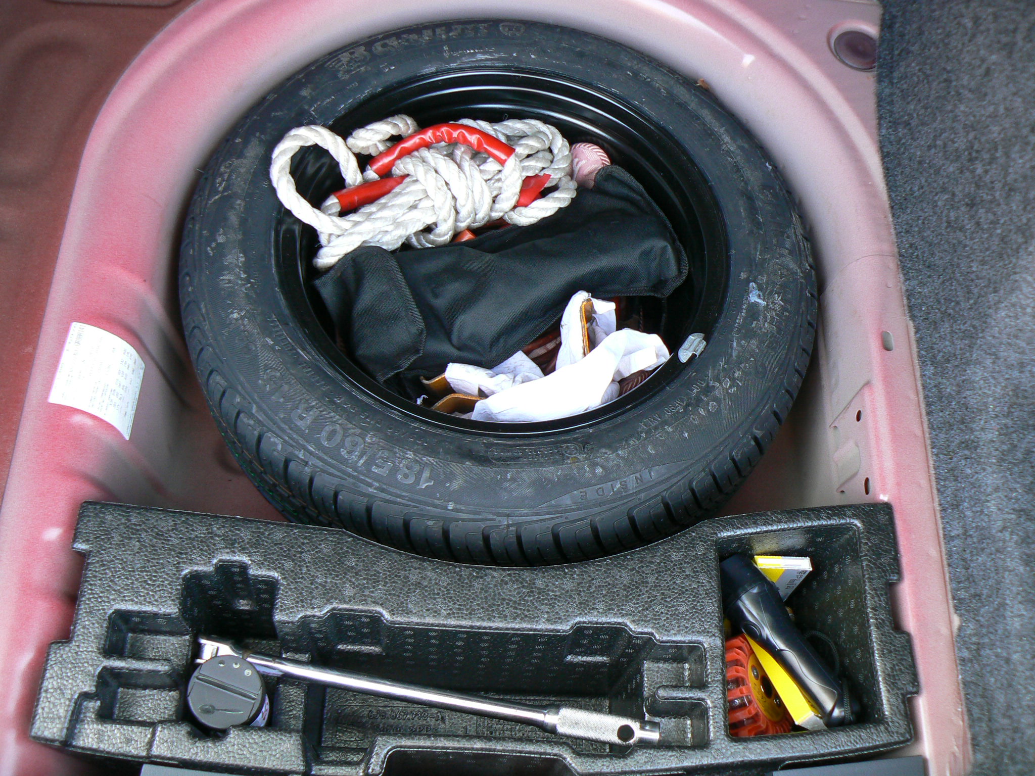

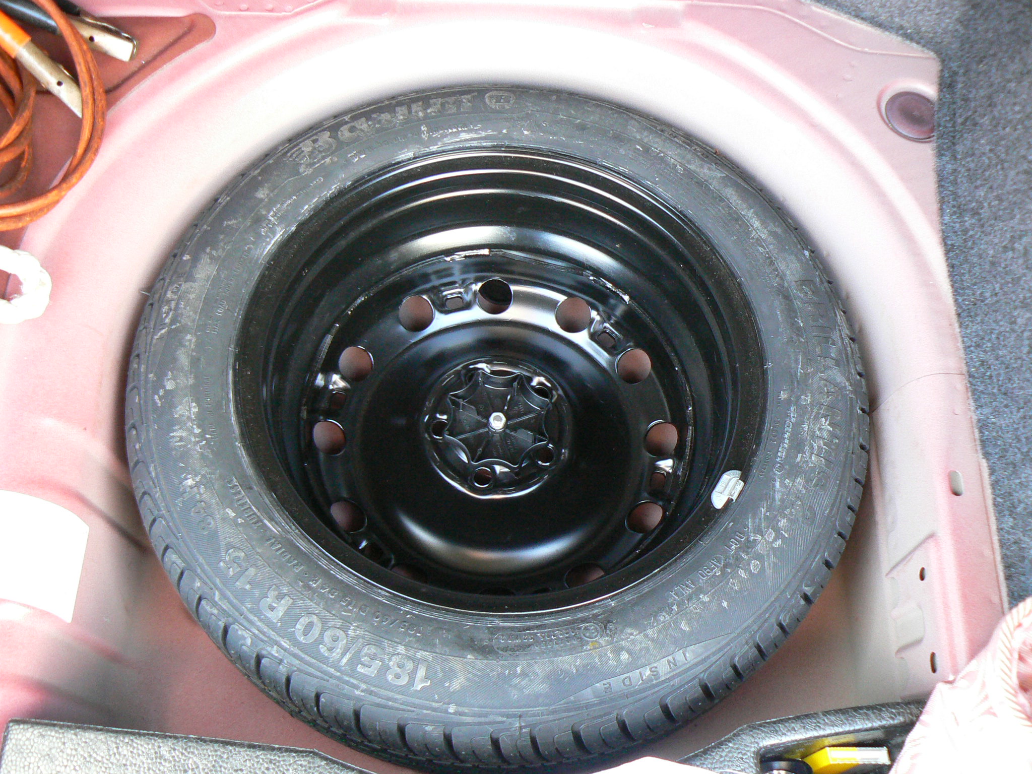

Ok, my car is a 2016 Ibiza ST so don't know how similar to yours that is? It comes on 185/60 section tyres on 15" rims. Which I like because I find often the ride on "skinny" (low profile) tyres is a bit harsh. She came without a spare, just a can of "gunge" and a fancy inflator pump. We do yearly trips down to Devon and Salisbury (live in Edinburgh) and I wouldn't dream of doing this without a spare. I bought the car as a pre-reg with 50 miles on the clock so didn't have the option of specifying a spare in the original order. I quickly found out that the Base version runs on the same size tyre but on a steel rim. I found a Seat dealer who sold me one for an acceptable price and my local tyre people fitted it with a Barum tyre for me (my preferred brand. When the Bridgestones, which I don't like, are done I'll be fitting these all round). Luckily I had a VW jack lying in my garage which fitted and I've carried a power bar for shifting wheel nuts for years so that just went to live in the boot too. When I received the steel wheel, before having the tyre fitted, I checked it for dimension, especially offset and whether the existing bolts would fit (same length and taper etc) and after the tyre was fitted I checked for clearance when on lock. I'm glad to report it's an exact match for the alloy. The only thing I had to do was buy a length of threaded stud to make a longer bolt for the hold down screw. The pump and bottle of gunge have gone to live in my "emergency spares" box which lives in the boot. By the way, anybody know what the funny wee bit of bent wire is for?
Now I'll try to upload some images for you - don't really know what I'm doing here so anything might happen. What do you do with the thumbnail/full image
thingy?

AH, so that's what you do with the thumbnail/full image thingy!

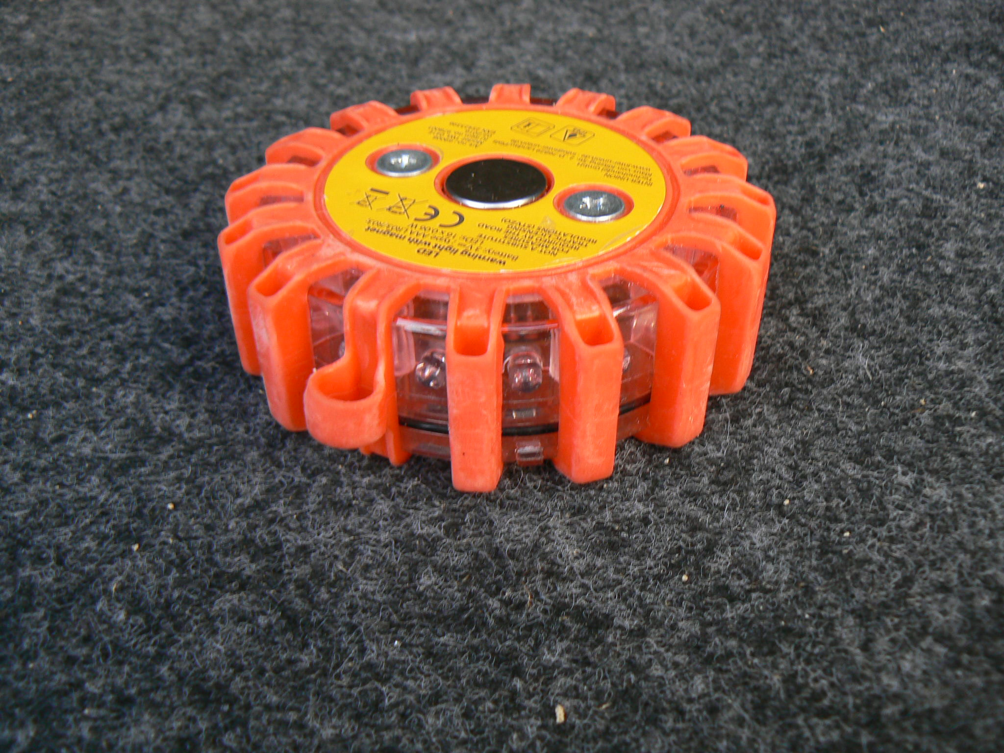

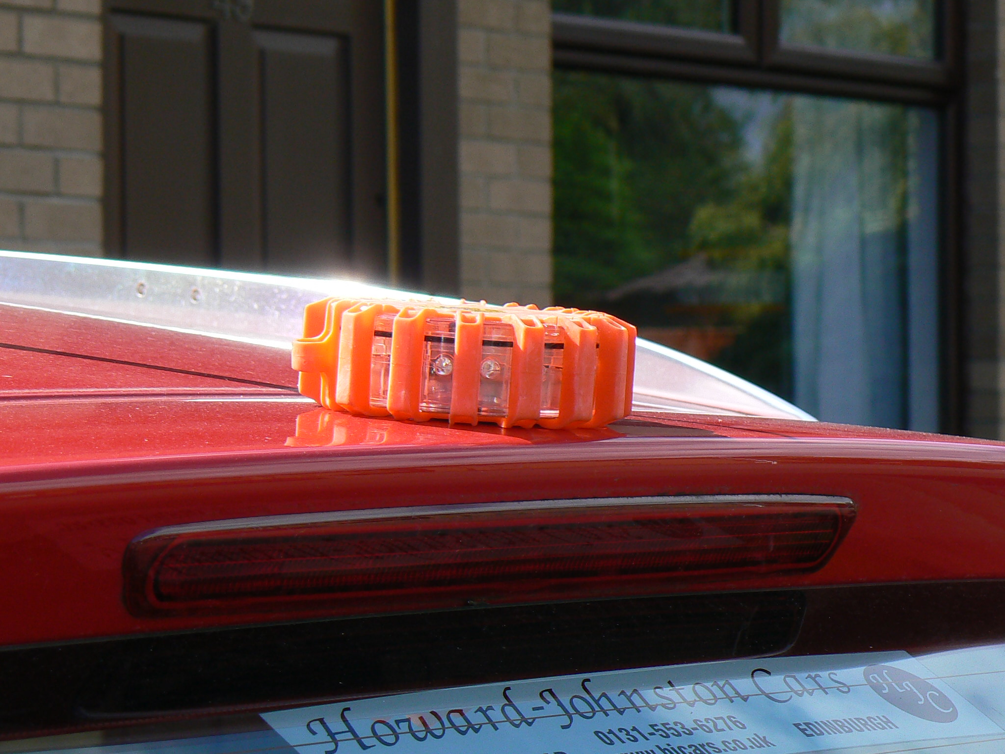

By the way, another thing I've carried for a few years now is a strobe flasher. It's magnetic and you can sit it on the top of the car roof if you have a motorway breakdown. Draws a lot of attention to your car and hopefully helps avoid someone running into the back of you - I'm thinking especially on these new "smart" motorway sections where there is no hard shoulder. Not so "smart" in my opinion!

Oh, by the way. Searched scrappys for weeks but all to no avail. Plenty of jacks, and wheel braces but no sigh of a suitable wheel. It was over 3 years ago now that I did this so memory is dimming but I think the new wheel and new tyre fitted and balanced was well under £100. The full dealer price for a wheel is just silly but there's a lot of stuff on ebay (including new ones) if you can't find an obliging main dealer.

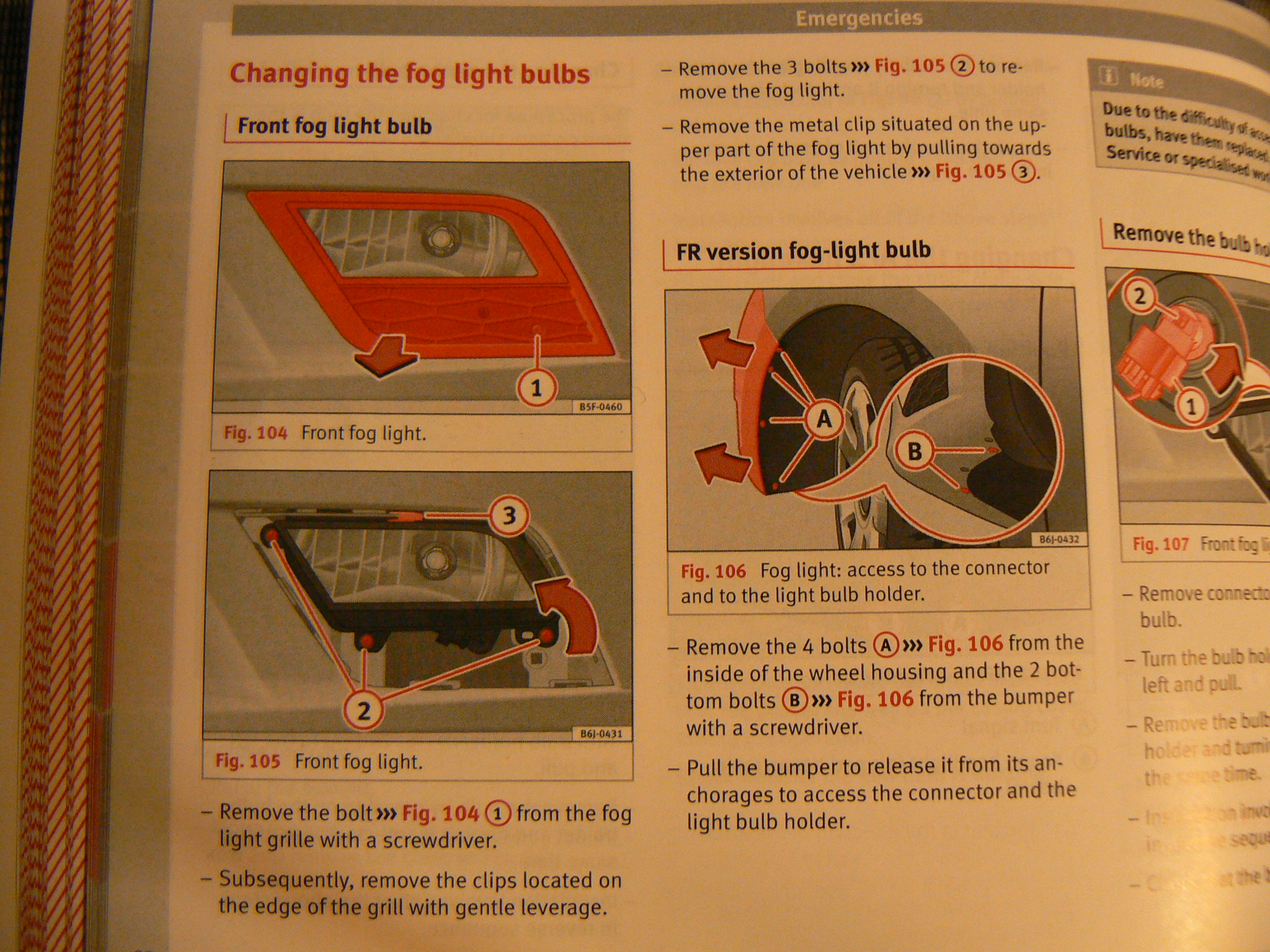

Hi RUM4MO. Just had a look at the fog lamps. There seems to be a wee screw, craftily hiding up a hole, which lets you take off the plastic trim so exposing the lamp fixings which, once undone allows removal of the lamp to access the bulb holder. So still puzzled about this bit of wire. Read the manual cover to cover too and saw no reference to it! Ah well.

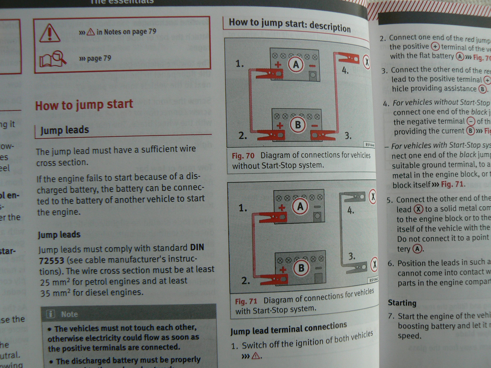

Regarding jump leads. I've gone from being supremely confident in their use, through being "careful" when alternators and basic electronic control units were introduced, to being a "basket case" just thinking about putting them anywhere near a modern car! I'm quite surprised that my 2016 Ibiza owner's manual gives specific instruction on jump starting? It details cars without stop/start should be connected as I've always done it. All ignitions off and cars not touching. Then positive (charged) to positive (discharged) and negative (charged) to engine block (discharged) This was historically to avoid any spark igniting battery gasses and seems to still hold true. If you have stop/start the Positive to positive remains the same but the black lead goes engine block on one to engine block on 'tother. I've been thinking about this and I'll bet it's because this way the battery condition monitoring ecu will be part of the circuit? I believe that if this monitor, which is seeing a partially discharged battery, suddenly sees a battery at full charge there is a risk of it going "phut"! I may have got the detail of this wrong but I know there is an issue around these units. I've spoken to a number of people I know (mechanics) and they all say not to jump one vehicle to another - damage to either vehicle can occur. They do seem to think that a jump from a slave battery or one of these little power packs involve much less risk and they jump from a slave only. Also, and this is something I've done for years, when you connect up the slave let it sit for a few minutes - maybe 5 or so - before trying to turn it over. This allows a surface charge to build up on the plates of the flat battery so it will behave much more like a charged battery. In fact there is a case to be made for allowing the "flat" battery to gain charge in this way and then disconnecting the slave before turning that key. Unless the "flat" battery is very deeply discharged you'll find it will usually kick it into life.
A final wee thought. Before connecting up to the "flat" battery try the headlights. Do they come on reasonably bright? Of course they will not be as bright as usual, but they shouldn't look like candles. If the battery is that discharged I would remove the battery and charge off the vehicle (or with the leads disconnected) When a battery is that "flat" if you succeed in starting the car there is a risk that when you disconnect the slave battery, because the alternator very suddenly sees a large voltage drop it will spike a maximum output which just might damage multiple ECUs on the vehicle and, if connected to another vehicle may damage it too. Of course if you disconnect the battery leads on many modern vehicles you'll loose some saved settings (radio etc) but also on the very newest vehicles the car has to be taught to "speak" to the battery when a new battery is fitted - I don't know, but removing a partially discharged battery and then putting it back in fully charged may require some sort of aligning process to be initiated (out of my depth now) Of course there are "oddities" like my daughter in law's Jazz which must not have the keys anywhere near the ignition when connecting or disconnecting it's battery. It scrambles the key codes and means an expensive visit to the main dealers computer to sort it out. We had to jump it twice last year after my granddaughter found out how to switch on the interior light! I didn't take any chances, making sure the key was well out of the way when connecting my slave and leaving the slave connected for ten minutes after starting for the batterys to more or less equalize voltages before disconnecting.
Here's the page in the manual showing the connections for my Ibiza P1080763.JPG

I'd be very wary about messing with any visible screws near front fog lights, they tend to be for adjustment only, the trims typically need pulled off to reveal the fog light assembly fixing screws, which is why lots of people, including me, tend to approach this from under the wheel arch liners and so avoid cracking/breaking these trims.
It is for concerns about the battery monitoring unit that the requirement is to connect to the body near the battery earth point, there is normally a large flat lug or a domed nut for fixing to.
