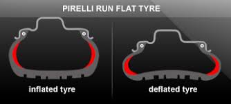

No need to be rude, niggle. The point about so-called run-flats is that they don't go flat - hence their rolling diameter doesn't actually change very much.
Wrong again, genius. The clue is in the name - "run flat". They do go flat but you can run on them. Yet more FUD.
images
images
how-run-flat-tires-work_run-flat-tires-how-run-flat-tires-work-inside-a-run-flat-tire-diagram-of-run-flat-tire_00.jpg
