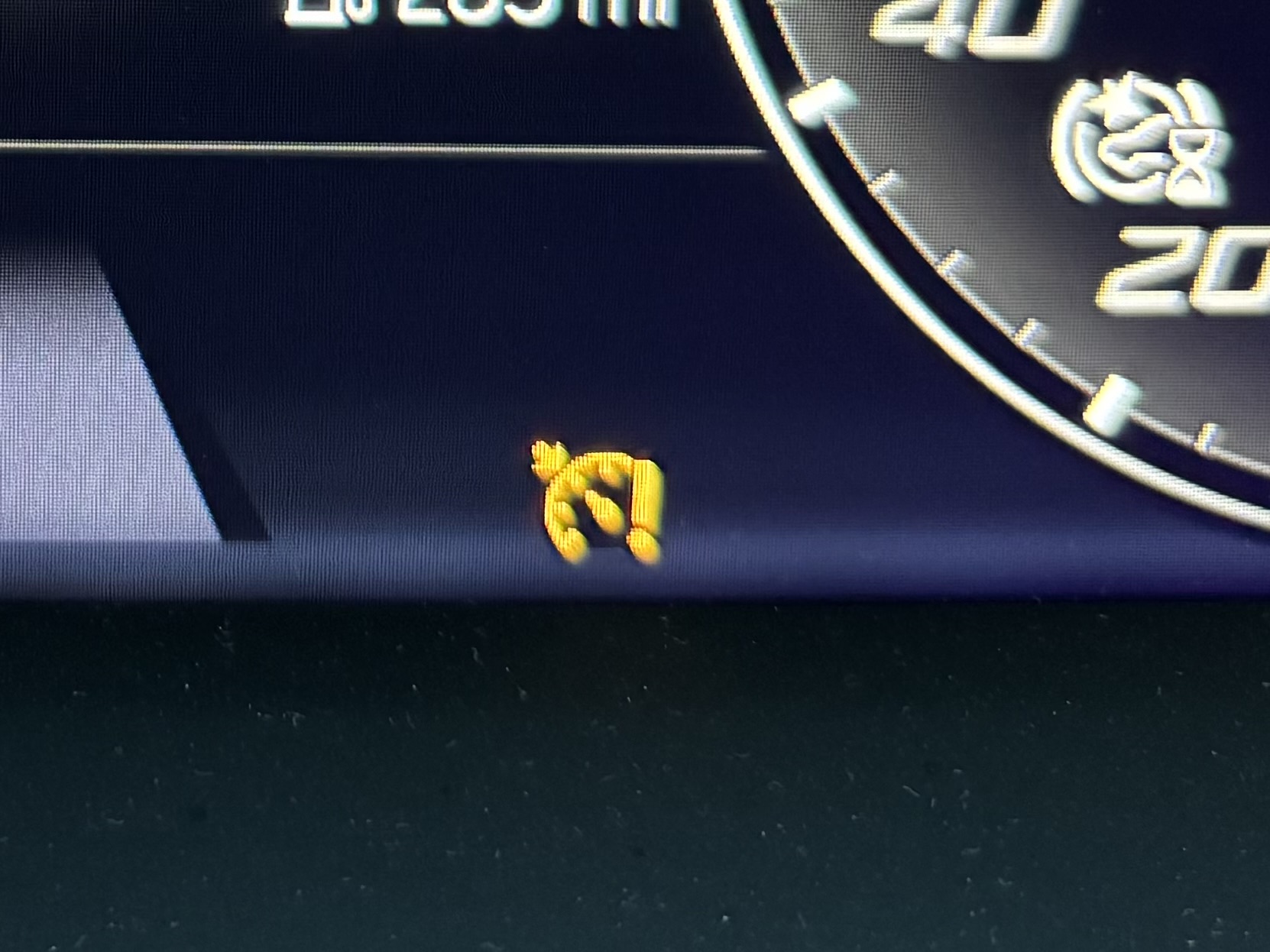

Cruise control unavailable 17 times in four weeks and I was away on holiday for one of those weeks without the car!
This is the problem I have with my fault. I've had it into the dealers several times and, typically, the fault doesn't show up while it's there. They've said that there are no fault codes.
