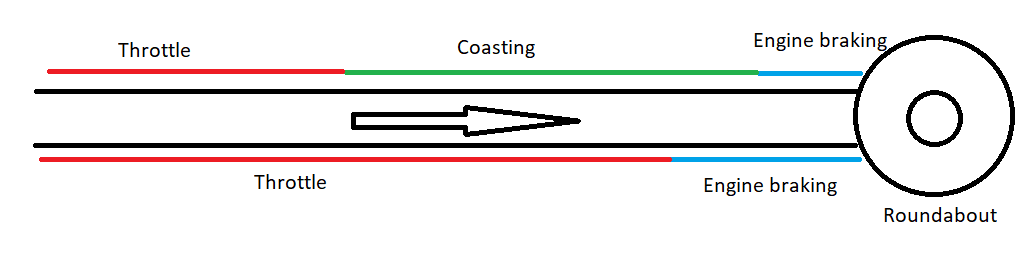

You are absolutely right about the fact that when using engine braking, cars use 0 fuel, but when coasting it uses fuel to keep the engine rotating.
However, If you are coasting, you can release the throttle way earlier than if you use engine braking, because engine braking will slow you down more.
I don't have maths or a real life tests to back me up on that though, but I believe fuel consumption will be less if used correctly. Although it will be also slower (as using engine braking is slower than just braking).
One (not so frequent) case where it's sure to be more efficient though is in small downwards hill. On that note, the ACC automatically uses coasting when it detects that the hill is steep enough to keep the wanted speed, and not too steep so that it needs engine braking.

By coasting are we saying clutch in or neutral gear?
There's no scenario I can see where coasting in neutral for example uses less fuel than being in gear.
This applies always down hill, where you could do it in 3rd or 4th at 30 near 1000rpm, effectively idle speed and minimal engine braking.
Uphill you'll bleed off speed pretty sharpish whatever you do.
On the flat I still don't see any scope to save fuel, the braking effect is not much in higher gears.
