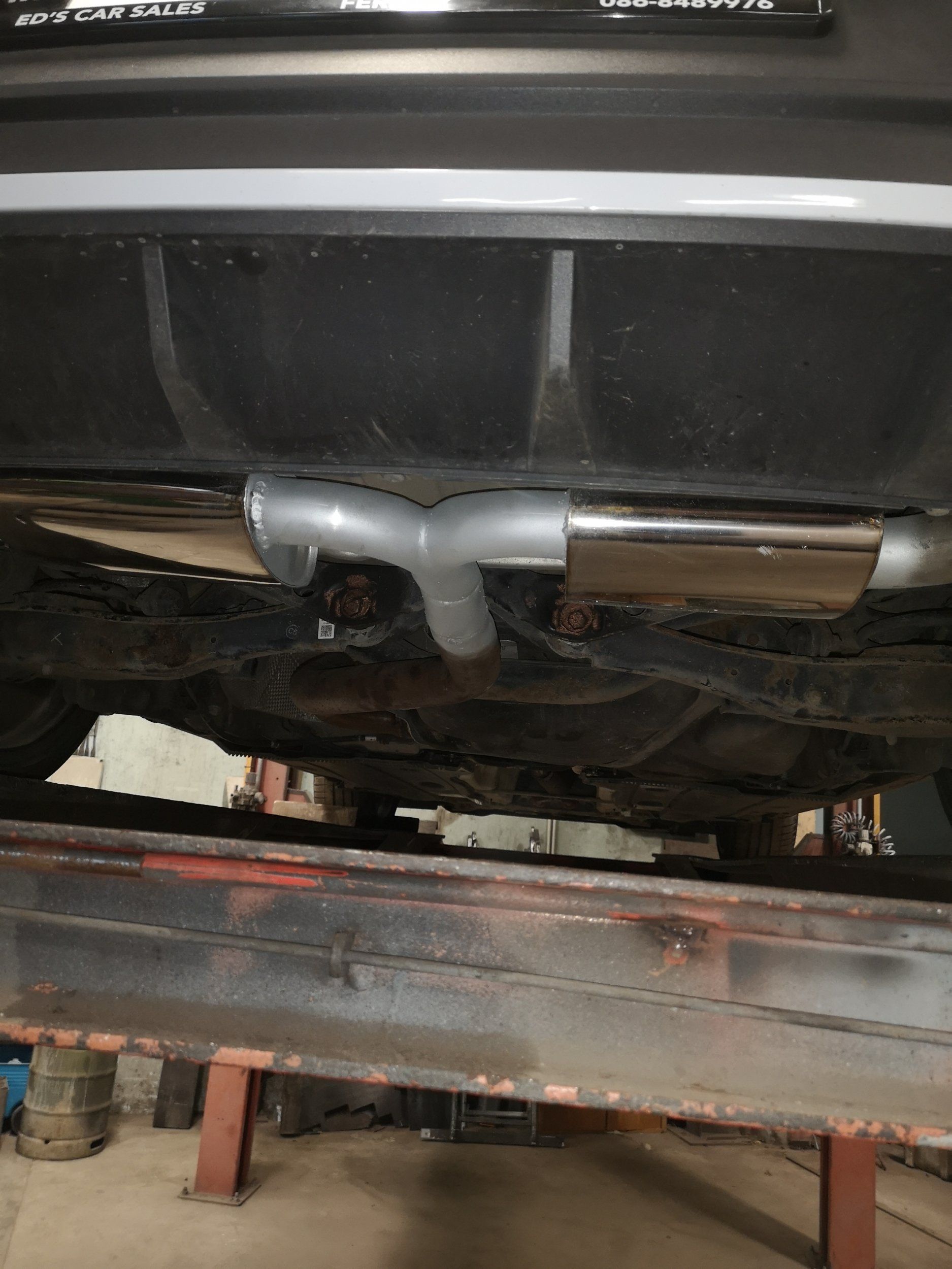

Am thinking of having a mid-box with another resonator put in. I don't think a small rear muffler is going to fit and I'm loathed to ruin the piece of art at the back of the car where the exhaust splits into 2 pipes. The craftmanship, welding and mandrel bending is really really good. I also don't want to create back-pressure and reduce power.
