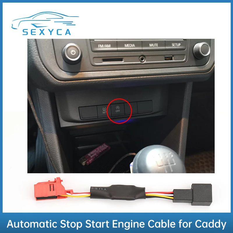

You have a link to the module I think is the best option to do it.
this is an example I got mine about 6 years ago so they dont make that one anymore.
Just do a search on ebay, amazon, temu, aliexpress etc for stop start memory module.
