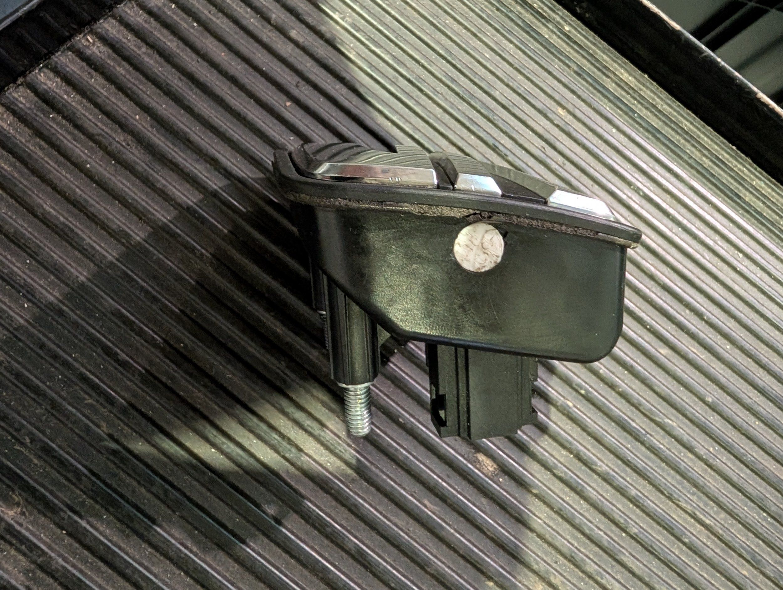

This only solves the problem for a short time. The shaft rubs the edge of the mount. I now have a 2-part shaft that is firmly attached to the housing. Now the logo rotates on the shaft and it no longer rubs.

Maybe I should use oil and get it in place. maybe the shaft has moved and is not in place. it seems a little strange to me.

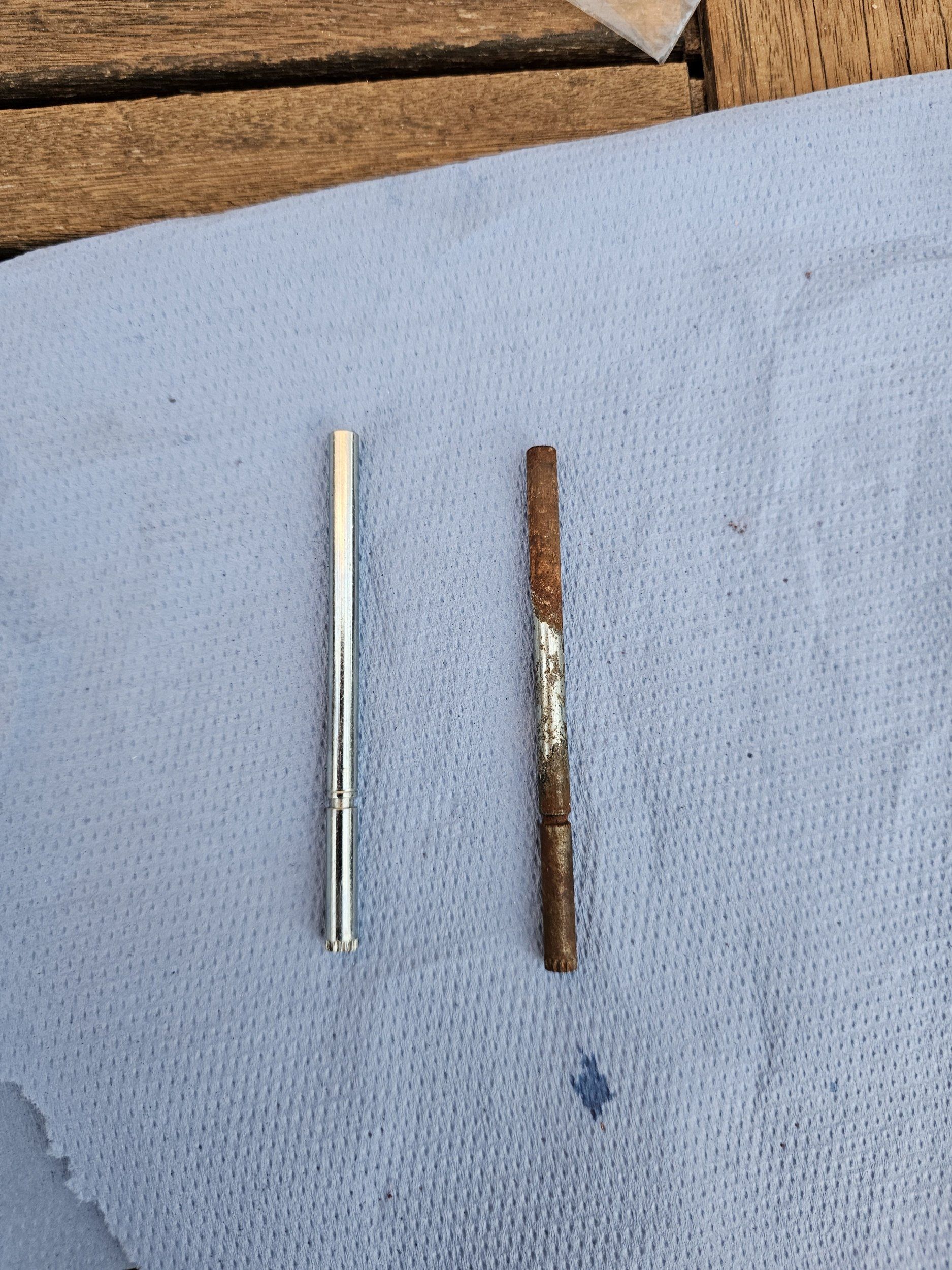

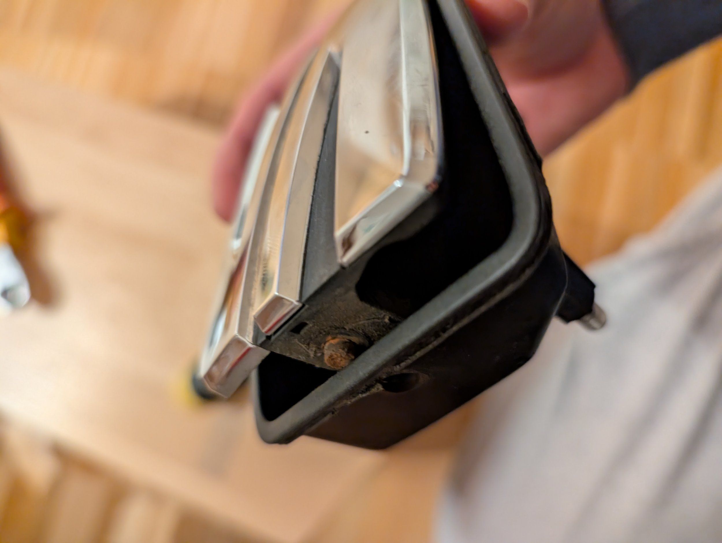

I have now repaired 10 of them, and the spring has never been the problem. The shaft is always full of rust and the housing is worn out
